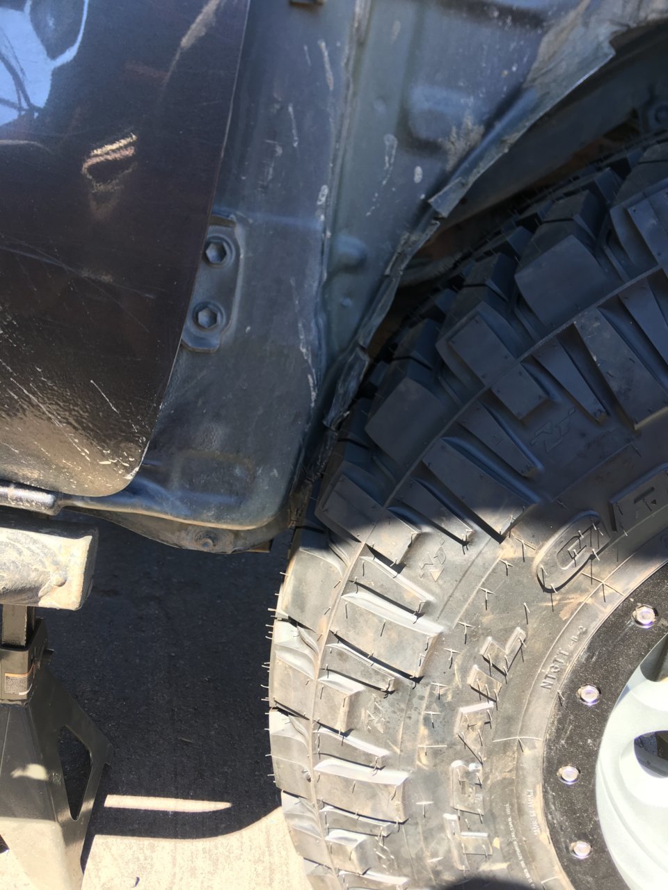

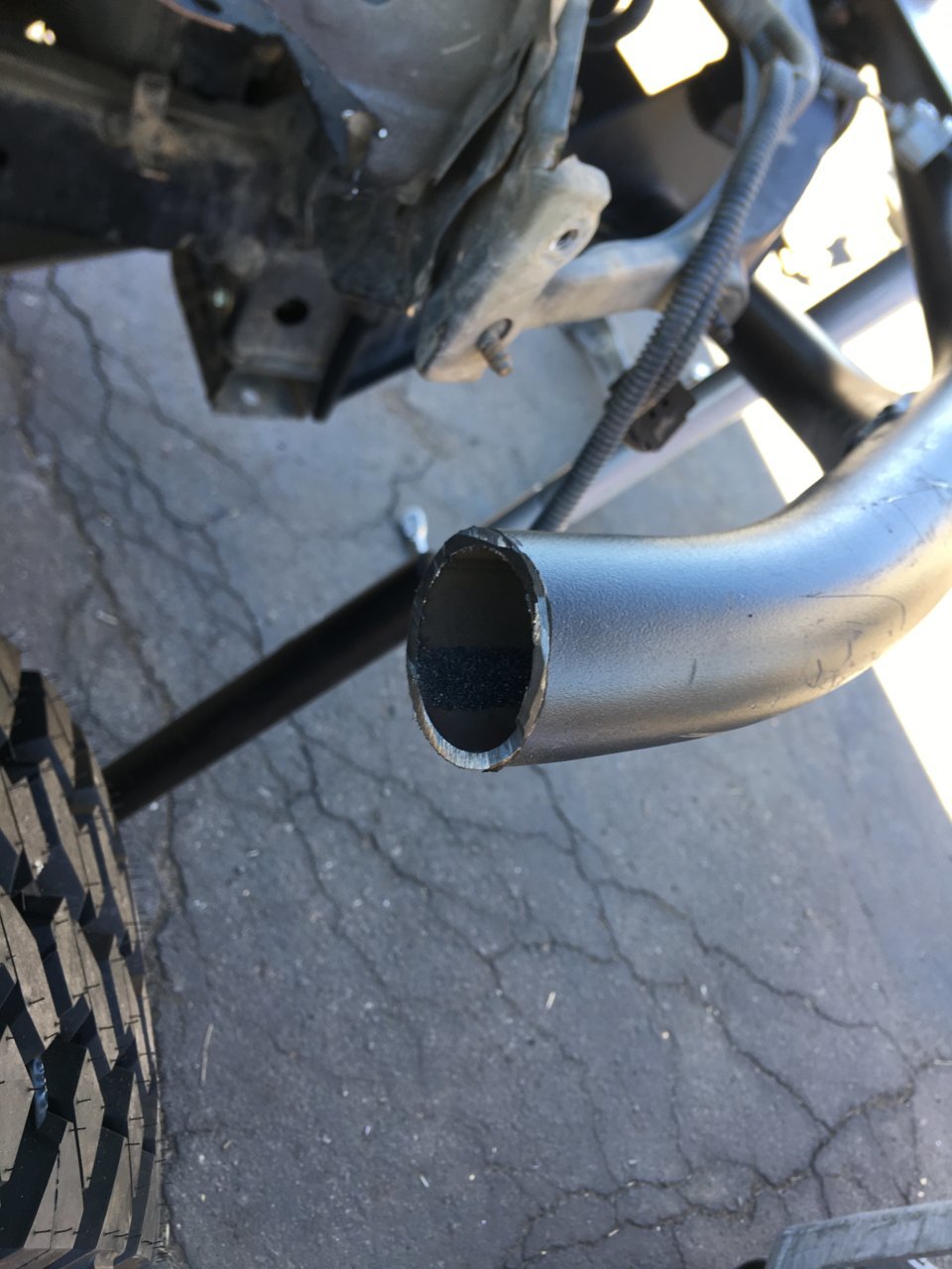

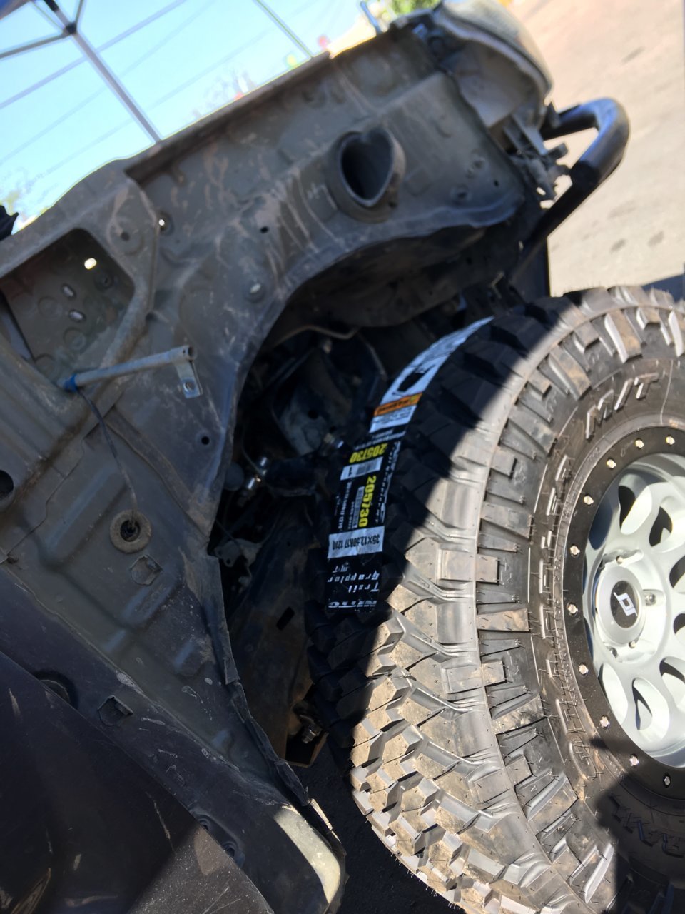

    A couple more.
    Before I started cutting
    DE9C3221-7370-45C5-9885-A19BE2E515DA.jpg EE29D6AE-0EE9-4D2A-9646-0DAFB74C5B3D.jpg
    Had to take some tube off the bumper since I was hitting when turning.

    2,514
    Andy
    Socal
    Doing 35s right. :thumbsup:
    Don't skimp on the cutting. I chopped out around 1.25inches for 37s and still rub a small amount at the fire wall on hard dynamic compression. I should have cut 1.75inches.

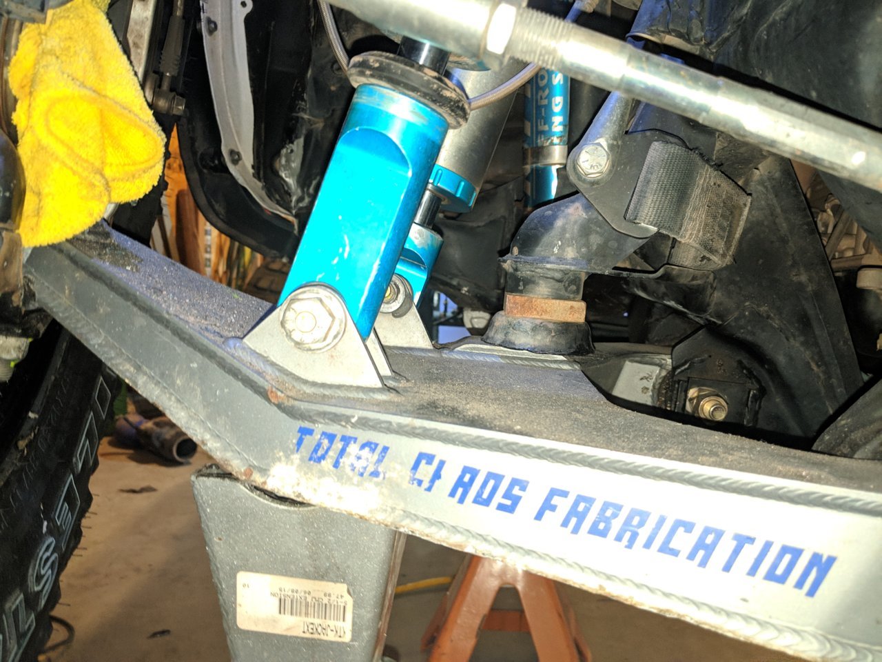

    Andy
    Socal
    Yeah, 37s with stock width arms requires chopping out almost the entire wheel well.
    I had an extra 1/4-3/8" space at the firewall with the coil removed and arms jacked up to my theoretical max bump height and it looked like I was good. If I was to do it again I would give myself an extra 1/2-5/8" space.

    Is that a wood block under the bump?
    Drainbung likes this.
