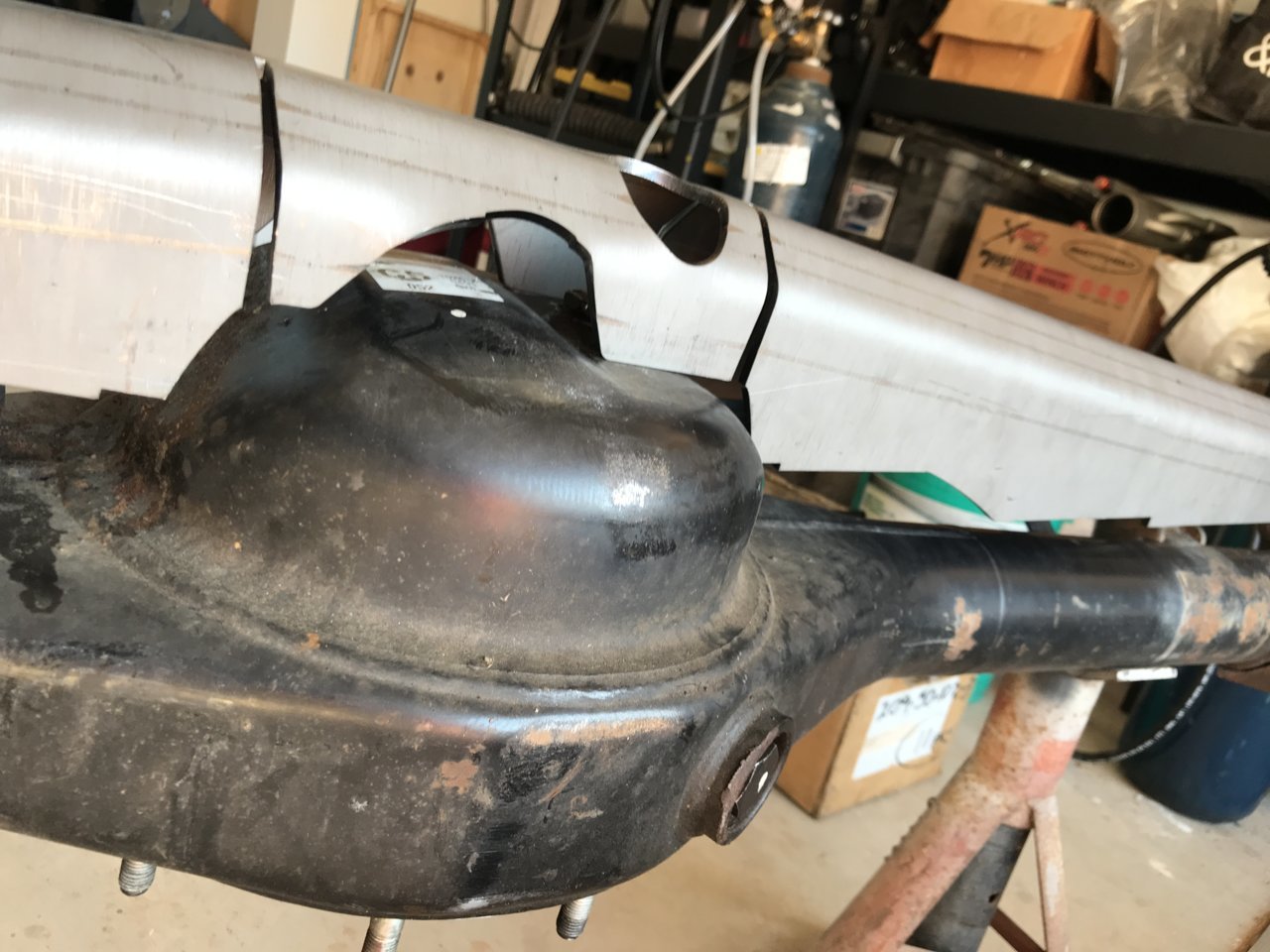

    Referencing for later. Received my Ruff Stuff Toyota Mini Axle truss yesterday. Going to be A LOT more modification than I had originally anticipated but I should be able to make it work.
    Curious to see the Dirt Designs truss kit as well. I've heard they exist but never seen one installed.

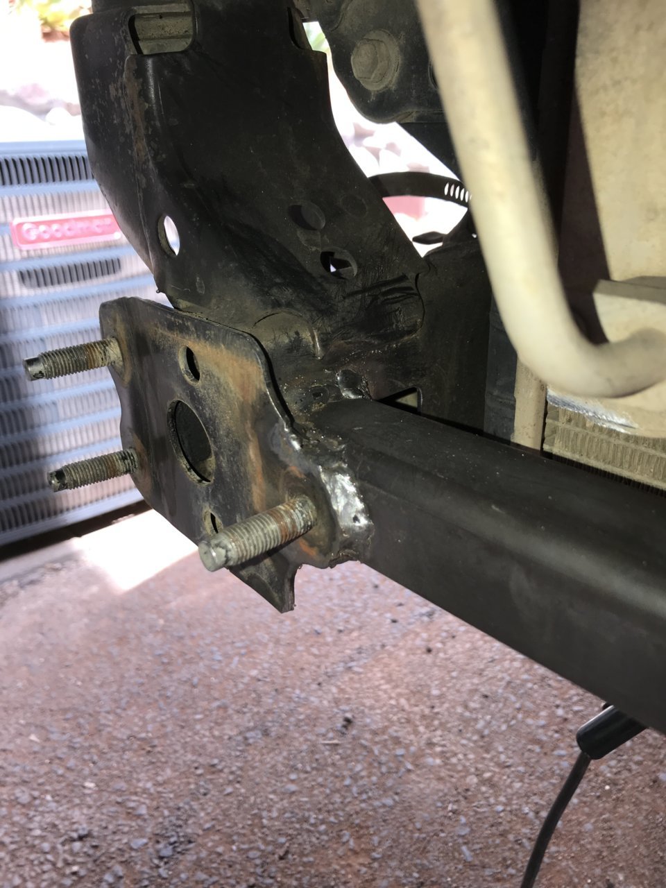

    Also, what is this?

  11. Apr 12, 2021 at 8:38 AM

    3/8" bash guard, you can also get that from ruff-stuff

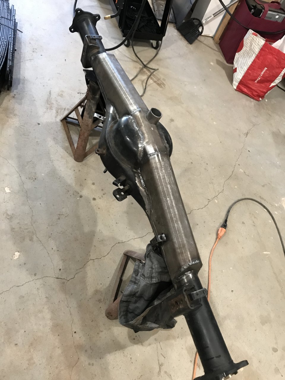

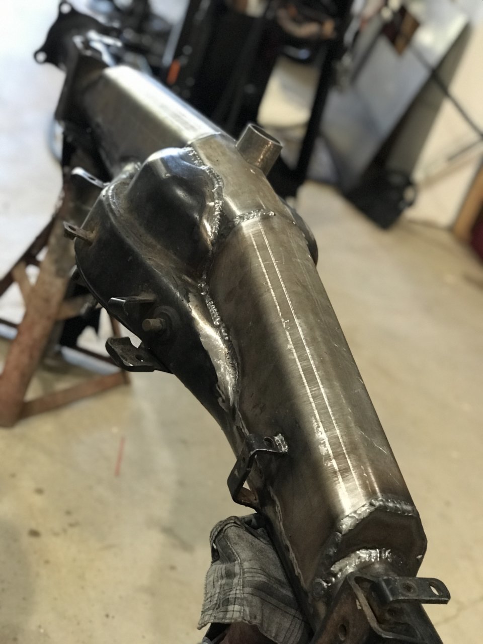

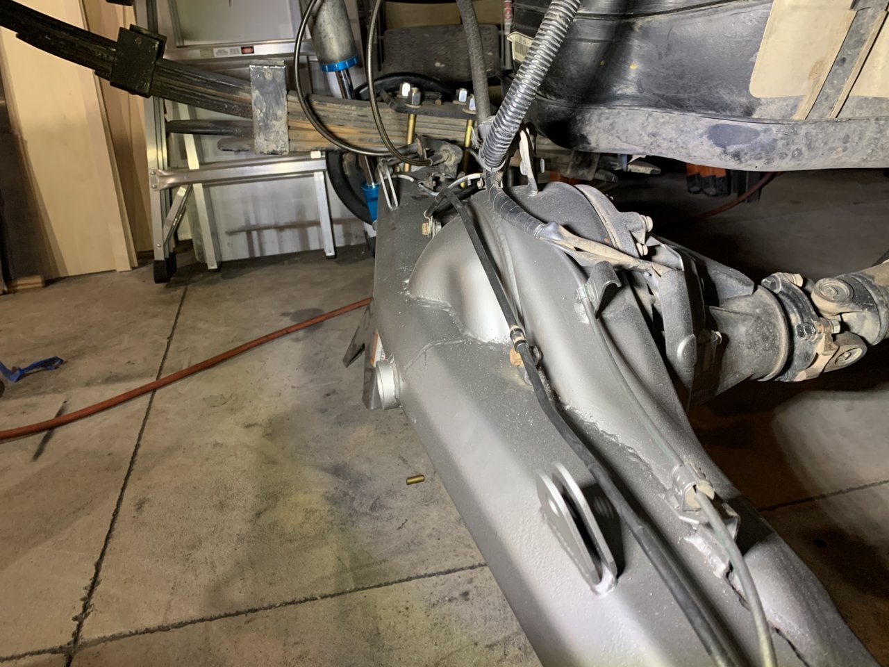

    Made some progress this weekend and got the rear axle welded up. Took the rear brakes apart and got the old axle out. Next is stripping the leafs and installing the trussed axle for cycling.

    eccracer104, d.shaw, LukeCC and 9 others like this.

    Awesome job on the axle Truss!

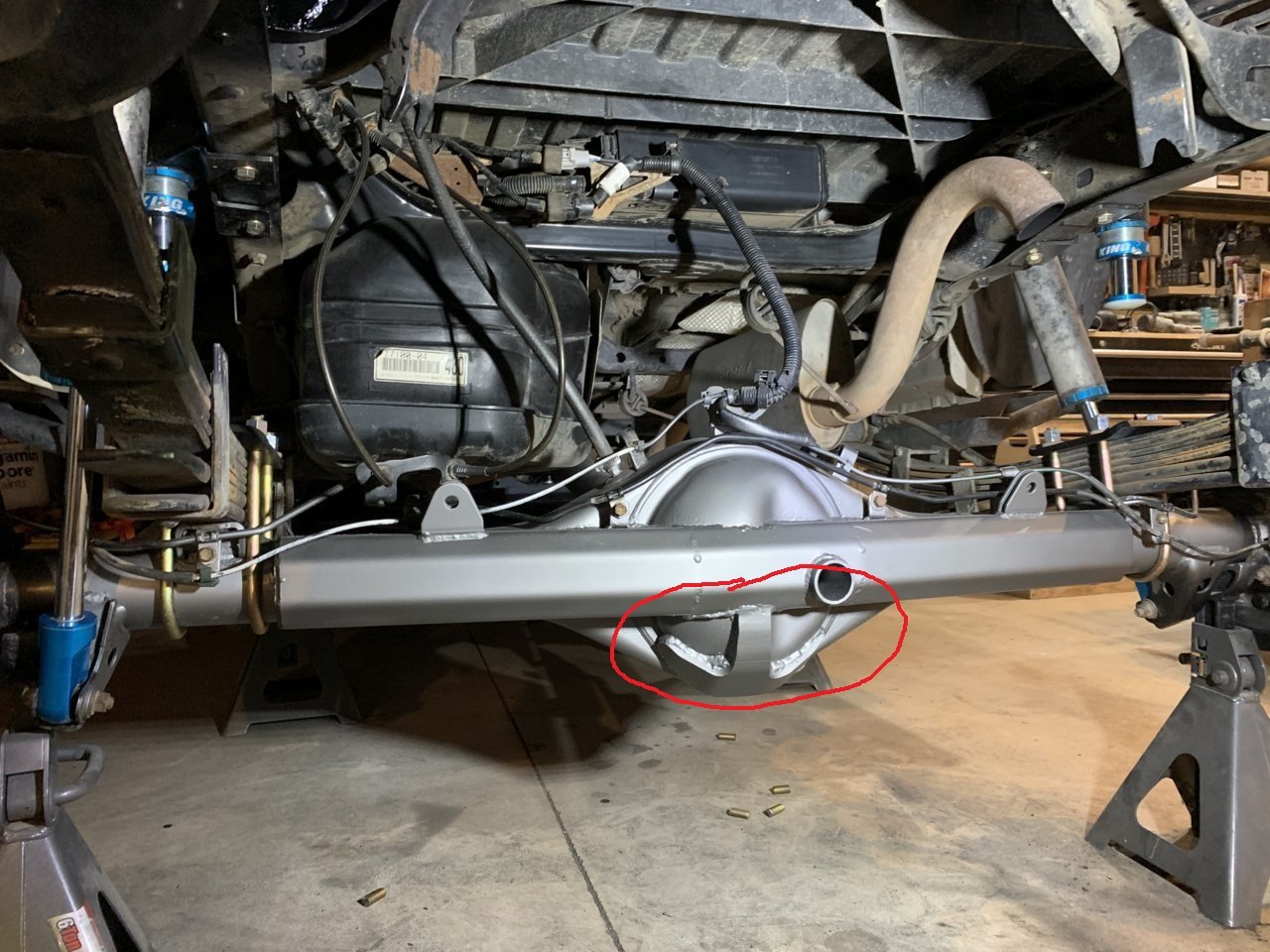

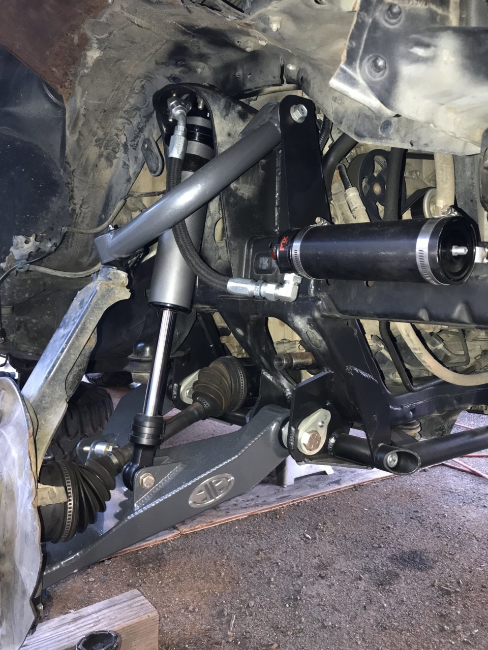

    Making progress. Little by little...
    [​IMG][​IMG]

    Got any close up photos of the lower ball joint? I'm trying to figure out which emf uniball they use and the mods they do to the spindle adapter to make it work. Looks like they weld spacers to the adapter but not sure if they drill out the spindle adapter for a larger main mounting fastener.
