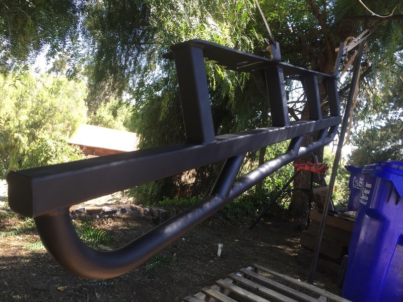

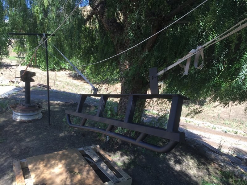

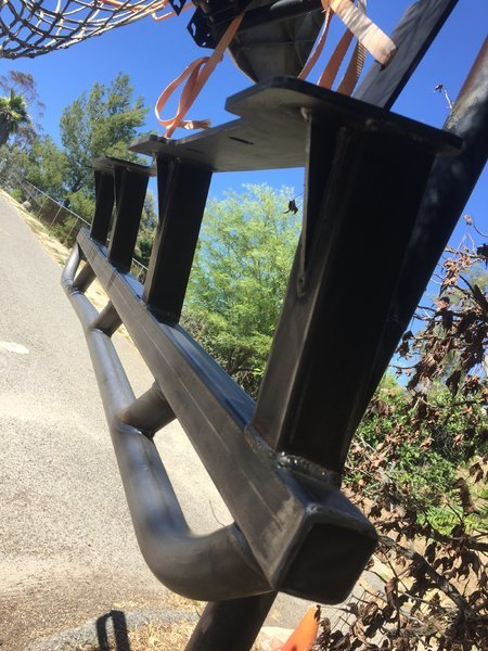

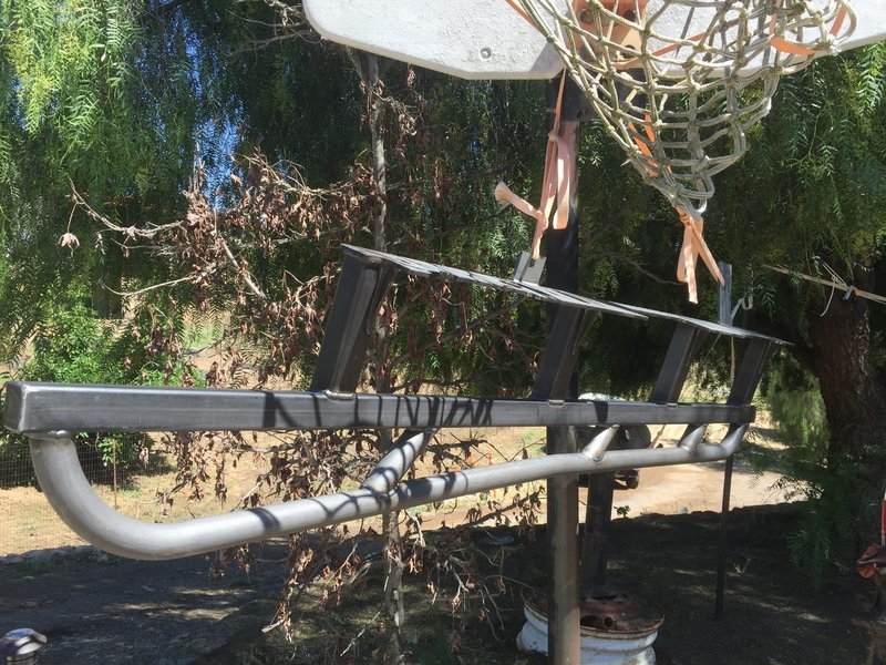

    Well it's been awhile since i've made a progress post so here are some of the most recent actions made.
    Picked up my @Pelfreybilt bolt on sliders and worked on the install a few weeks ago. I bought them bare as I expect them to get all scratched up and I could just make some touch up spots to them instead. I used a base primer and then hit 2 layers of Dupli-Color Truck Bed Coating for the finish.

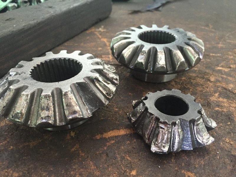

    Fast forward a few weeks and I'm awaiting the arrival of my third member. I ran the numbers from pretty much every angle possible and decided to hit the "f it" button and get a third member from East Coast Gear Supply. Huge shoutout to Kurtis, Chase and John from @ECGS as they were all great to work with and very helpful and patient through this process. They understood the situation and helped me through all my worries to make the best decision.
    I made lots of calls and different approaches from friends in the industry and local shops. ECGS beat them all and still offered the best route for me to go! I decided to just make the move to 4:56s with an ARB locker as that is what I wanted to do in the future anyway. I realize I will need to re-gear the front, but at least I wont be double spending in the long run. They are also sending me a CKMA12 high output compressor so I can do the entire instal and be able to air up my tires. With 4:56s I'm expecting to need to make the jump to 33"s soon but I need to get the truck back on the road first.
