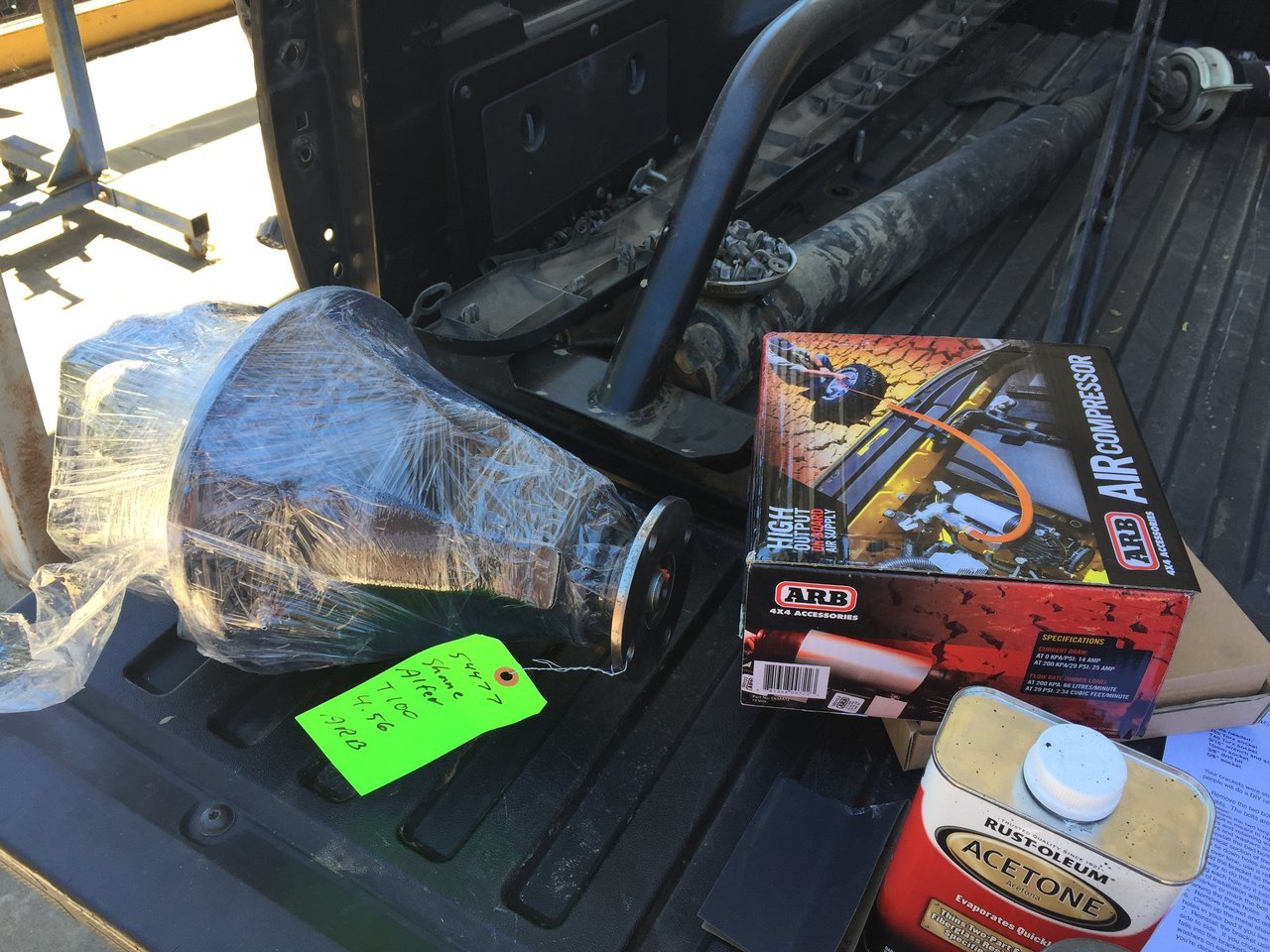

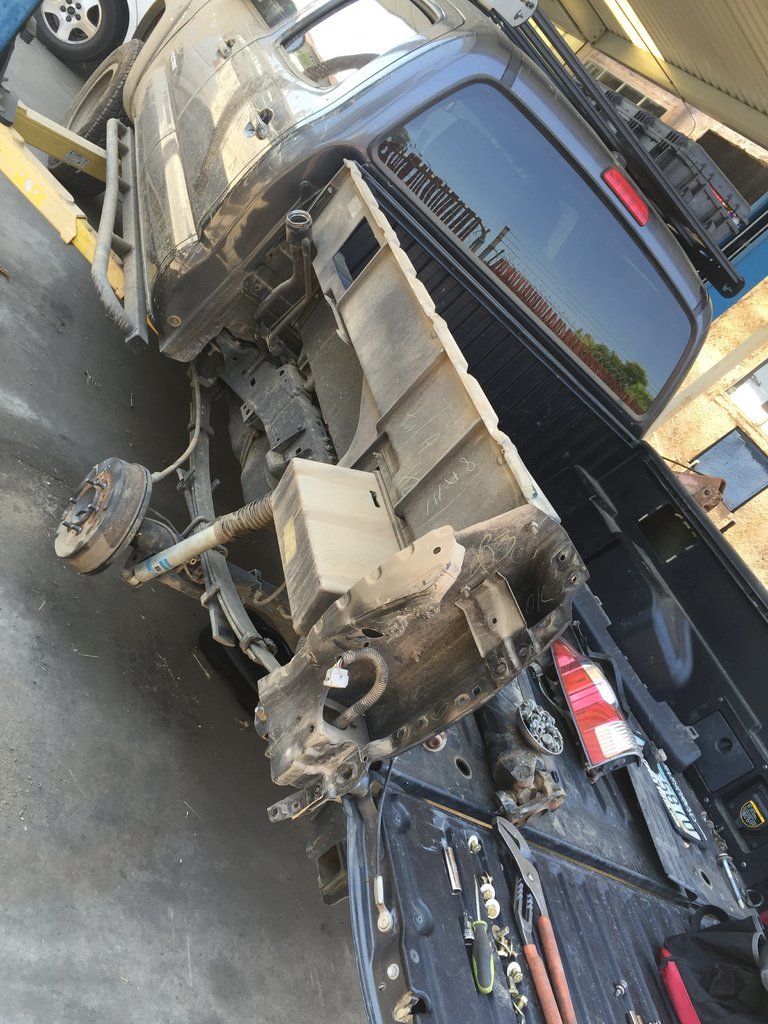

    Well, I have got a second now to update the thread and post some repair pics. Truck is now back on the road. The compressor is still not mounted as I just received my Slee Off Road compressor mount yesterday. ARB is plumbed and should be hooked up to the compressor this weekend if my plans come together.

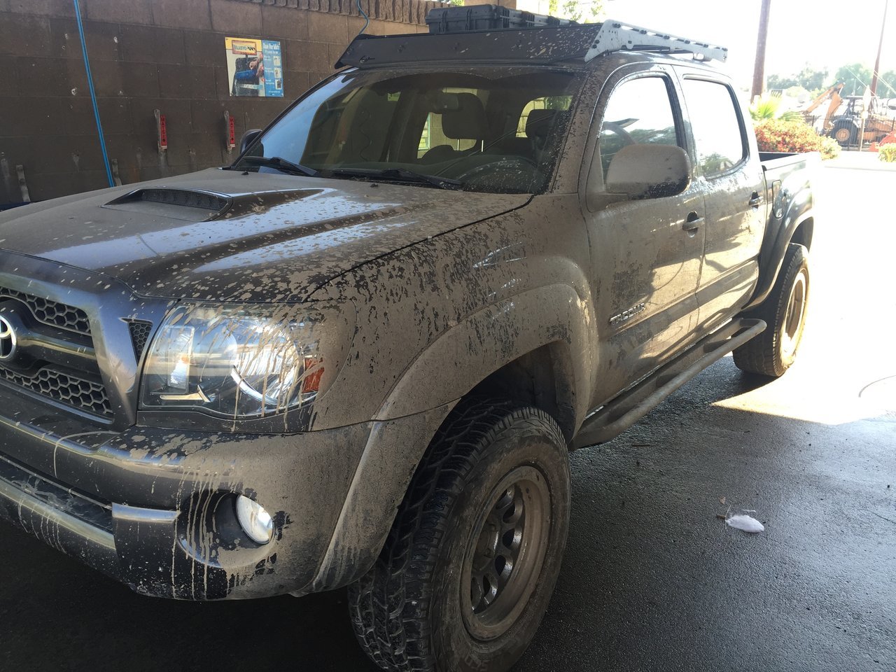

    First thing I did when it was drivable was run to the local pressure washer to get ride of the mud from the trip!

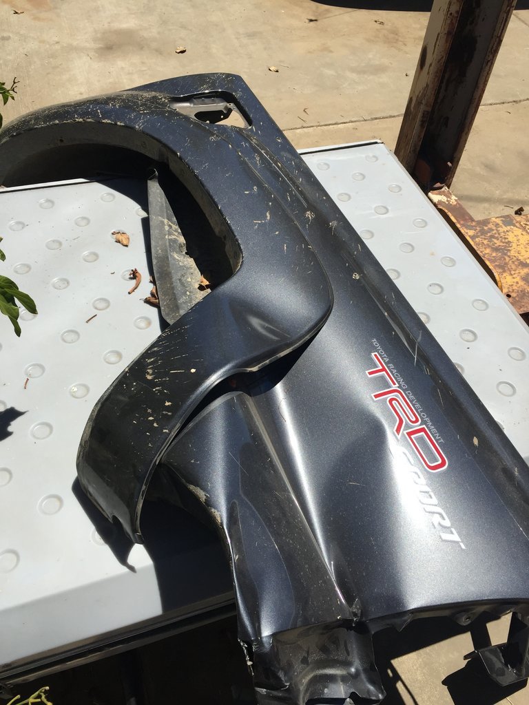

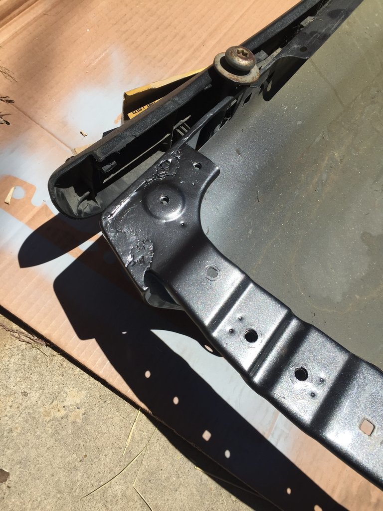

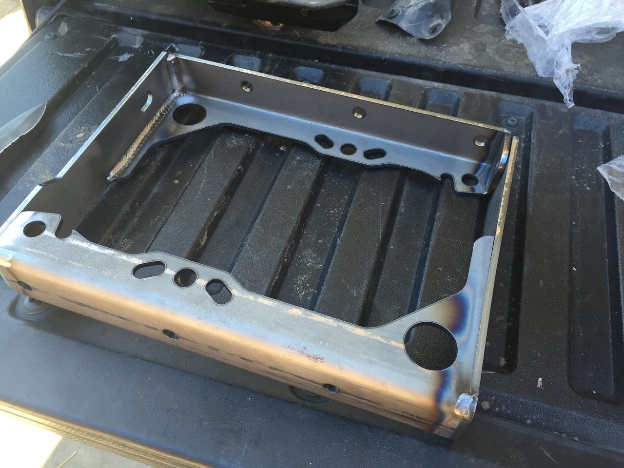

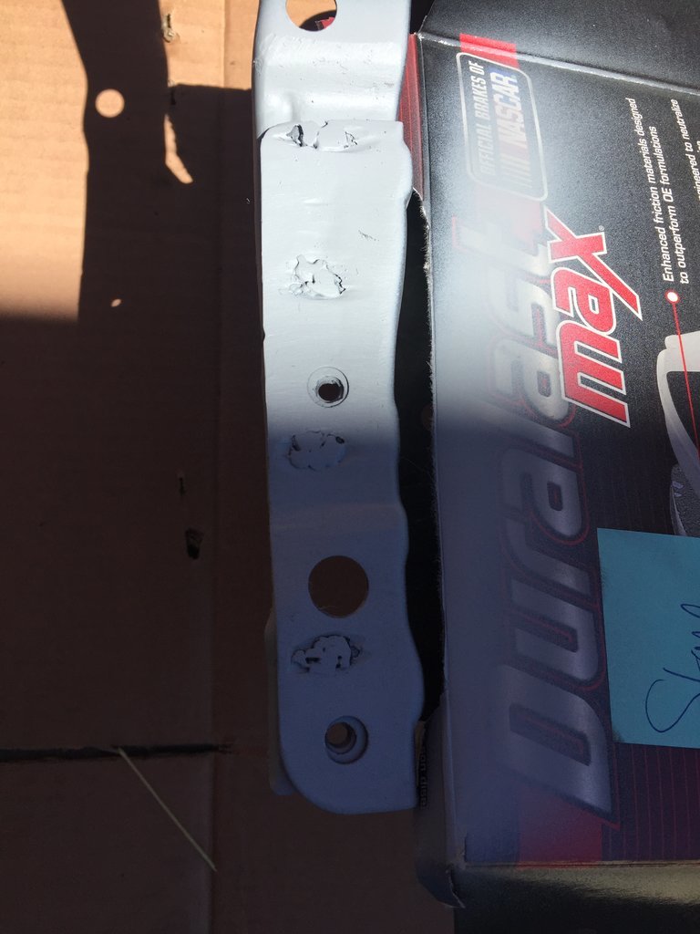

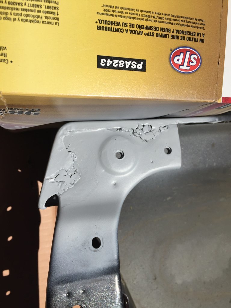

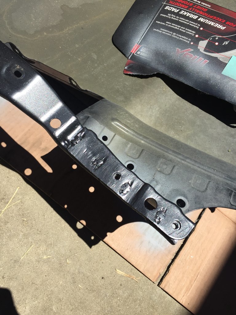

    The bed work took some time as the previous owner had taken the support bracket that retains the rear tail light off to use for some fiberglass fenders. I took this bracket off of the damaged bed side and welded it back together. As I've previously stated, Im not a welder by trade. I have the ability at times depending on the Earth's rotation to get what I need done. The spot welds were a little tricky to remove for the bracket without too much damage and I had trouble finding a solid ground on painted sheet metal. most of the work is hidden but it came out looking okay.
    I used an aerosol paint match that came out looking pretty clean. I think it was a Duplicolor product, but they actually match the manufacturer paint in a can. Primed, painted, and clear coating took a few hours after the welding but overall I'm happy.
    Huge thanks to @itaro for reaching out with a good bedside that matches the truck. It's a small community and this worked out by pure coincidence. He just so happened to have an short bed MGM driver's side laying around.

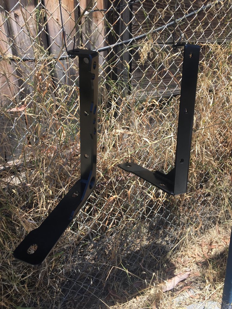

    Lastly, I got my bed support brackets from @At The Helm all painted up. These things are a solid product and will look great installed. I ran out of time/energy when doing the bedside work to drill into the bed for the install, so these are yet another project I'm hoping to do this weekend.

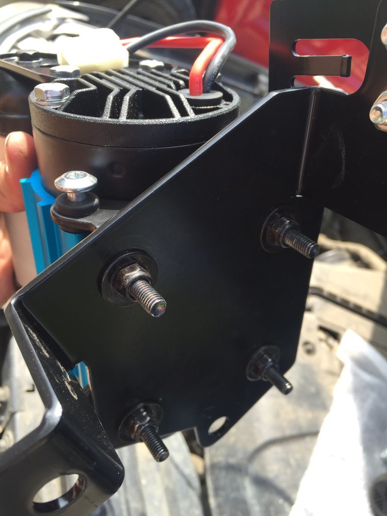

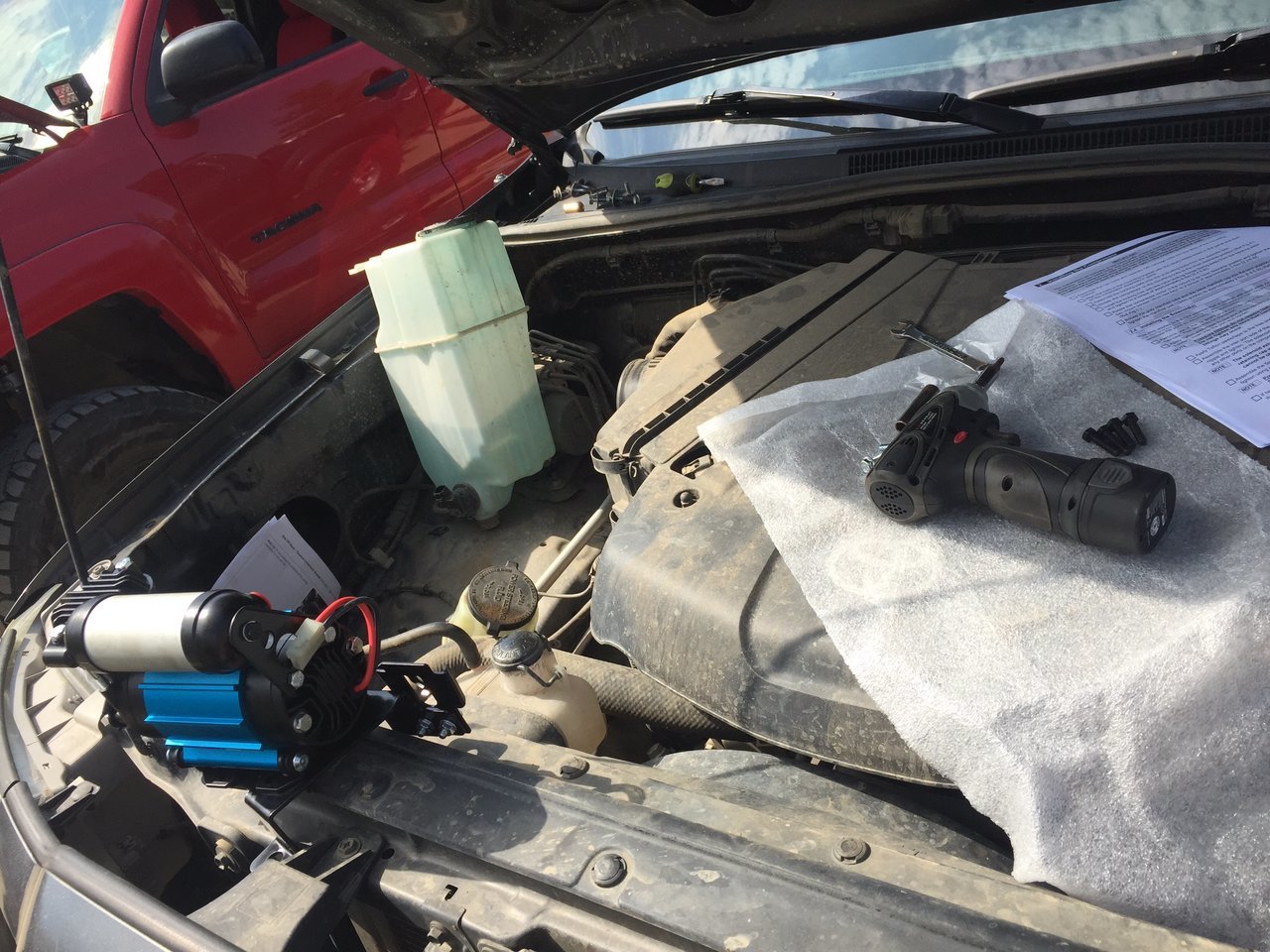

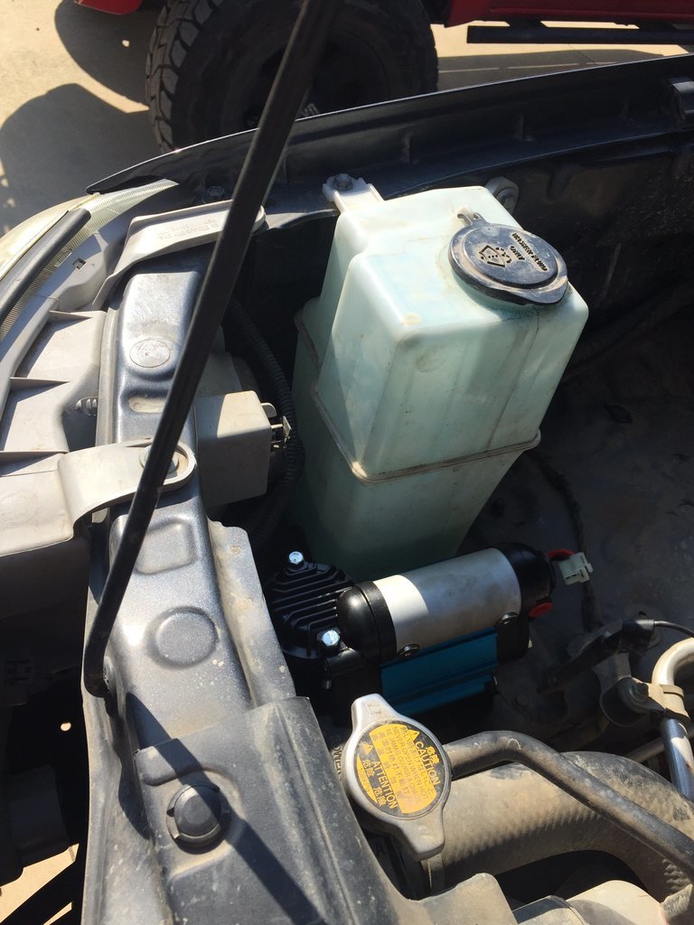

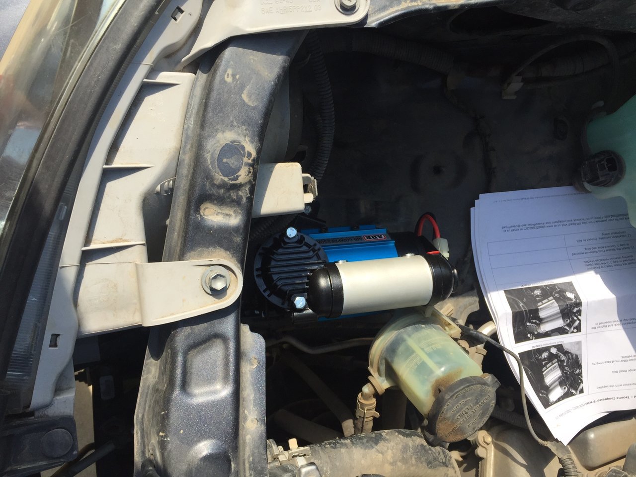

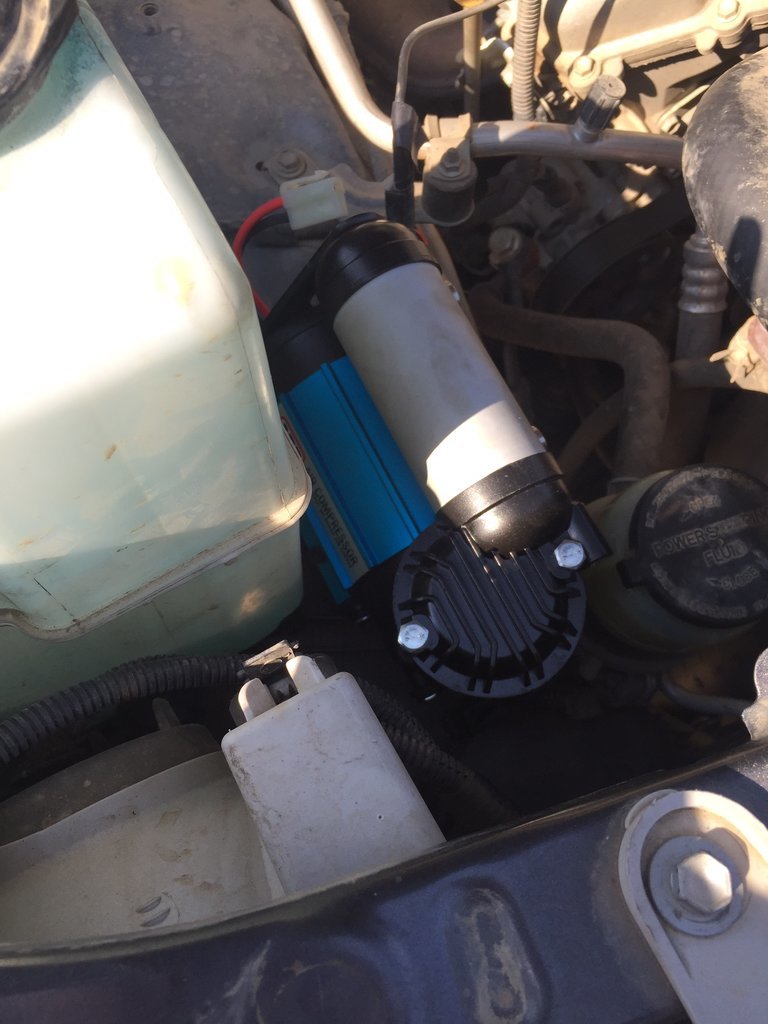

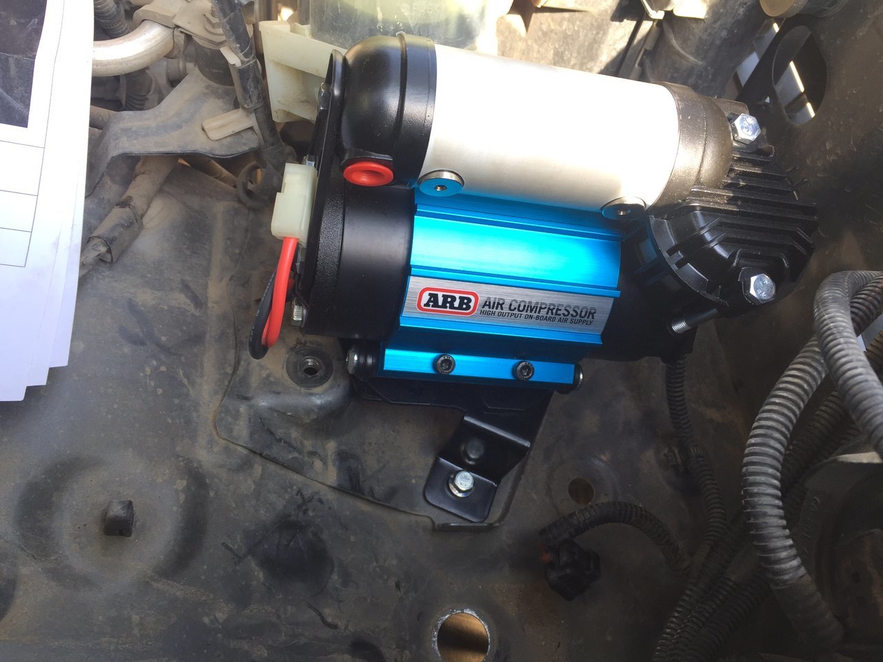

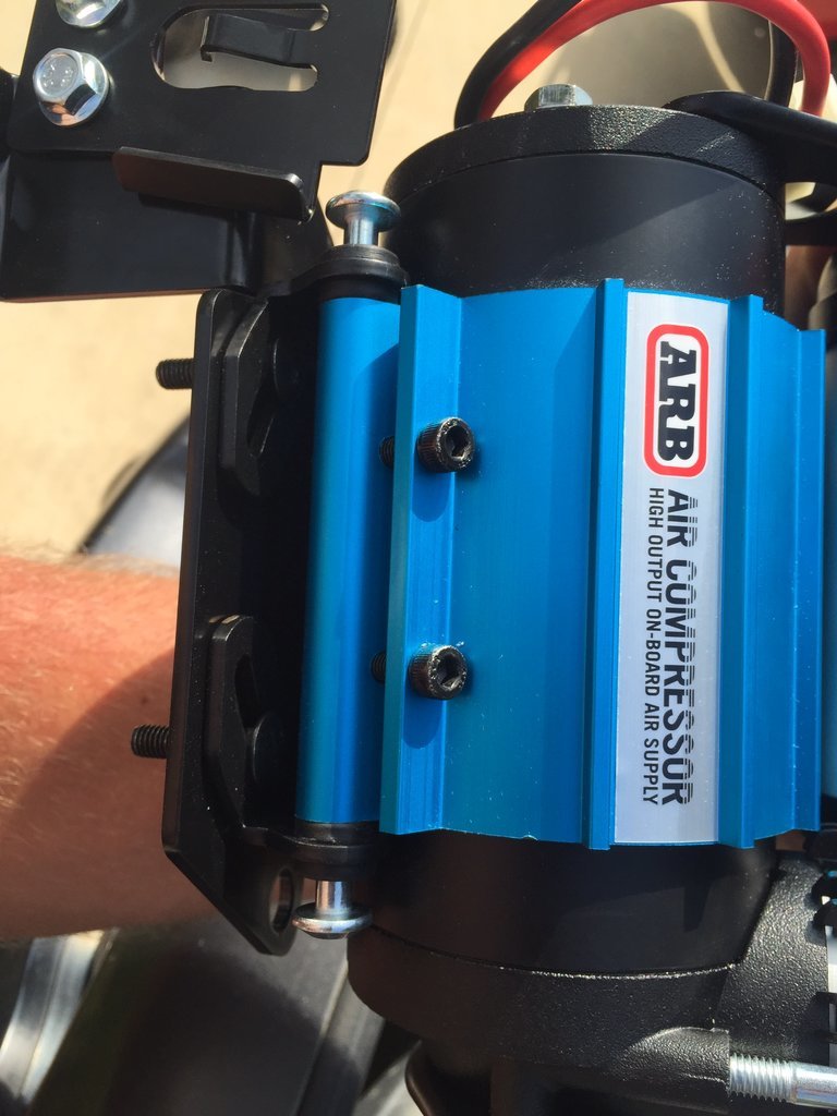

    Completed my ARB compressor install but still need to finish up the wiring. I used the Slee Off Road mount that relocates the power steering reservoir. Install wasn't too bad and I took a little extra time to route the wiring. I will need to add a few feet to the positive/negative wires to run them to the battery as I ran the harness along the firewall and it took a little extra length. I'd rather keep it clean looking though.
    I loosened up the 10mm bolt at the end of the manifold and rotated it 90 degrees to clear the locker solenoid and adapt the T-fitting for an air line. Went and bought the ARB Tire inflation kit (171302) that comes with the T-fitting, quick disconnect, and hose/fittings. Although the compressor is capable of airing tires up, the accessories to do so are not included in the kit.

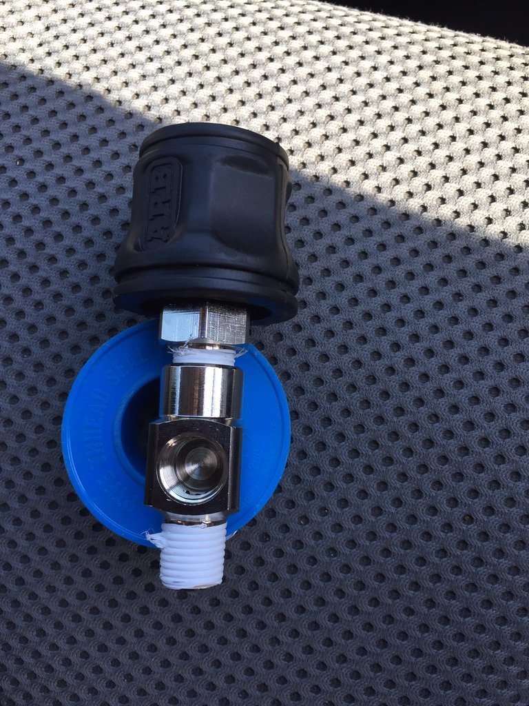

    Pic of the T-fitting and quick disconnect for the air line that came with the inflation kit. I looked into piecing the kit together but by the time all of the fittings and air hose were pieced together I would have saved only a few dollars. Additionally the T-fitting I found was much larger in size and the air line connector in the kit is pretty nice!
