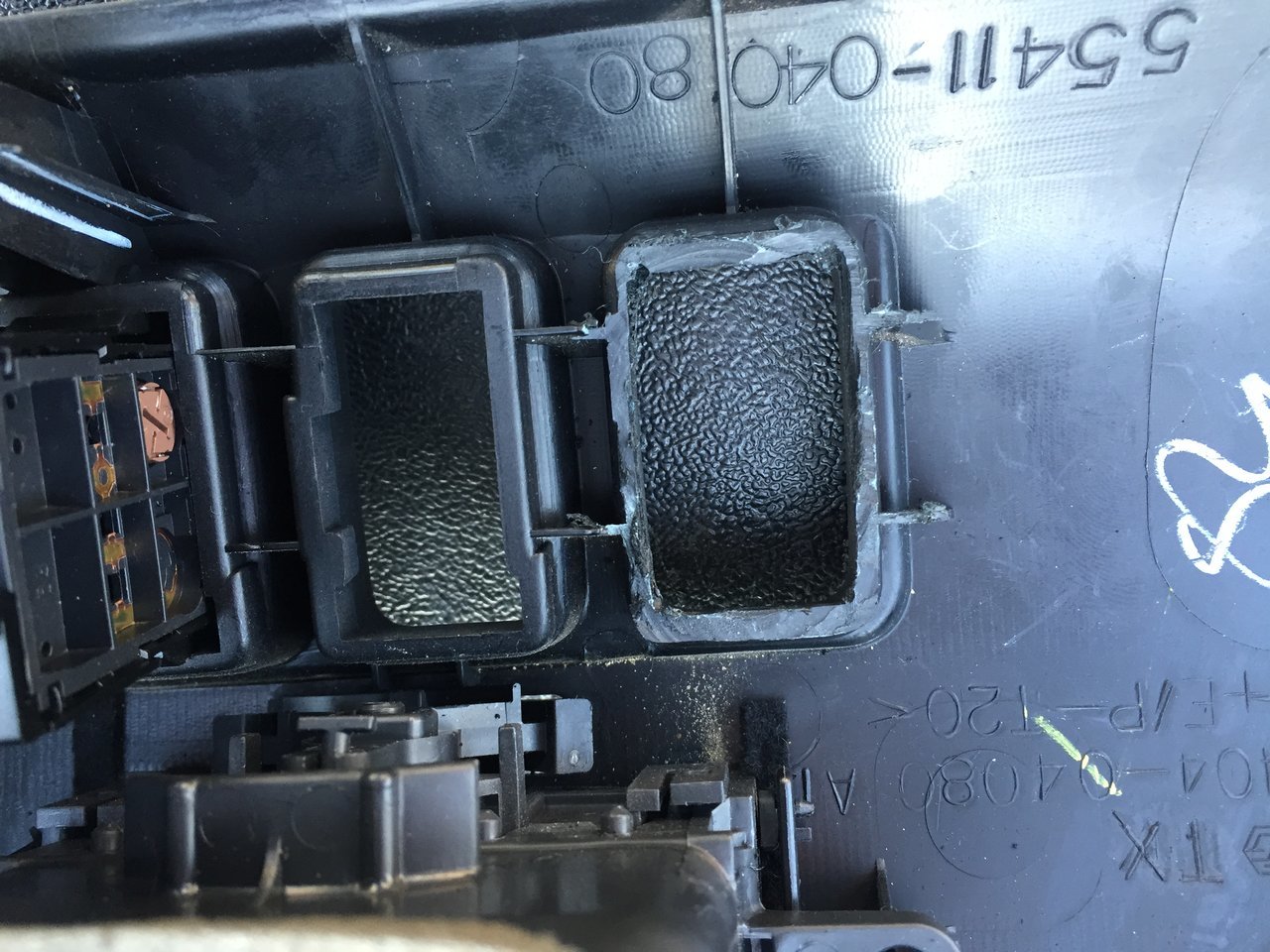

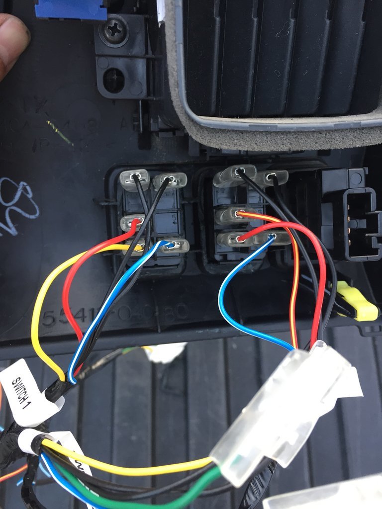

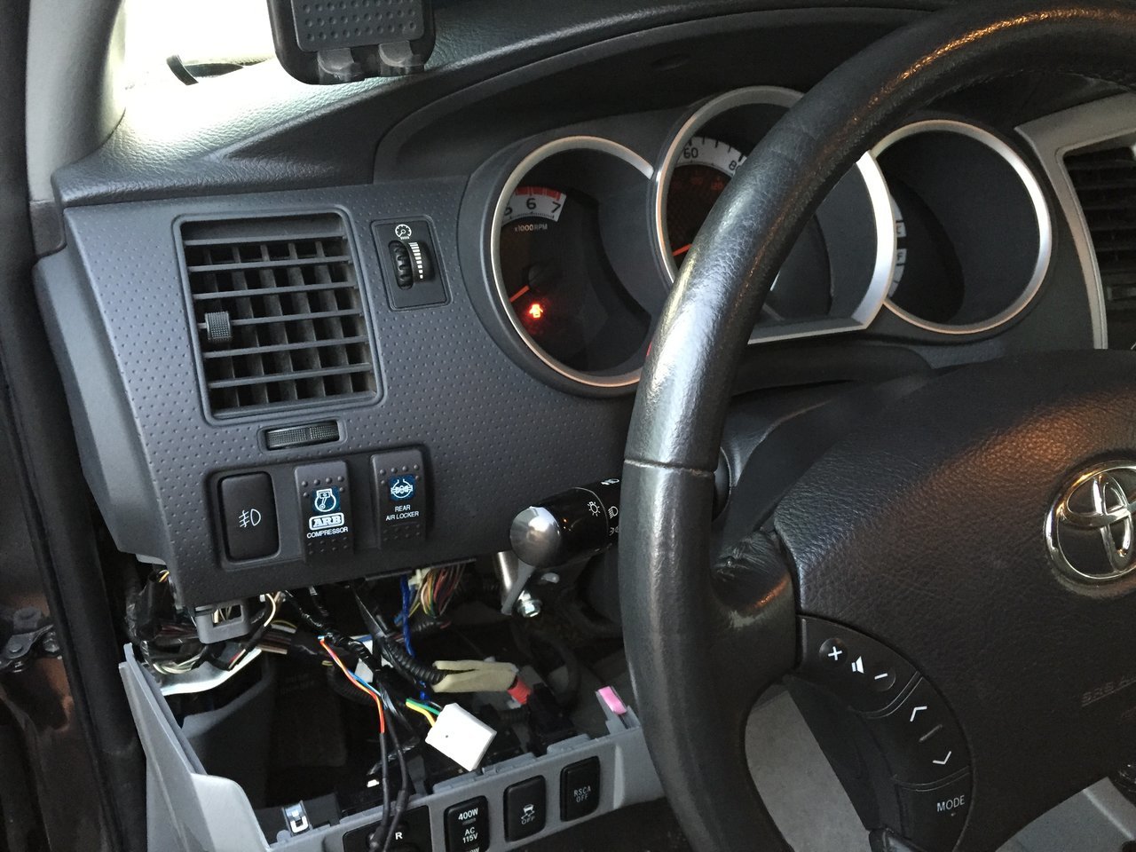

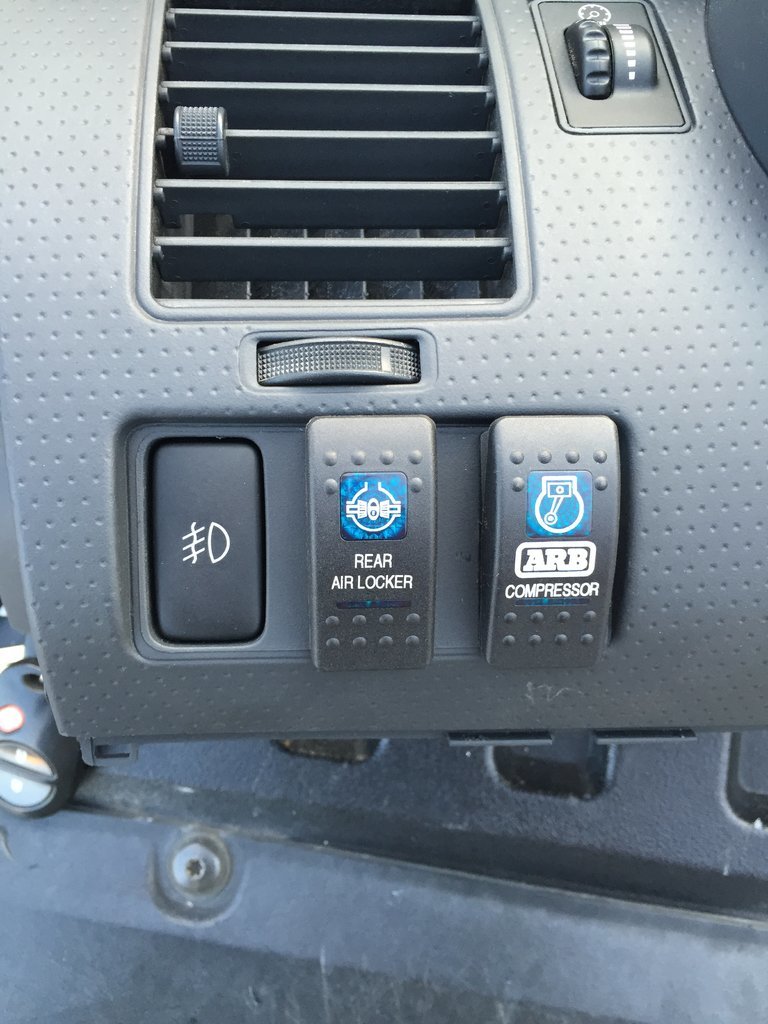

    I finally got my hands on a dremel and was able to install the compressor switches into the factory blanks and run the wiring through the firewall. Pics of the tear down and work as always. I wanted to keep the look as clean as possilble and not have to mess with the pre assembled ARB harness. I will be running all other accessories from a switch panel in the sunglass holder and through a fuse box, however ARB does a great job with their harness and I didn't want to extend any wires.

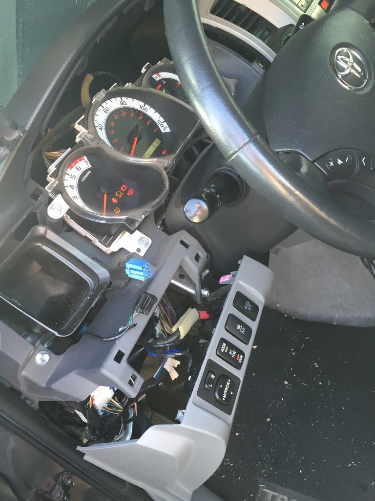

    I relocated my bed power switch down to a blank and installed the ARB switches into the blanks on the dash panel. In order to do the dremel work, I removed the dash panel as shown below.
    The factory makes these "tabs" that only allow you to install the original intended switches. On top of this, the ARB 6 pin is much larger than the given slot so I removed some of the material on the side. The switch is snug, but does not click into place.

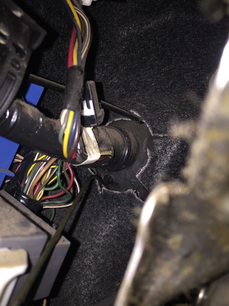

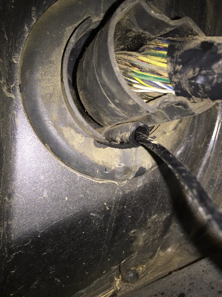

    With the switches in place, I wired the harness up and ran the wires through the firewall.

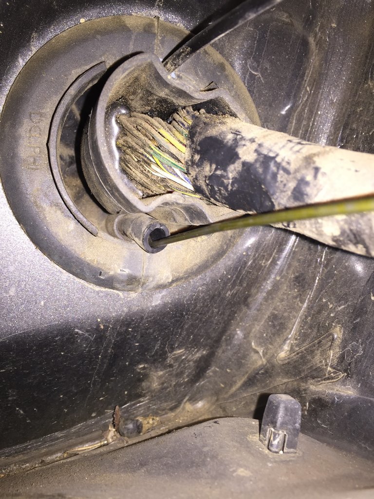

    After closely inspecting the grommet that all of the interior dash wires run through the firewall, I noticed a small hole that unused and plugged via the rubber grommet on the engine bay side. I cut the end of the plug off and had open light through the firewall.

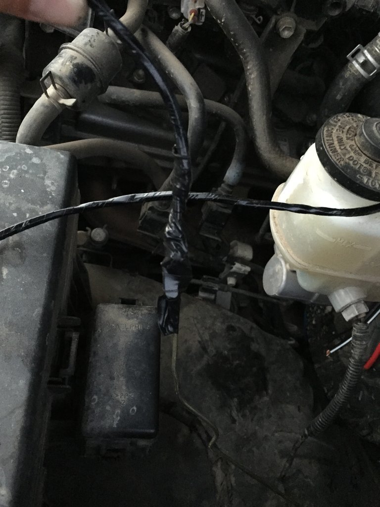

    I used a wire hanger tapped to the wires to run the wire. (Engine bay view)
    Interior view
    Wires through the grommet
