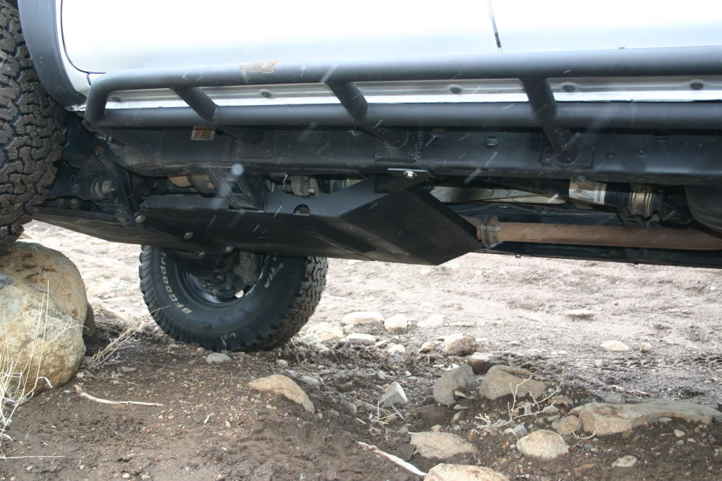

    All the ifs skids are pretty similar. Decide on 3/16 or 1/4 and what kind of coverage is the most important to you. Personally I don't mind the coverage of All Pros but some of the others are a little wider.
    Then decide if you plan on getting a full set down the road, if you do, you might look at which full sets you like best.
    Personally for a full set I'd spring Relentless. Eric makes 1/4 IFS (and 3/16 -- AFAIK ATO only makes 1/4) and the rest is 3/16 (as is ATOs AFAIK) but his mid and t-case are IMO the best out there. Less exposed bolts and with all the angles and bracing on the t-case skid theres no way you're crushing it.
    If you're just wanting a 3/16 IFS ONLY I'd go whatever ends up being cheapest. If you're wanting 1/4 well then I'd go Relentless as I think his other mid and t-case are the best out there and that'd give you a good option for upgrading your set.
    Might also weigh in which you can get soonest. All Pro probably has em ready to ship for example.
    Oh and nothing against metal miller but that's not really what you're looking for.
    Eric's skids:
    http://www.tacomaworld.com/forum/re...5-tacoma-skid-plates-gb-sale-3-15-4-15-a.html
    Heres a pic of Erics mid and t-case skid and a 3/16 IFS I built personally, on my truck.
    I've tried to be as unbias as possible and explain my reasoning so hope it helps.
