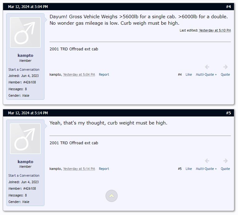

    Dayum! Gross Vehicle Weighs >5600lb for a single cab. >6000lb for a double. No wonder gas mileage is low. Curb weigh must be high.

    Yeah, that's my thought, curb weight must be high.

    @kampto - did you just comment as a reply on your own comment???

    Darren
    Yeah, I think he did! ;)
