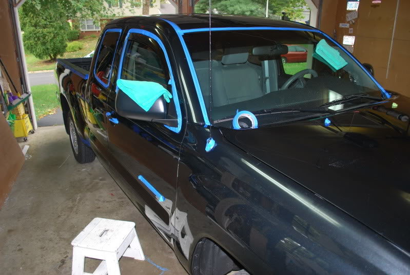

    Projects and rain stopped me from doing a full detail until this weekend.
    Since the car is new and there were no scratches I decided to just jewel the paint, apply a sealant and apply wax. A pretty straight forward detail. Below is the process used.
    Wash with Zaino car wash Z7
    Claybar with Maguire’s over the counter kit
    Polish with a Porter Cable, PC, set on 6 and using Menzerna POR85RD polish on a blue, no cutting value, pad.
    Isopropyl, IPA, Wipe down
    2 coats of Zaino Z2 Pro sealant, Z2P, about 2 hours apart.
    2 coats of Fuzion, high end boutique wax, 13 hours apart.
    Total time spent was around 13 hours.

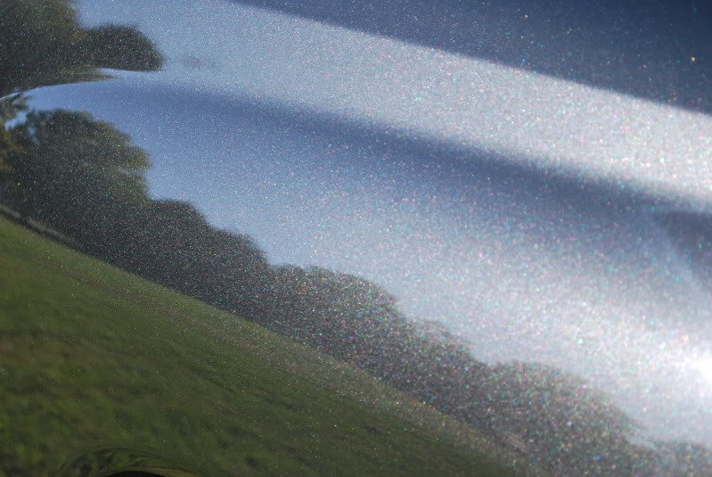

    This first pic is my attempt to show the metal flakes in the paint. IMO Toyota has really takes a stock metal flake paint to a new level. When you look at the flakes there appears to be 3 to 4 different colors but I believe that is just the way the light refracts off of the paint and back to your eye.

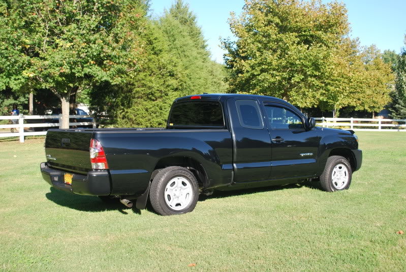

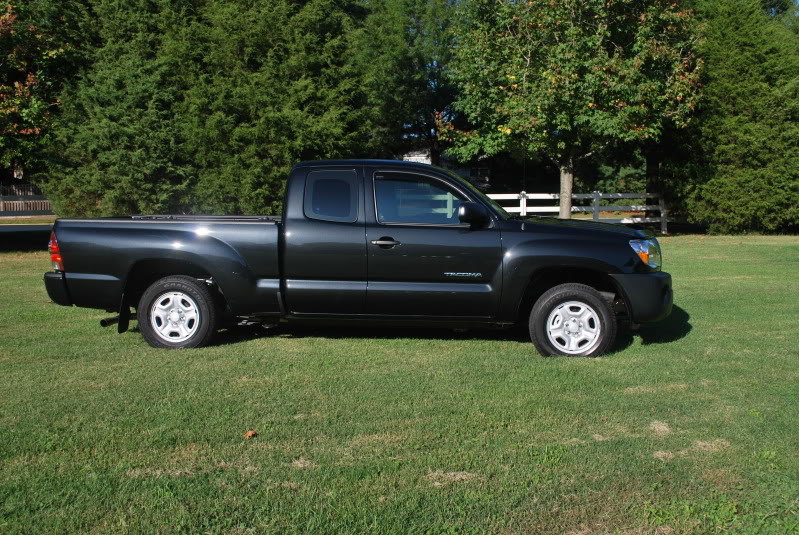

    Here are some pics in full sunlight.

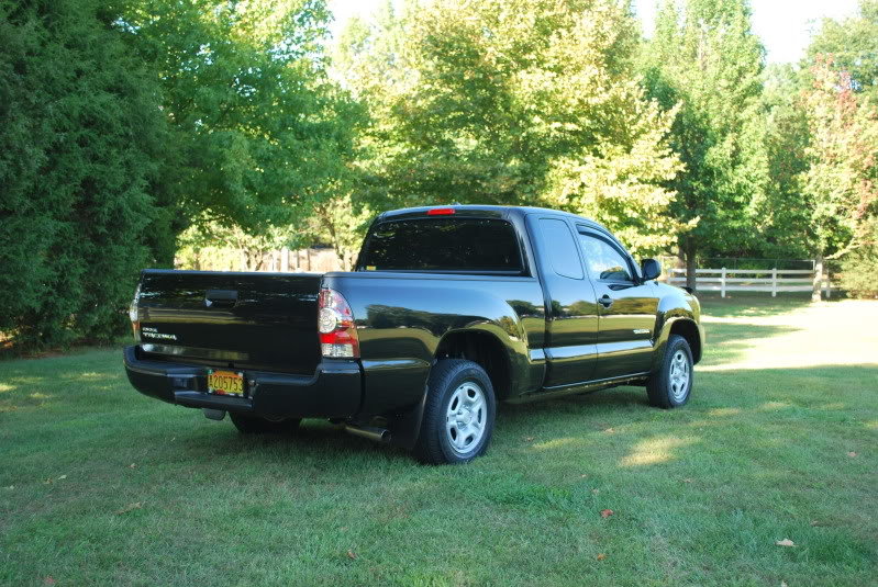

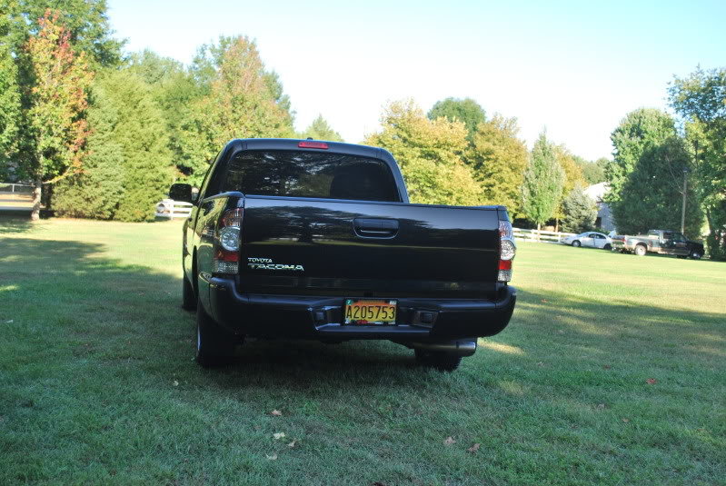

    These pics are in the shade.
    Overall I am very happy with the outcome and finished look. Fuzion is truly a magnificent wax. When you apply the second coat you can really see the paint pop. The depth increasers tremendously.
