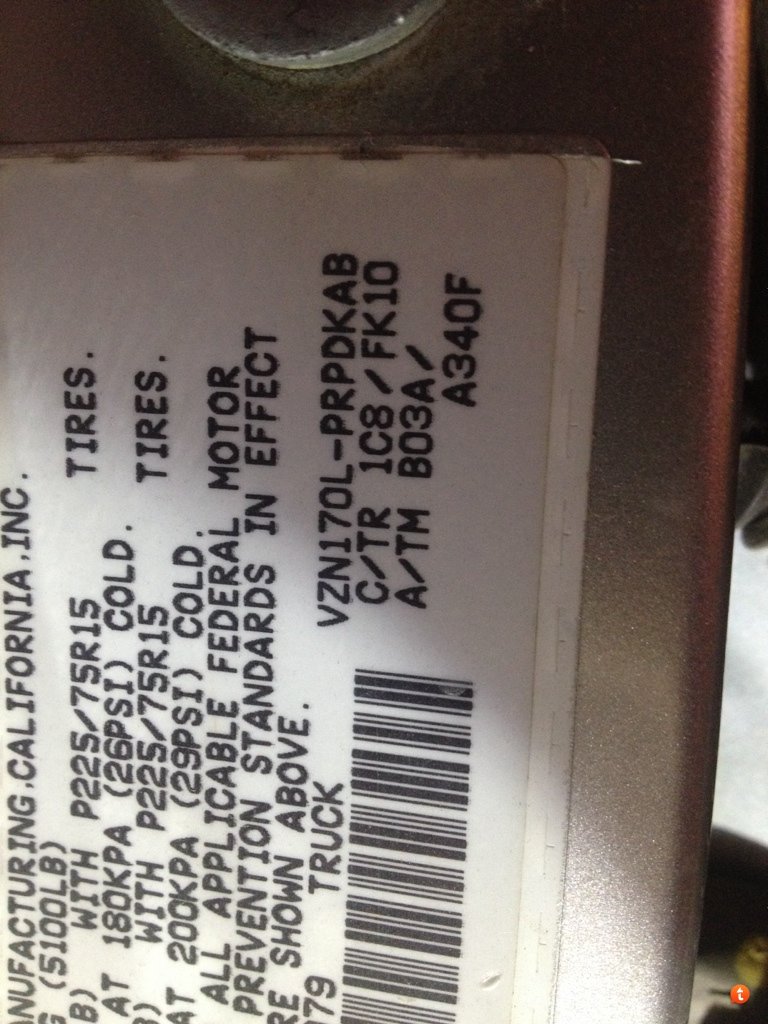

    That's weird. Cause that code is for an open diff

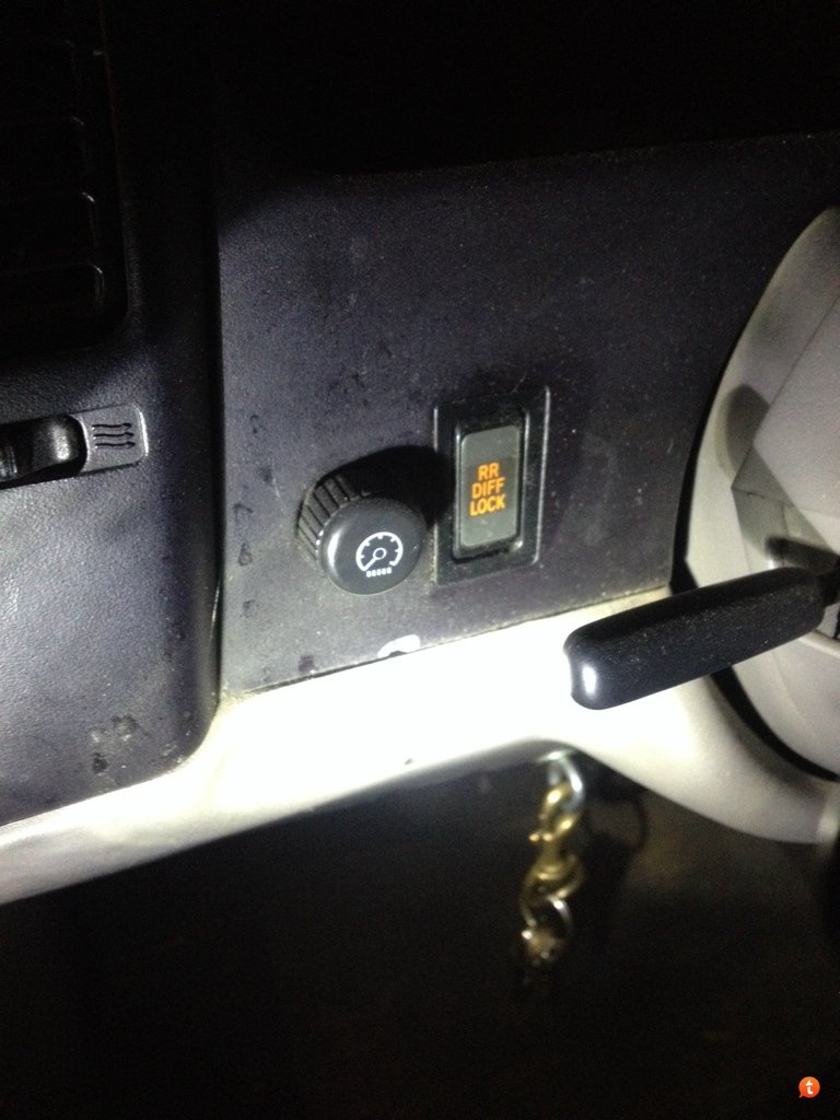

    It's a TRD...therefore..locker...therefore..4.10s..
    Gear code has nothing to do with diff type. Only gear ratio

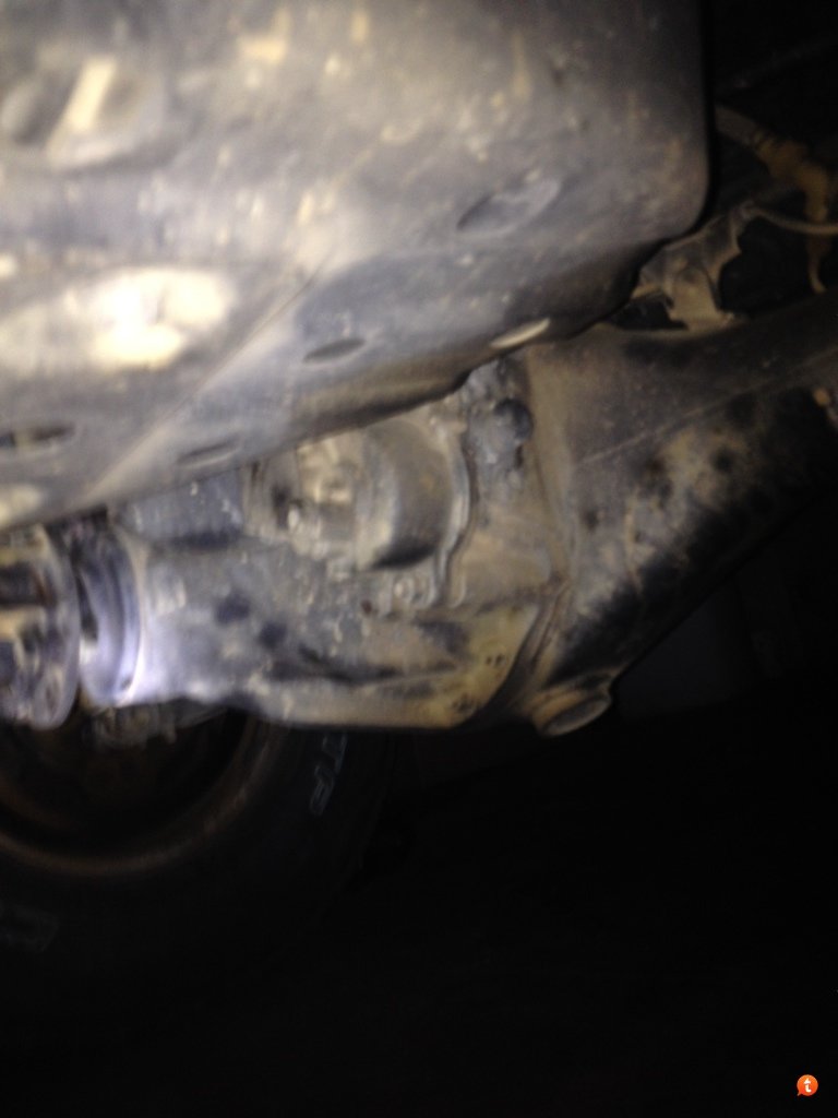

    Sorry for the bad lighting

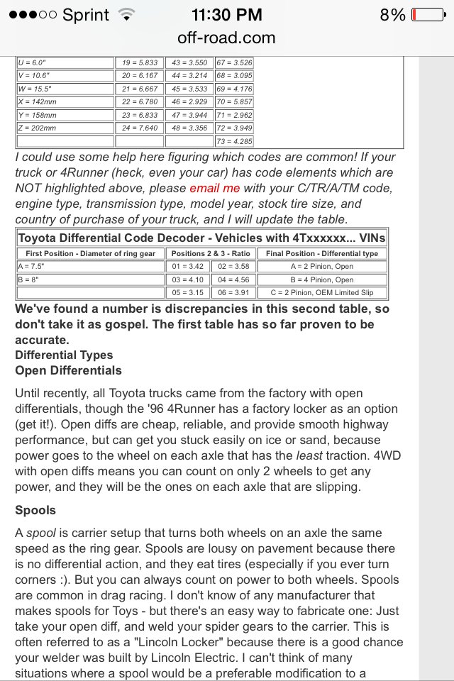

    Not true. Look. B03A. A is supposed to be 2 pinion open diff. Which is my axle

    going by that logic...there is no code for the e locker. And toyota only offered a LSD in 05-08 2nd gen tacomas.
    I can assure you..the B03A is the same code for the 8.4'' open diff and 8'' e locker on our trucks

    Maybe your VIN falls out of the 4T for this table

    Ok. Well I learned something. I didn't know they used the same code for the axles

    4.10, Elocker, Prerunner, & 4wd FTMFW
