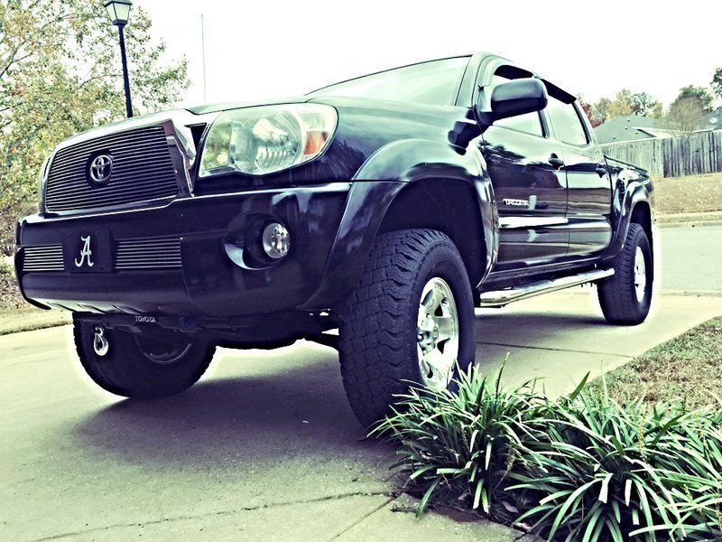

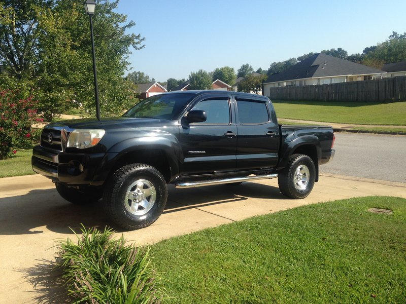

    I bought my truck with it already lifted. I really wanna know how big the lift is. How do you determine without taking it apart? I run 285/75/16 if that helps.

    I'm going to guess spacers and blocks. 3" in the front. 1" in the rear. Take some pics, and we can confirm. Also take some measurements from center of hub to bottom of fender on both front and rear. That will tell you what size lift you have. Typical factory measurements are 20" front, 22" rear.
