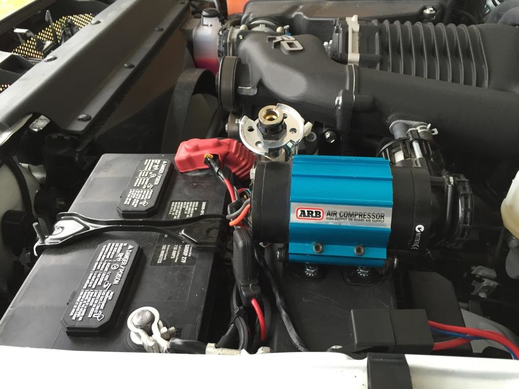

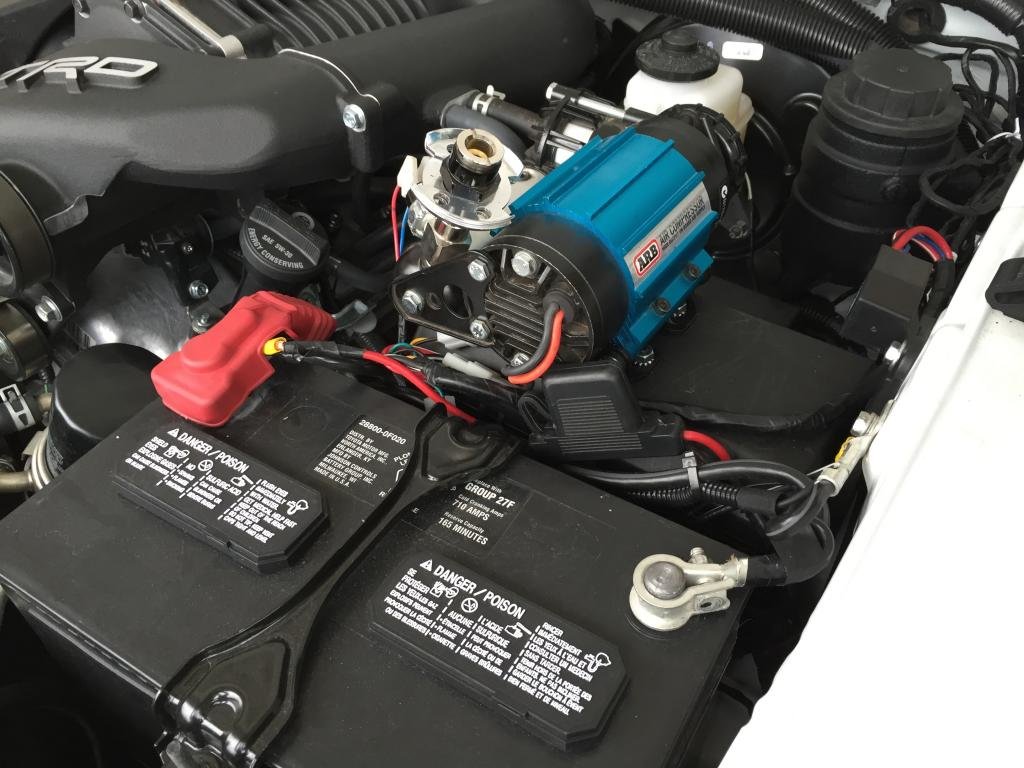

    I currently have an ARB on mine and have had Detroits on previous vehicles.
    I prefer an ARB in the rear and a Detroit in the front. Opposite of what 'most' people will tell you. The compressor, airlines, and switches are not very difficult to install. And they are considered very reliable. I've had zero issues w/ the ARB lockers, airlines, switches, and compressors. And having a reliable, fast, permanently installed compressor is much more useful for me than the locker itself.
    Both are great lockers. I would still suggest the ARB for a few more $$ than the Detroit.
    I ordered a complete 3rd member from ECGS and it was fairly easy and straight forward install. The only issue is the weight of the 3rd members. I just laid on my back and put the 3rd member on my chest/stomach and bench pressed it up to the axle while my wife and son pulled the axle shafts out enough to slide in the 3rd member. You can remove the shafts completely but this adds some steps to the install, mainly removing the brakes which then requires you to bleed the brakes and why I opted to install it with the shafts still connected to the backing plates/brakes. Honestly it was very easy. Mostly just turning wrenches. Not to technical.

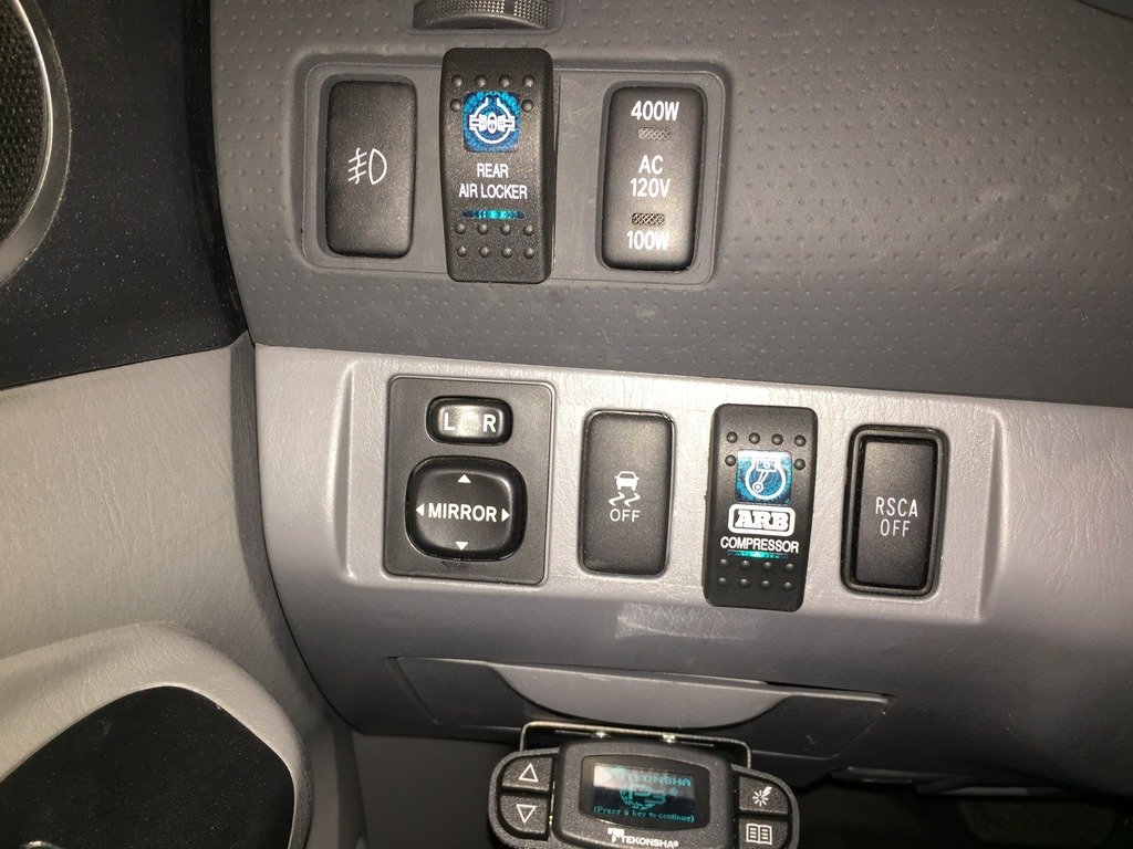

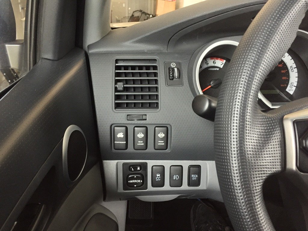

    You can order factory looking switches from aironboard.com (and probably other sources). With a little effort you can interpolate the wiring diagrams and use it with the arb harness, and you can relocate factory switches to mount them next to each other. ARBs are very reliable.
    Here is my switch setup.
    Lit up (wrong colors on the compressor switch)

    Where did you move the inverter switch?

    Mine doesn't have an inverter, so I lucked out with 3 blanks on the left hand side. I only had to relocate the fog light switch. I didn't realize before, but each factory switch has different notches on the side (like a key) matching the dash. Just took a few seconds with a small hacksaw, but could be done with a knife or file or something.
