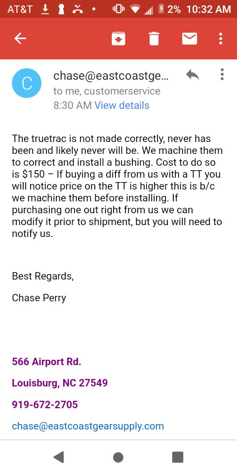

    But it seems ecgs corrects the 2 flaws they have, metall on metal cv/carrier interference and manual hub cv fit issues

    i wonder if ECGS knows if the trutrac diff will now be compatible with both tacoma and 4runner axles? Most parts stores list these as the same fitment so i'm sure the cores for rebuilds get interchanged. Going to napa and ordering a 2004 tacoma reman'd cv may in-fact be a 1999 4runner core axle
