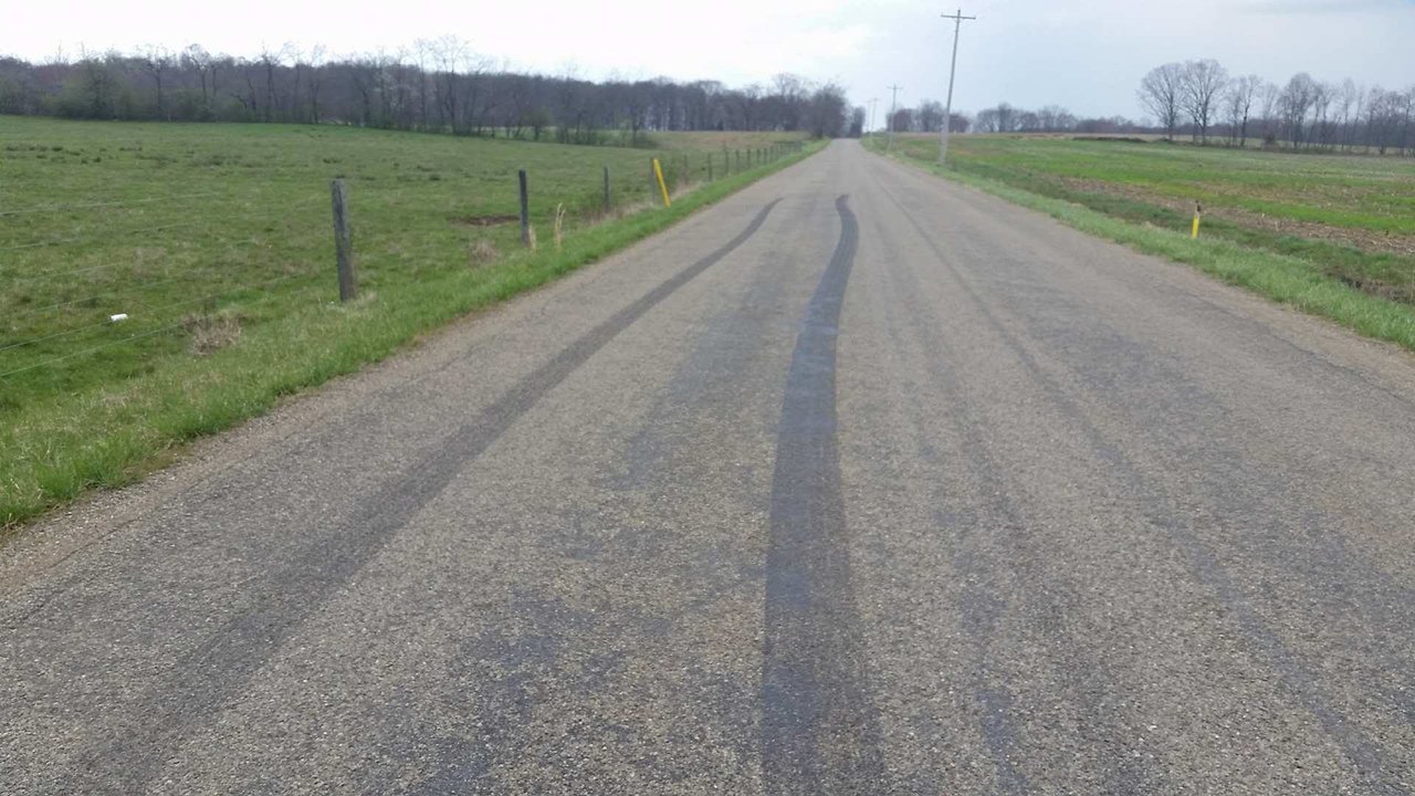

    Slightly different application, but the Truetrac in my Camaro can handle a beating
