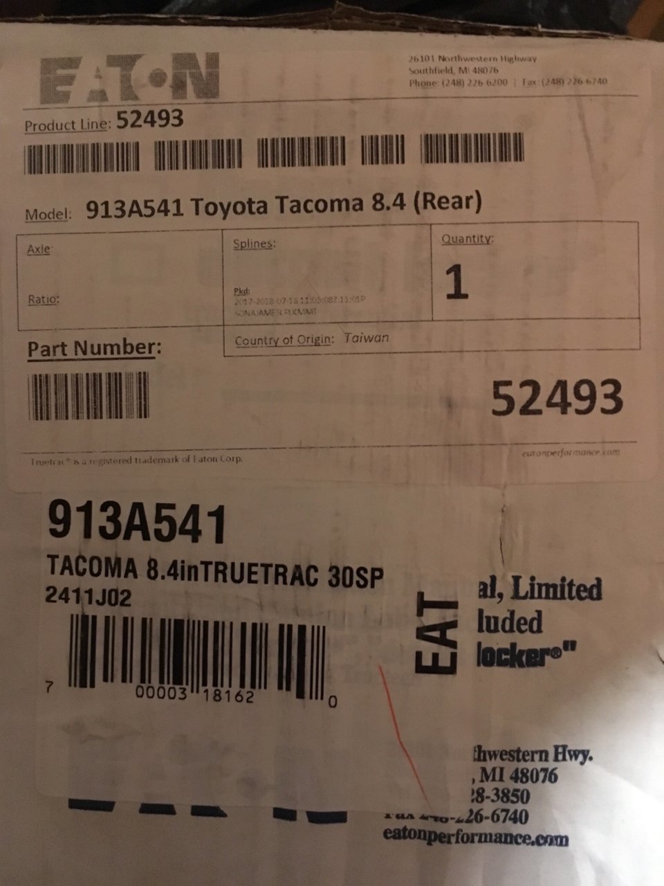

    Just got mine today. :yay:
  11. Dec 3, 2018 at 6:51 PM
    BassAckwards
    BassAckwards Well-Known Member
    May 3, 2016
    #186002
    27,954
    2009 Tacoma AWD Turbo 2TR-FE
    Full-time AWD & BorgWarner EFR 6258
    Hell yes! You're gonna love it. Makes a hugeee difference in traction!

    Yeah, only thing I kinda missed by not havin an off-road but now I do. No buttons either, Lol.

    But it's still just a warmed over limited slip the E-locker is much better for "off-road" conditions when the wheels begin to spin.
    Probably the best on road mannered and strongest LS style diff on the market.
