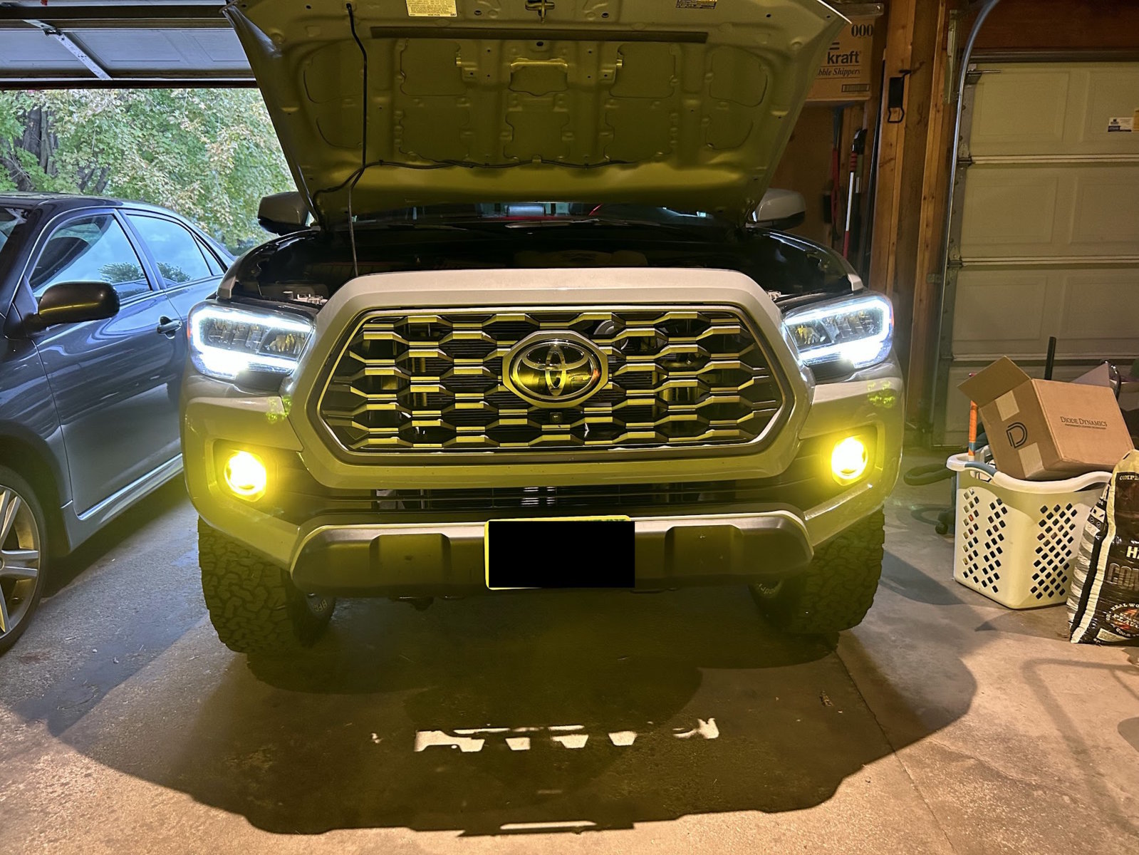

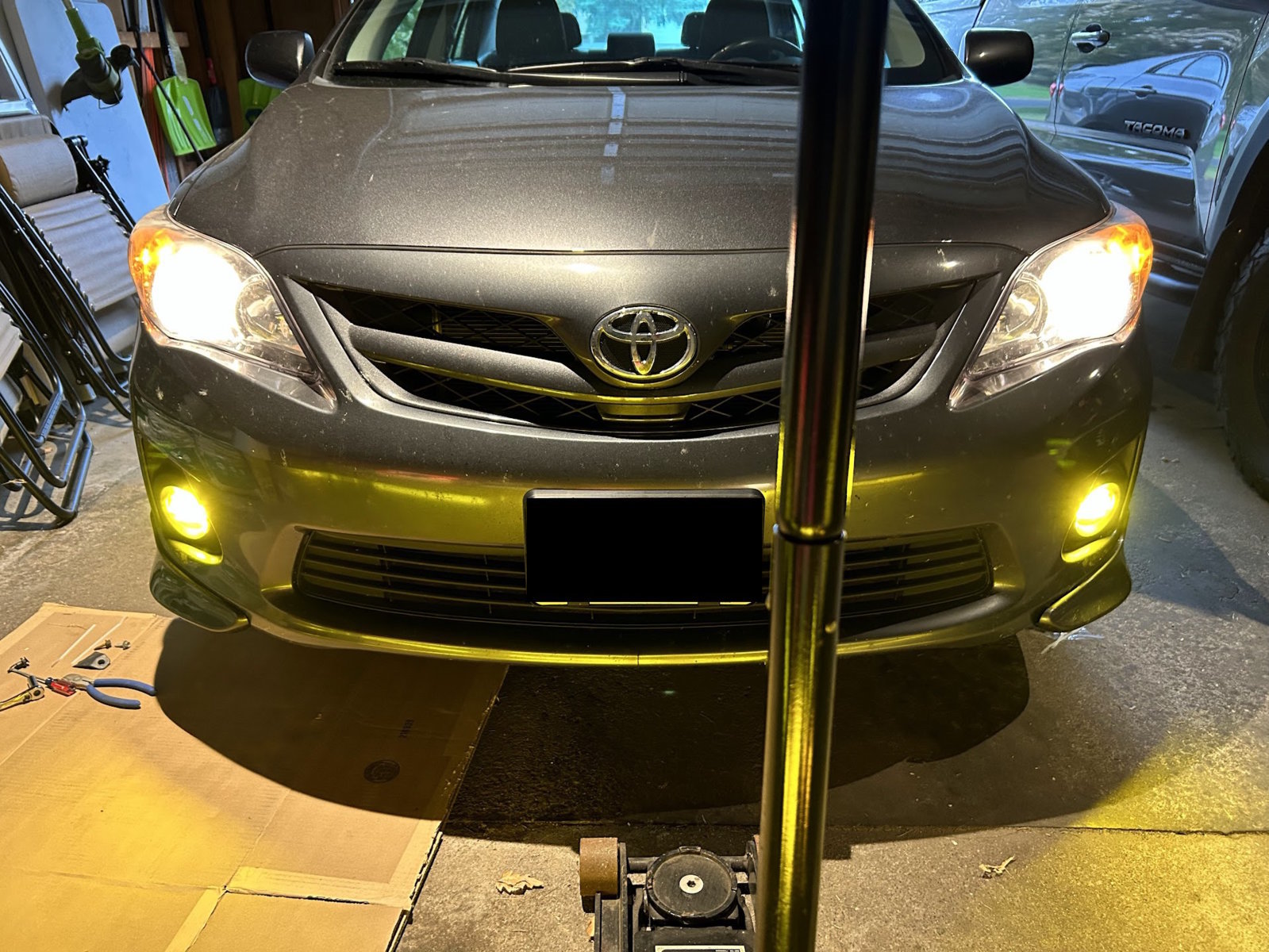

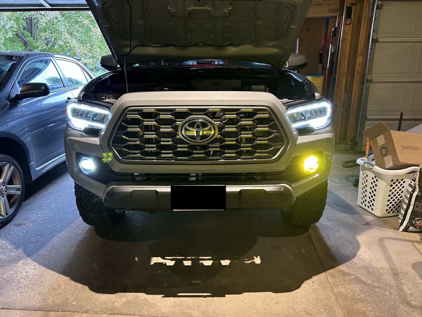

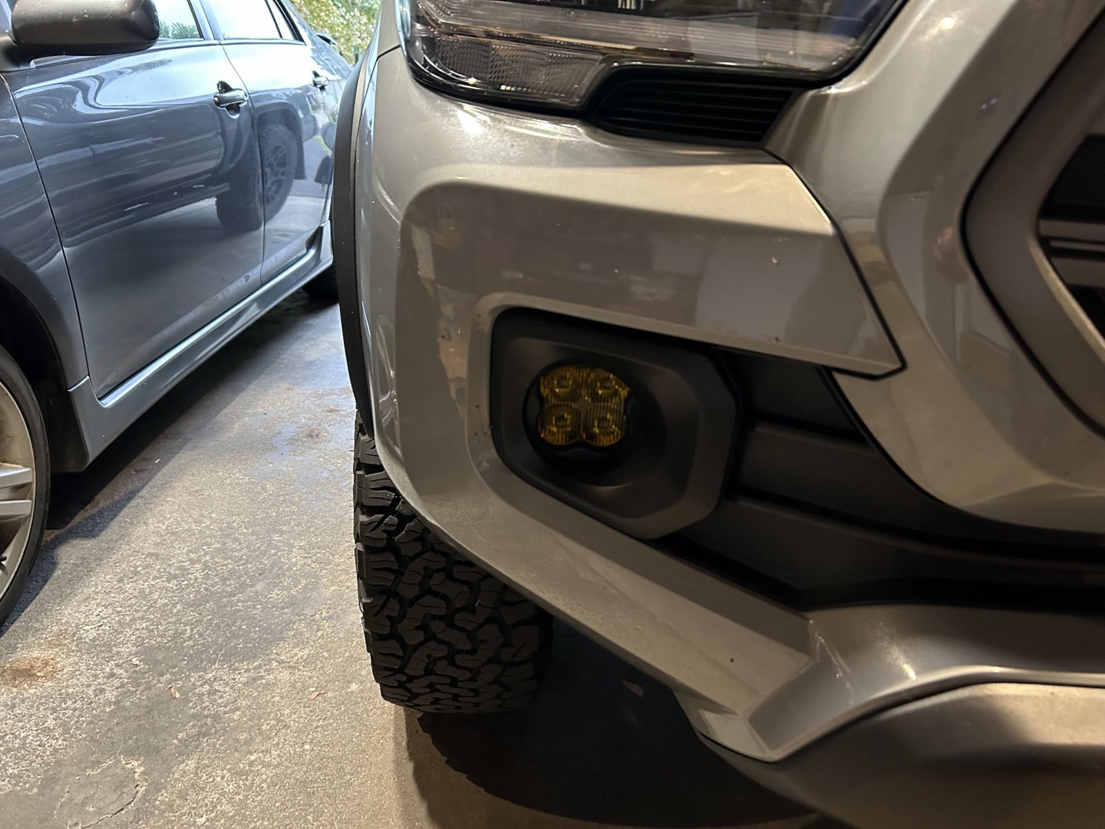

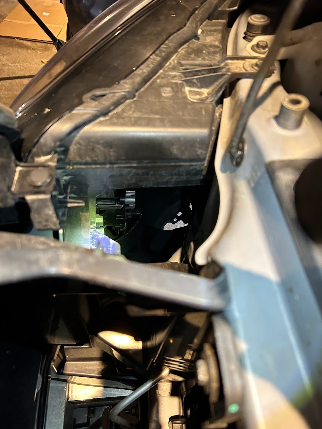

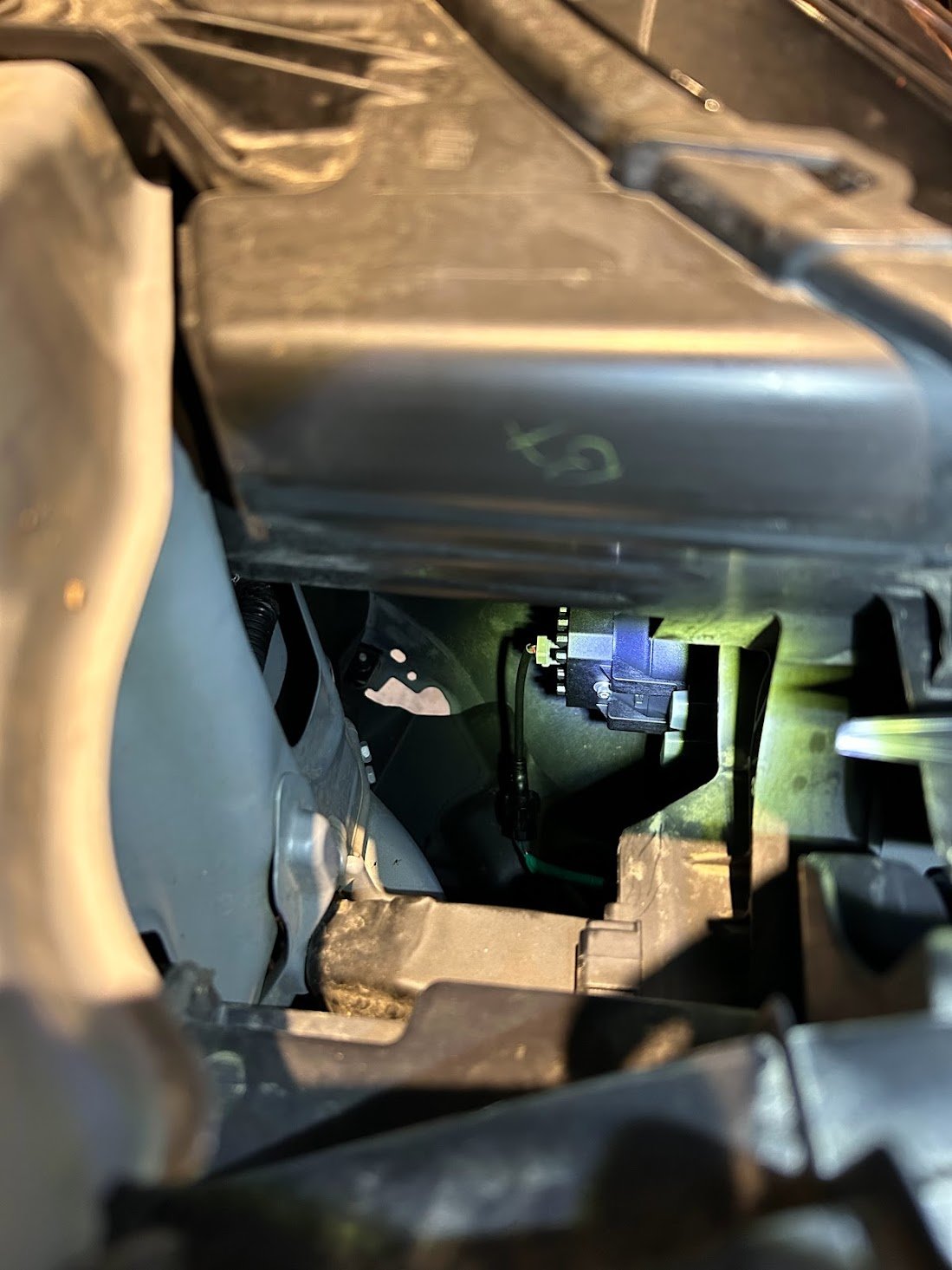

    Decided to just pull the trigger during the labor day sale for the non-backlight SSE3 Pro amber fog lights. Also grabbed a set of Elite Series amber fogs for winter driving for my wife's Corolla, a little cheaper than full SSE3s as she probably won't use them as much. Got them installed a week or two ago, but here are the pictures.
    To get to the fog lights on the Tacoma, their instructions say to remove/pull back the wheel well liner and I've also seen videos where people said to remove the grill and get to them that way, but I guess I just have small enough arms that I was able to reach through the gap between the head lights and the grill and get to the fogs. If you have good visualization/imagination and dexterity, it is possible, I did it! You just have to do it pretty much completely by feel because once your arm is in there, you can't see anything of course.
    Here's with one of each, OEM and SSE3, to compare. (Though this is daytime so not the best.)
    And with both SSE3s.
    How it looks installed with lights off.
    And for good measure, the Corolla. :cool:
