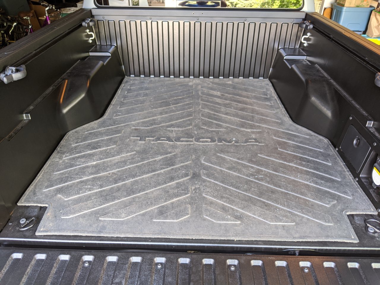

    Just for completeness sake and to link from the first post, here is the bed mat:

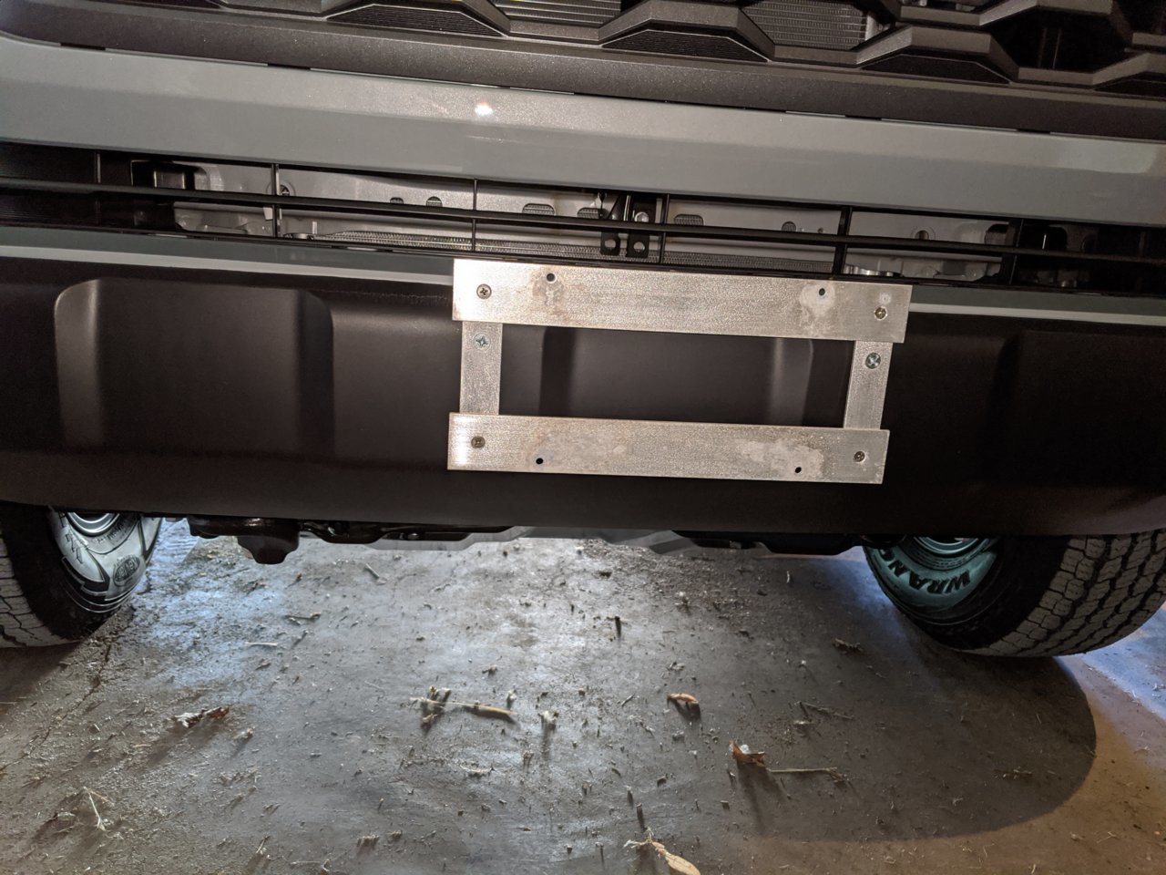

    Let's start with swapping the front license plate holder with a frameless one designed by @mrproduxn. This is a swap from my previous 2019, so it isn't new and shiny anymore, but should work fine. No plates yet to put on it though.
    Old OEM/stock license plate holder:
    Frameless holder:
    Full view on the front:
    This is very easy to do. Just unscrew the stock plate holder and the frameless one uses the existing screw holes, so you just slap it on!

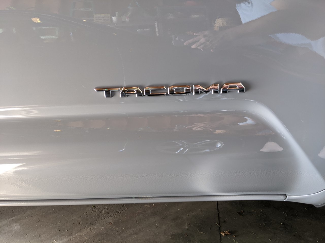

    Next I got the black emblem overlays for the "Tacoma" emblems on the doors.
    Before, chrome stock emblems:
    After with black overlays:
    I got them off eBay. I didn't need an entire new set, so I just ordered an "Off-Road" package, which was the 2 "Tacomas" and a "V6". More on that later. Anyway, I can't be 100% these are OEM, but they look and work like it, so I'm good with them either way.
    Again pretty simple install. I cleaned the emblems with some isopropyl alcohol, let it dry (takes literally seconds since it is mainly alcohol), peel the cover off the double-sided tape, and stick them on. Then apply pressure all over to make sure it seats well.

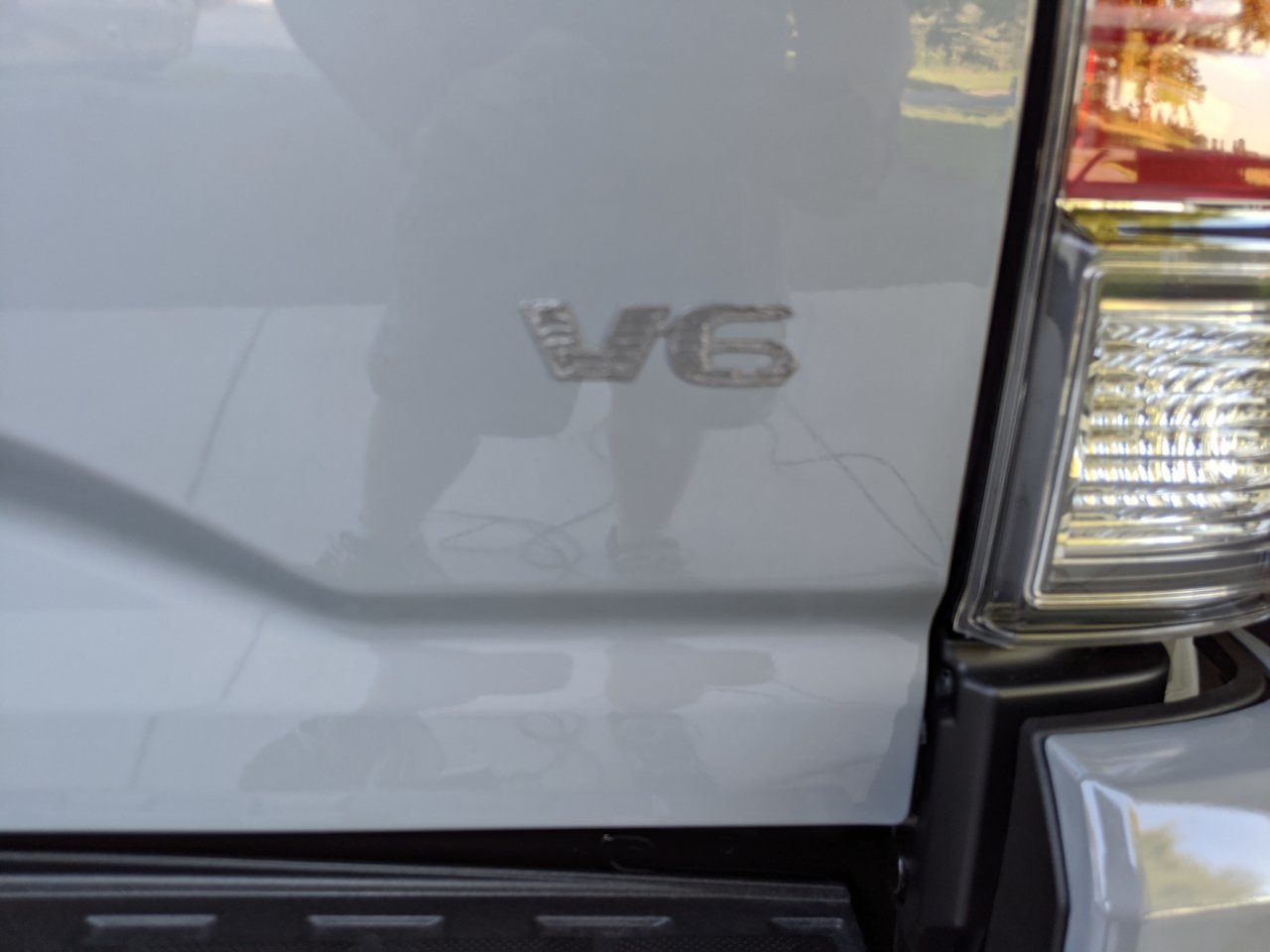

    First, removed the "V6" from the tailgate. I think it is kind of pointless and looks unbalanced since for some reason they don't put the "4x4" on the other side with the Off-Roads. So I just took it off.
    I started by warming it up some with a hair dryer on hot setting. I wanted to heat the adhesive up some so it would be easier to work on. Then I used some unflavored dental floss to saw through the adhesive as best I could until I was all the way through and the emblem came off.
    Here's how it looked at that point:
    Then I peeled off what was left by hand. After that there was still some residue so I used Goo-Gone and a microfiber towel to gently remove anything left behind. After it was clean of adhesive I washed with some soapy water and rinsed it off. I'll show the final picture of how it looked with the next post!

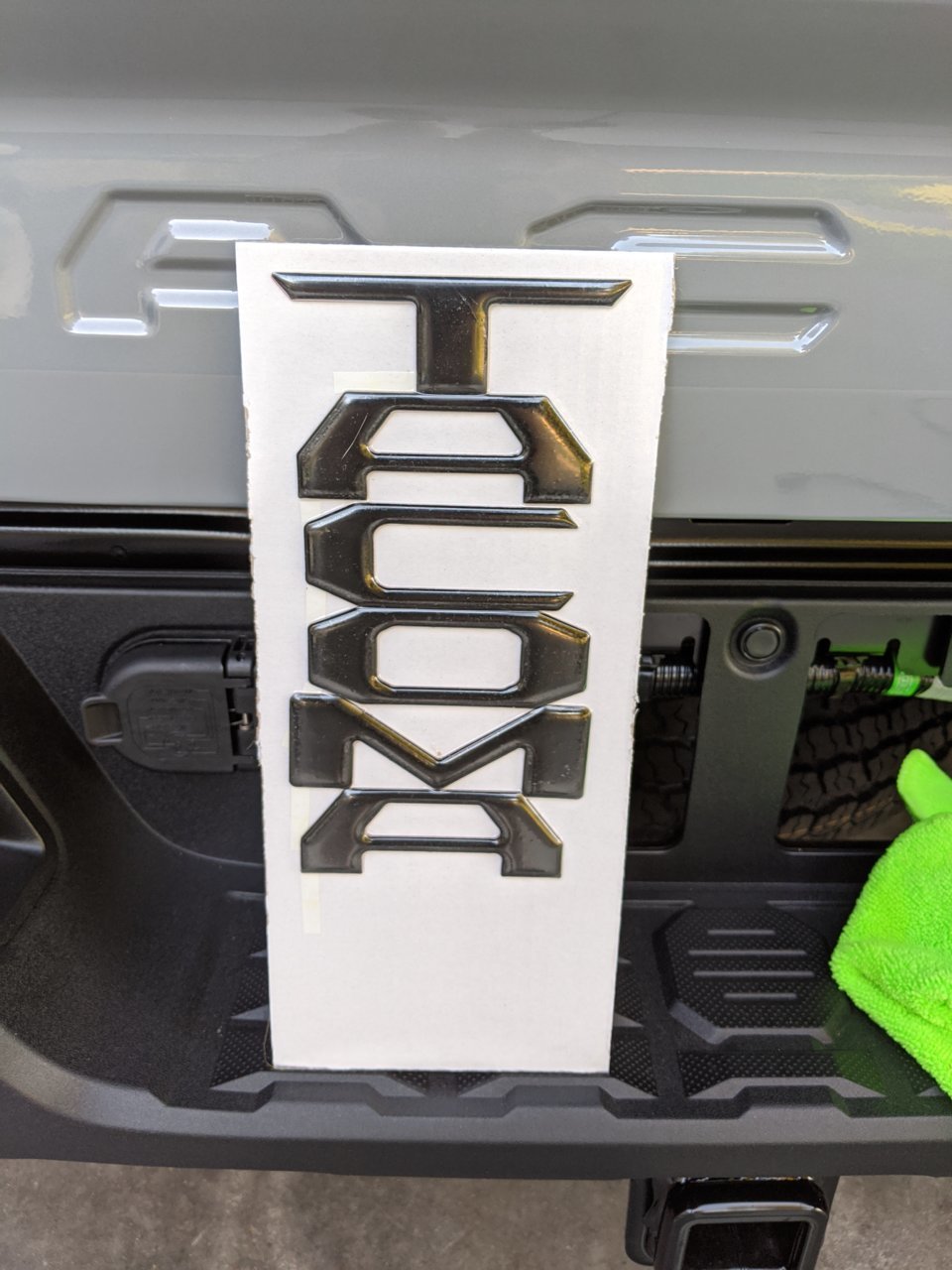

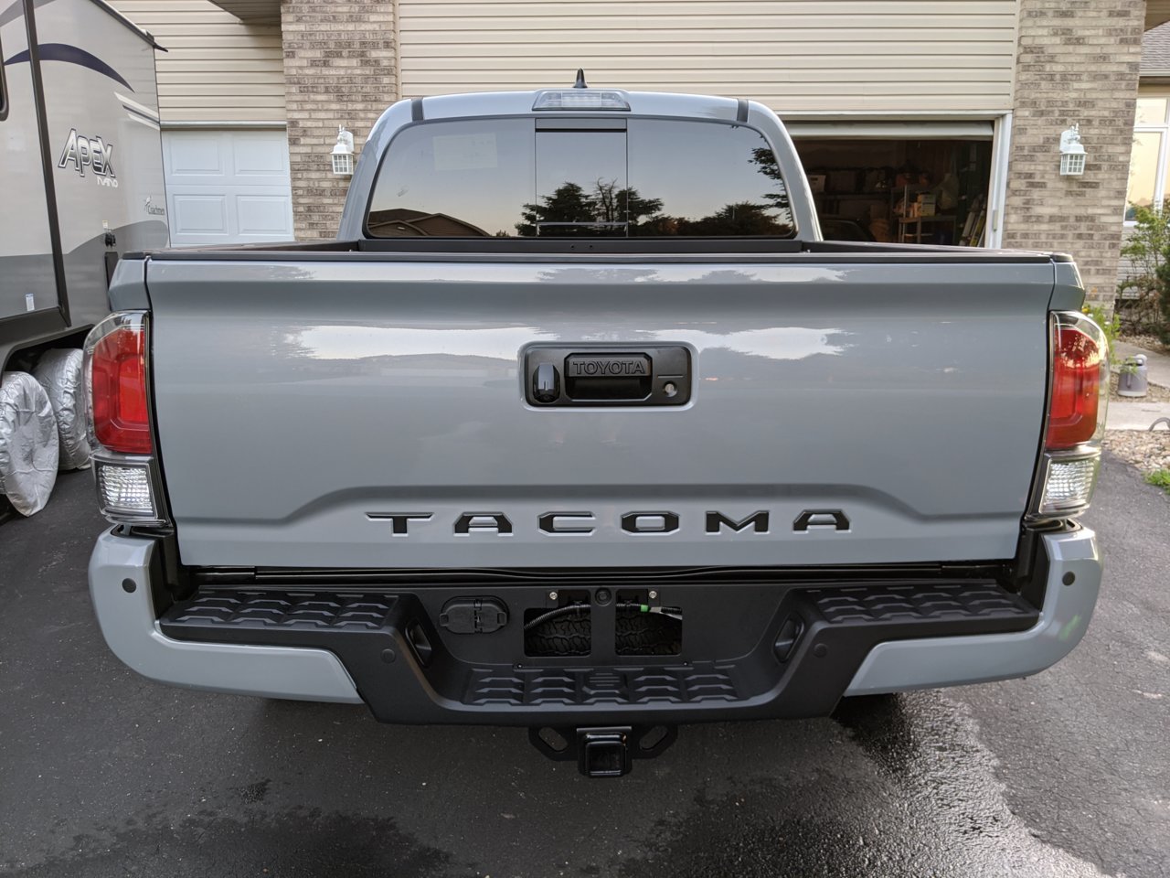

    Next up was getting the "TACOMA" inlays put in on the stamped part of the tailgate.
    I've had these sitting around for a while. I bought the full overlay/tailgate letter blackout kit back with the 2019 truck but didn't get to putting the tailgate letters on. So now I finally get to use them!
    Here they are:
    Again cleaned the letters on the tailgate with isopropyl alcohol as prep, then started putting them on.
    It was tempting to stop with them like this!
    Just kidding! I put them all on.
    As you can see, along with the completed black lettering, the "V6" from before is also missing. I think it looks so much cleaner now and the black letters make that part pop!

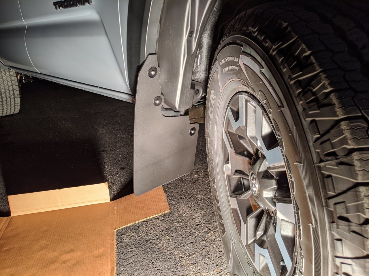

    It started getting dark, but we're going to my brother's house tomorrow and he's down a dirt road, so I wanted to get the mud flaps on to hopefully avoid too much rocks getting kicked up onto the truck. So I set up a work light and got down to it.
    Using the RokBlokz mud flaps.
    Side note to that - I had the OEM mud flaps on my 2019. When I went to pull them off the old truck to trade it in, I noticed they had really scuffed/scratched the wheel arch trim where they rubbed again them. I ended up leaving them on as I didn't want to get dinged for that on the trade-in. That was on a Sport which has the painted trim, maybe it wouldn't be as bad on an Off-Road with the plastic, but I didn't want to take that chance. Also, the OEM ones are not very flexible and I wanted ones that were now, so here we are!
    Here's the mud flaps as shipped to me (bought on Amazon instead of manufacturers site since it was Prime).
    I wasn't able to get any good pictures of them on there due to it being dark. Here's an "in progress" shot of putting it on the front though.
    The backs where a little more difficult due to not being able to turn the wheels back there obviously and so thus can't get a screwdriver on the heads. I was able to rig up something by taking a 1/4" ratchet with 1/4" socket and putting a phillips head bit in there that fit. By doing that I kind of had a 90* screwdriver. Would have been nice to just have a combo phillips head/10mm bolt head to put on there from RokBlokz, like the OEM screws I took out to install the flaps. Oh well.
    I'll try to get a picture or two of them all on there tomorrow when we have light again and add that to this post.

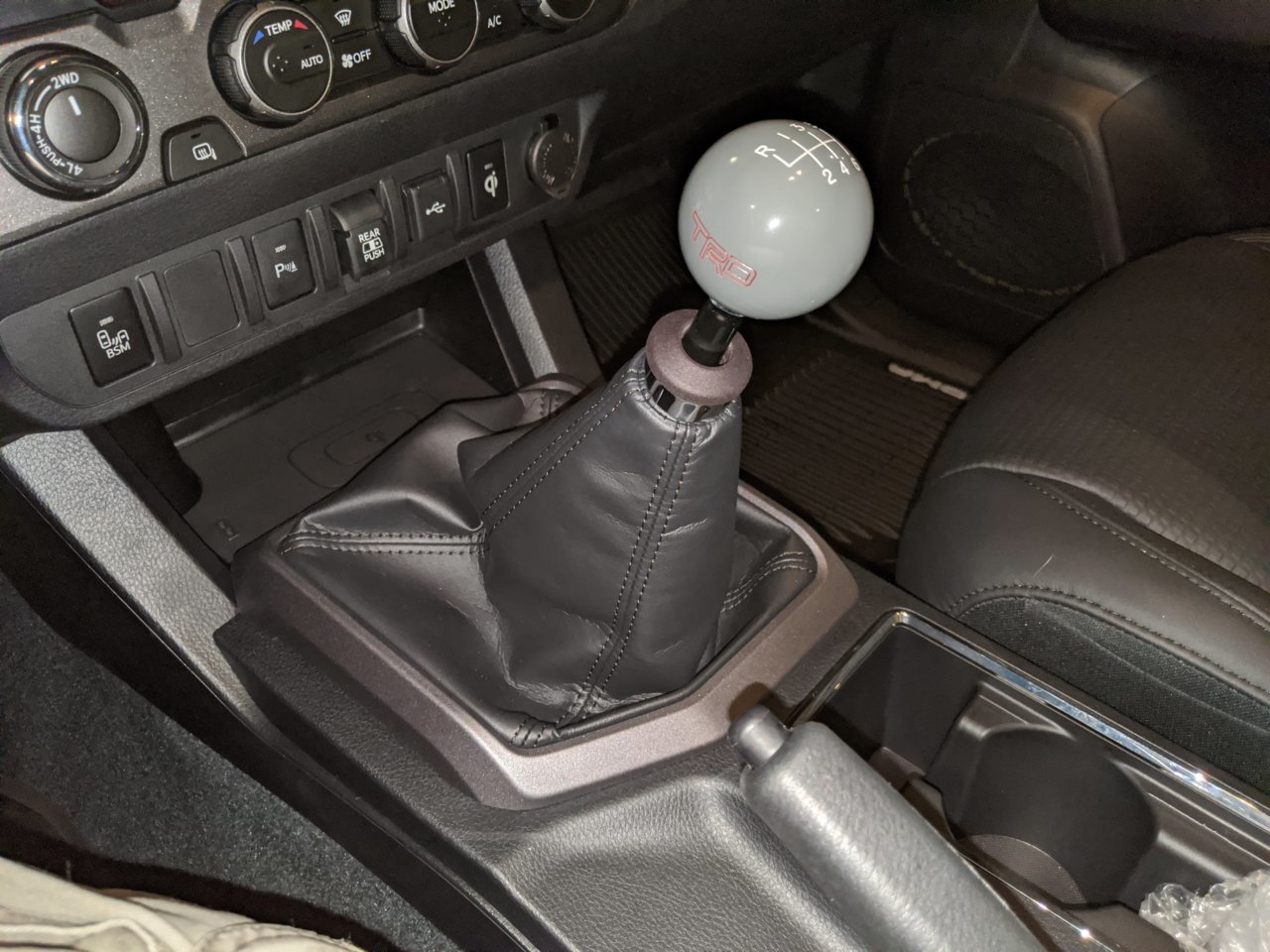

    This is a 6MT and the stock shift knob on non-Pros suck! I like the pool ball style knob and used the grey TRD Pro ball (which I think may originally be made for the FJ?) on my 2019. So I moved it into the new one of course! Since it doesn't have the connector on the bottom to attach the shift boot to, I use the shift boot retainer made by TW member @7r41lbr34k3r. Super useful little piece.
    Here's how it looks when all done. Again, sorry about the lighting but it was completely dark at this point. Also, for some reason (camera flash maybe) the retainer looks reddish in the picture, but in person it does look properly black.

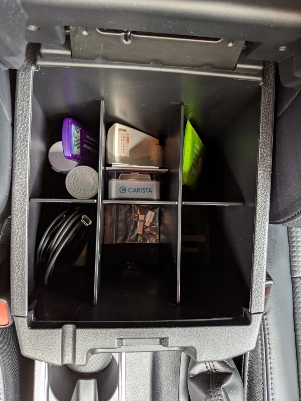

    Center console bottom - Meds, bandaids, OBDII reader, kleenex, 12V USB adapter, various USB cables and adapters
    Center console organizer:

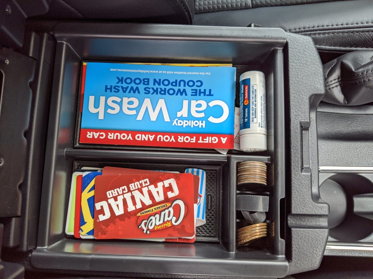

    Center console tray - car wash and other coupons, various loyalty and membership cards, quarters and dollar coins for parking and emergency needs, more advil, emergency salt =), also more napkins on top usually
    Center console tray:

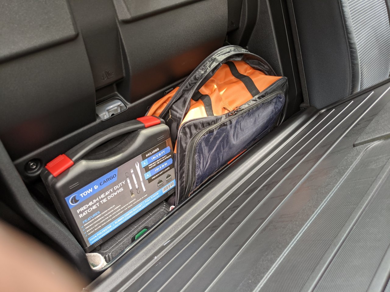

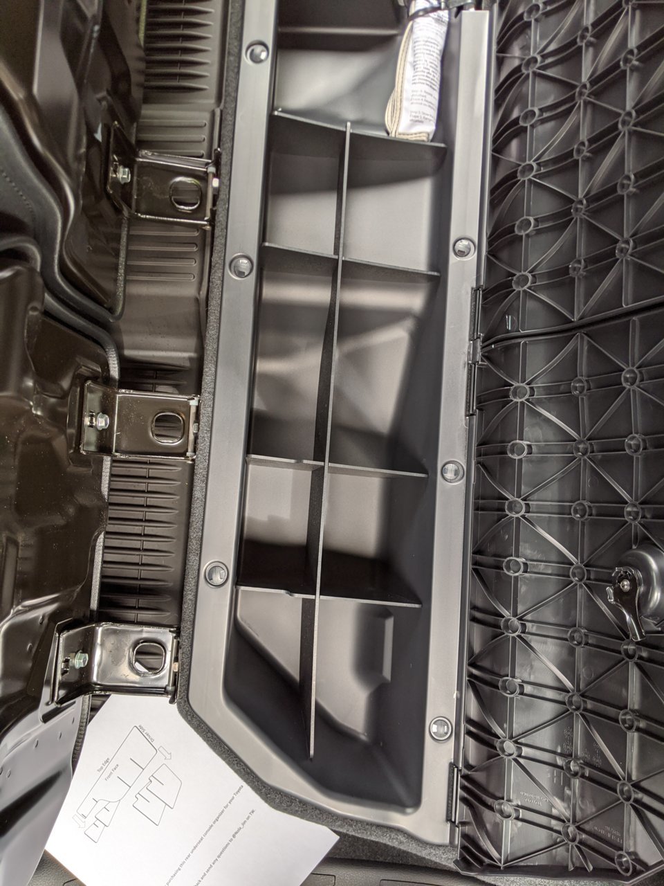

    For the rear storage, here's what I use.
    Behind seats - jumper cable, tow strap, netting, small metric set, ratcheting straps
    I bought an underseat organizer a while back and tried to put it in, but it didn't really work with what I store in there. Here's a look at how it looked though while I had it in there to test out:
    Ultimately, here's what I put down there - receiver hitch, uniball set, hitch pin
