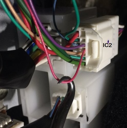

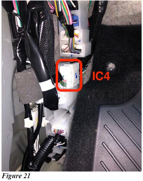

    The only change I observe is that the same connector to tap on a 2020 has a different label.
    IC4 on a 2020:
    is IC2 on a '16 ~19.
    VicNic3 and jmneill[QUOTED] like this.
