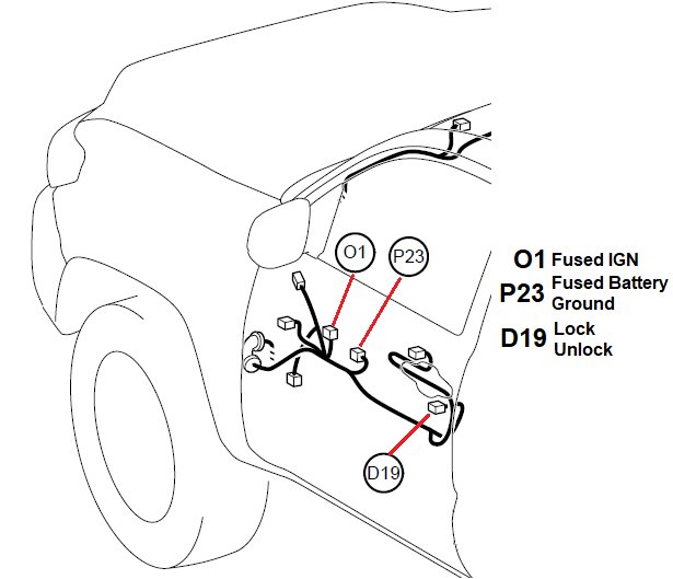

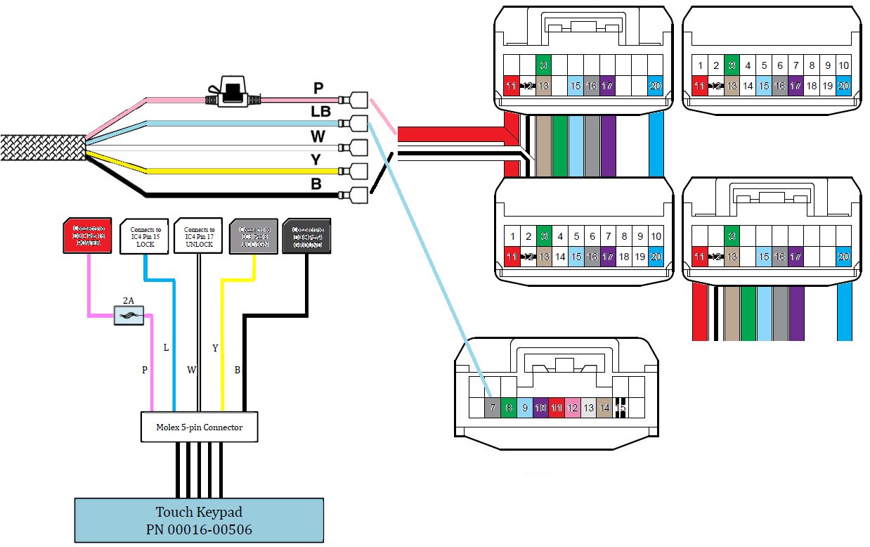

    But seriously, the connector to the Driver's Door window/lock control has all the inputs required for the install. There's an item sold that provides illumination to the interior door handle which is a "T", where you could tap into the necessary feeds.

    @jmneill
    The T is already available.
    Fused ignition source in the Accesscab connector is the Power Mirror juice.
    Still missing the ID on unlock/lock wires...
    [Accesscab with Jam Protection feature]

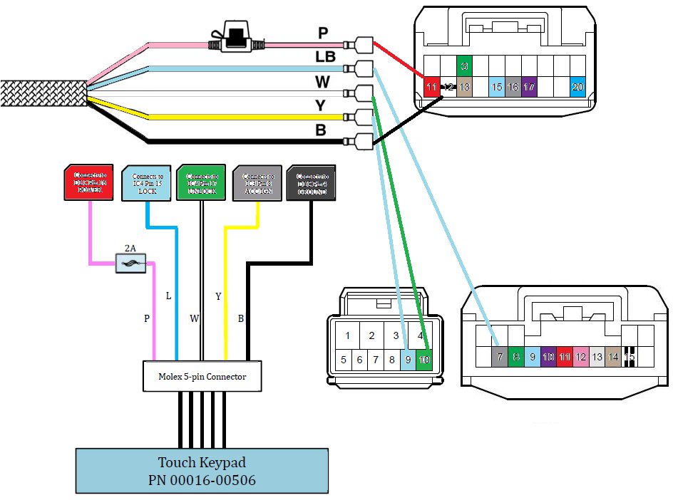

    If you use T-taps that package includes, all wires are in Driver's Door harness.
    Or use the locations the instructions indicate...

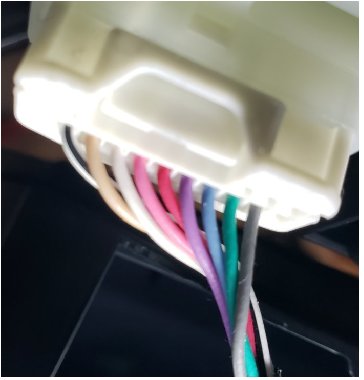

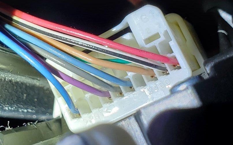

    hello there. im currently installing the keypad on my 17 Tacoma can someone help me identify lock and unlock wires on the ic2 connector.

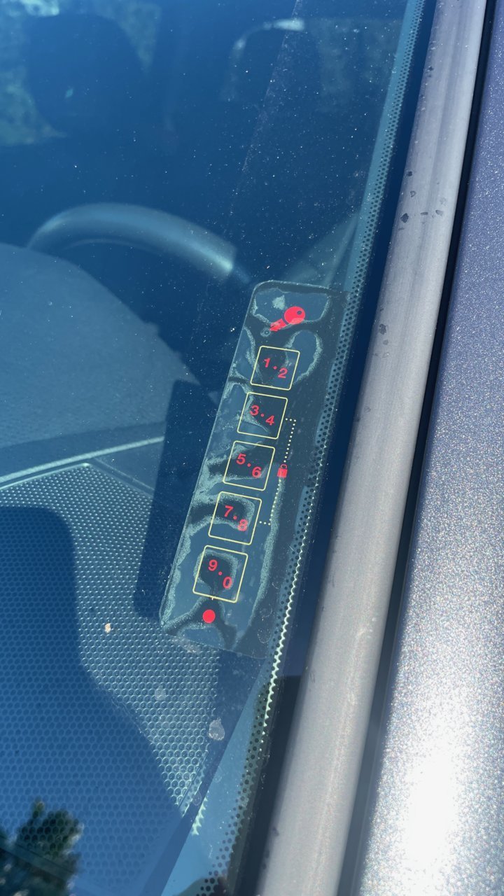

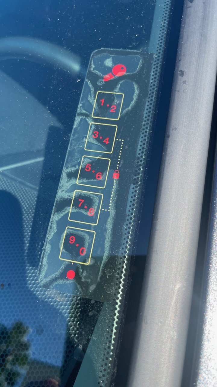

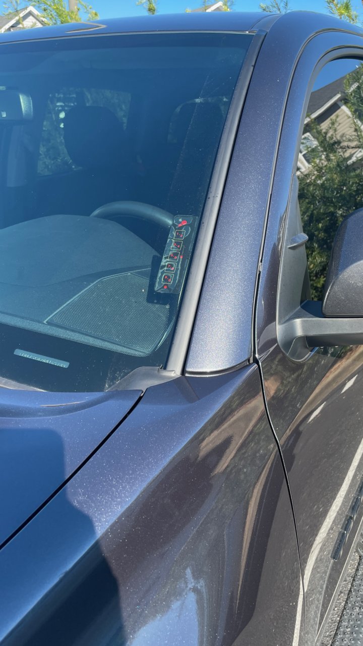

    I bought my truck a few weeks ago and I wasn't sure what this was. I was able to reprogram the code and it seems to work well. The only issue that I have is that it is less than a year old and there are bubbles under it already. The truck is less than a year old, still under the factory warranty...I am hoping that they will replace just the part that sticks to the windshield since it was port or dealer installed.
    oostroma and RyanDCLB like this.

    Thanks for the photos. It seems like there should be some peel-and-stick rubber seal that can be installed instead of the adhesive.
