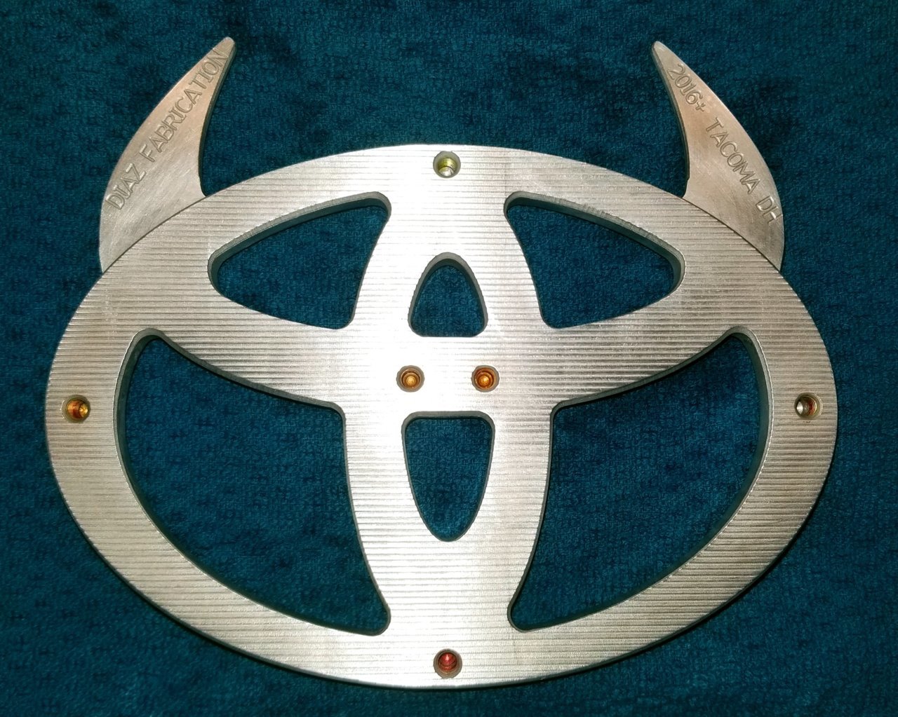

    So here's something interesting to think about.
    Aluminum is porus, if I leave the aluminum bare and shot penned and touch it with bare hands the acid in my hands will transfer to the emblem and be noticeable.
    Steel rusts, aluminum corrodes.
    I can work on your request but make sure you clean it well prior to paing, Isopropyl alcohol is what I recommend and using latex gloves.
    I've had aluminum corrode underneath paint and powder coat, not fun when you notice the paint/powder coat lifting from underneath and bubbling.
    lynyrd3, RobP62 and ChadsPride like this.

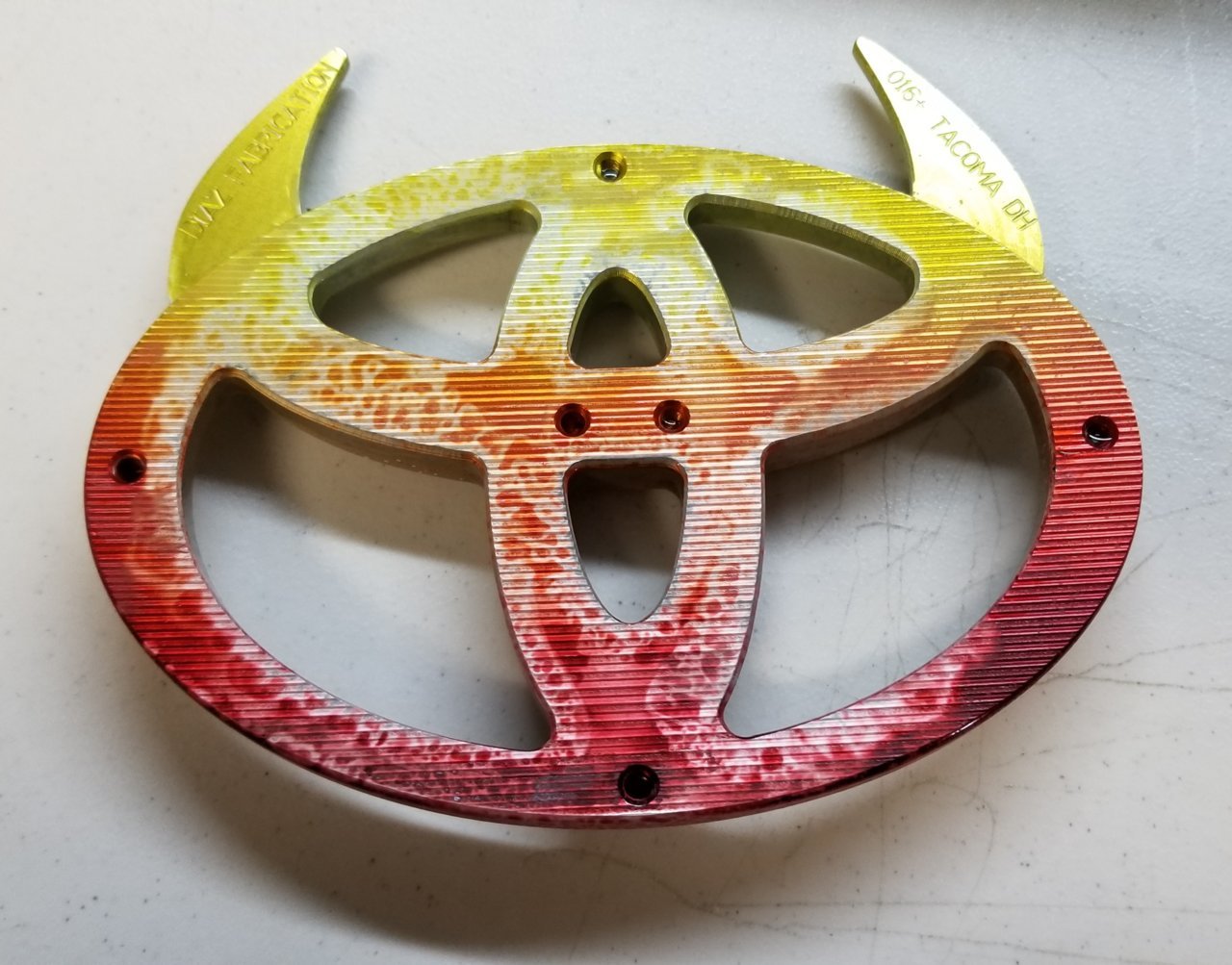

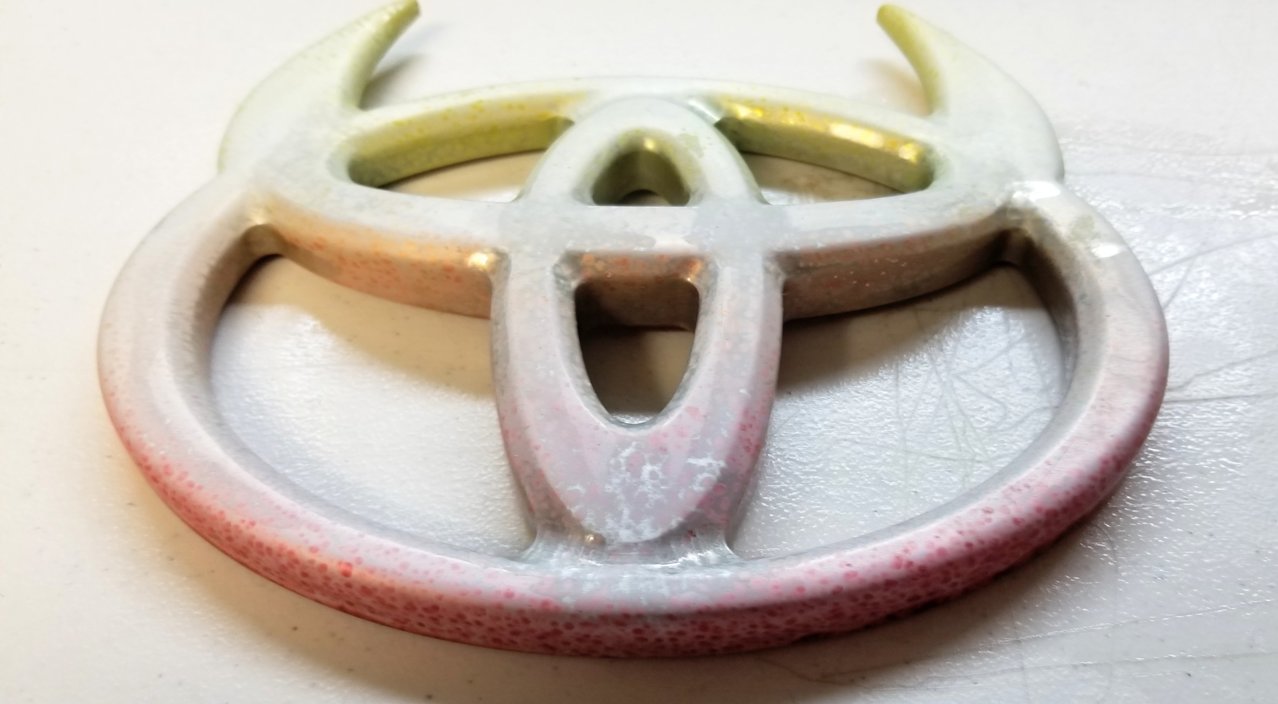

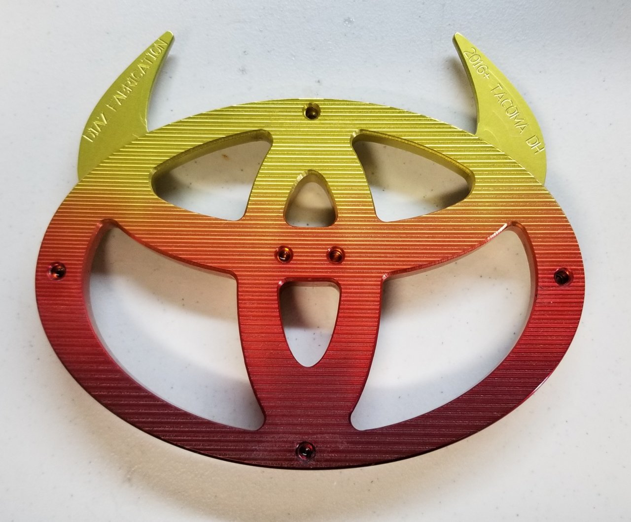

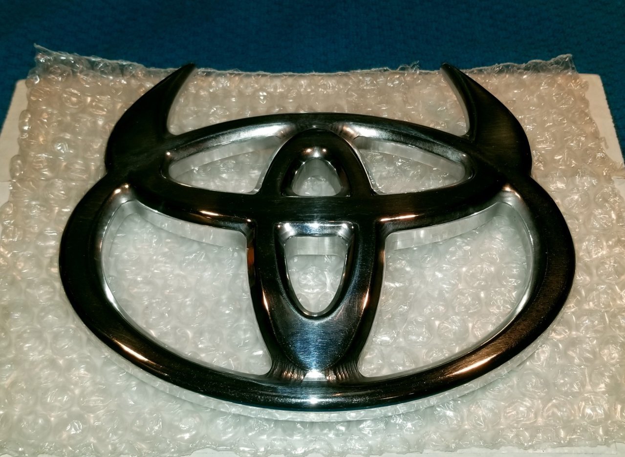

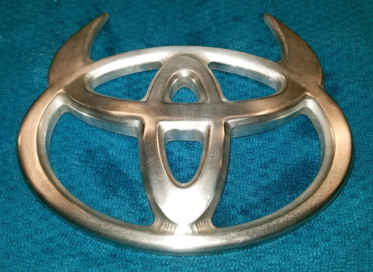

    @Andres , I got busy this weekend. I'll be sending mine either tomorrow or Wednesday.
    Front before, after two years.
    Back.
    Obviously a huge difference. :pout:

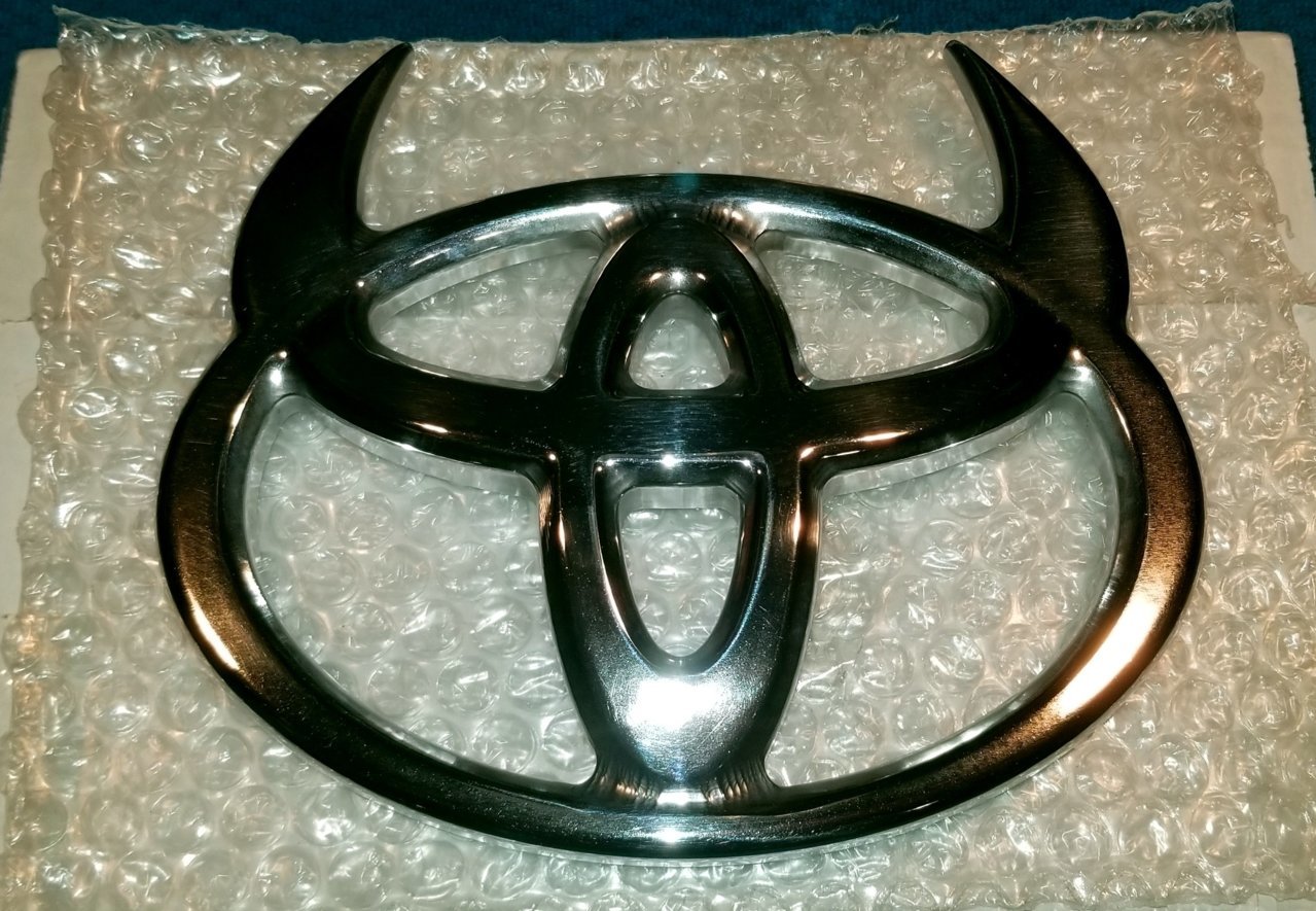

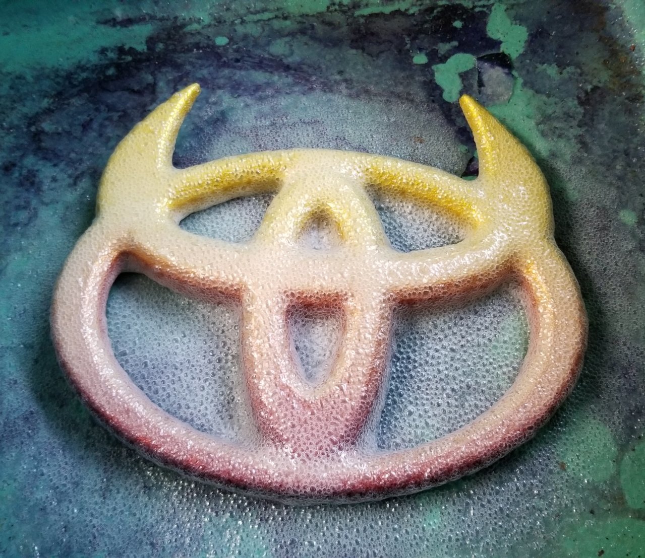

    So I did the Easy Off oven cleaner, the heavy duty, with fumes version. Leaving it on for 15 minutes. I really coated it. I used a plastic container that I also use when I do PVC plumbing fixes around the house.
    I was super skeptical after watching the YouTube videos because I had a lot remaining.
    After the second coat the front was better but the yellow on the tips of the horns was still there. I went for a third coat.
    Each time I was just rinsing with tap water.
    After the third coat I freaked out. They were so tarnished I thought I ruined them. I used 0000 steel wool and dawn dish detergent and the tarnish came right off.
    Except for the threaded holes, they were completely stripped of all anodizing!
    :taco:
    But I didn't like the minute swirl Mark's so I used a buffing wheel in a drill (don't have a bench grinder, yet) and a product similar to something called Neverdull. It's a metal polish that removes imperfections.
    I think the end result is incredible, and should definitely be ready to be redone.
    I even have the original packaging to send them back in!
    I can't wait to get them back!
    Let me know what you think Andres. I will wait to hear back from you before shipping them.
    Thanks,
    Rob

    Ok, so I'll take that as, I am shipping them out back to you tomorrow. :thumbsup: Most likely FedEx, and you will have them before the middle of next week. Maybe this Friday.
    Normally I would bitch about how long it took but I enjoy learning how to do things like this. Now that the enjoyment of that is over though. It took freaking too long! Now, granted, I was doing other things while the easy off was sitting on them but if you add it up, maybe 3 hours total. Knowing what I know now though, I am sure it could be done in two hour or less. Keep in mind, the chemical has to sit on there at least 15 minutes. Your anodizer must be really good because on the web the coatings were coming off after one shot. Mine took 3 to make me happy. So that is 45 minutes right there. Add another 15 minutes each time to steel wool and rinse them, or 45 min, so now you are at an hour and a half. The last process of polishing took another 20 - 30 minutes. With a bench grinder I could have cut that time in half. It sucked using a drill.
    Technically though, I could work them a little more with the polish and a buffing wheel on a bench grinder and make these look like chrome, shoot them with a couple coats of clear coat, and reinstall them. All for some of my time and like 7 bucks for the easy off.
    Definitely want the horns on fire look though so they will be coming back. I'm kind of hoping to get a little more orange and less yellow and dark red this time if possible.
    Thanks again Andres for a great product and working with me on this. I was really bummed but now I am happy again.
    Rob
