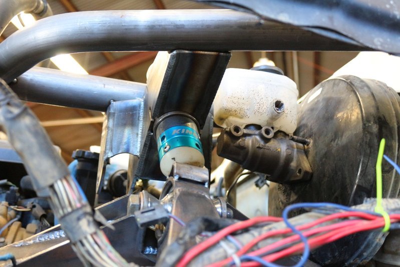

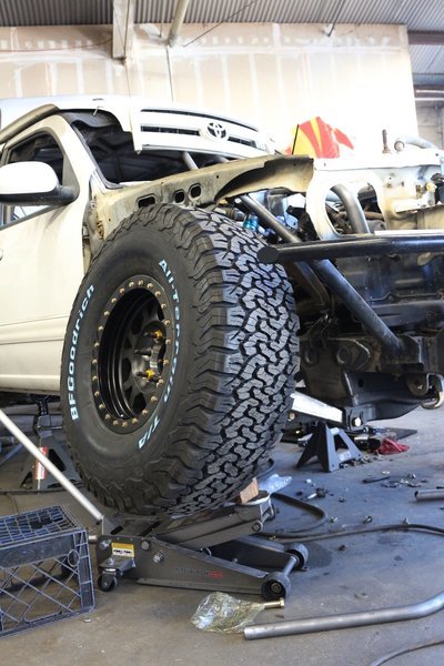

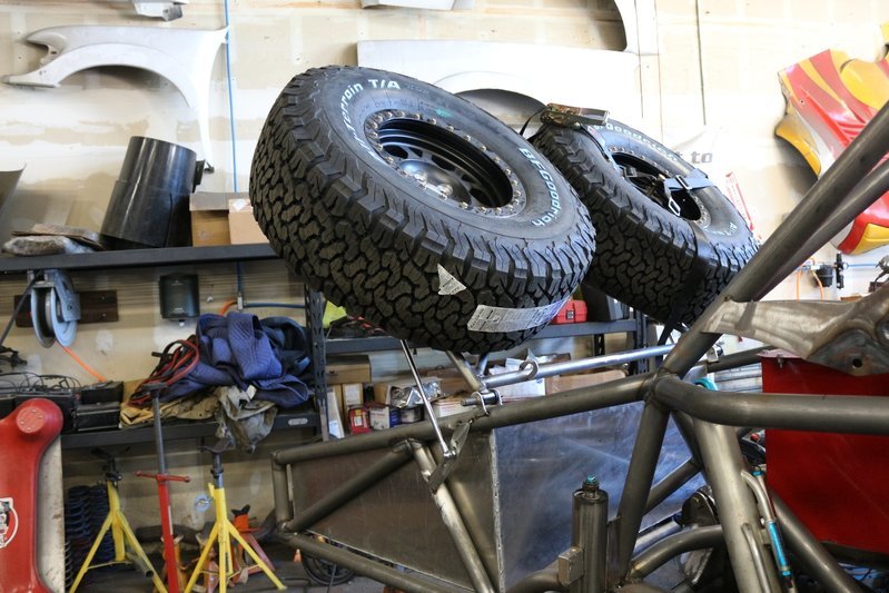

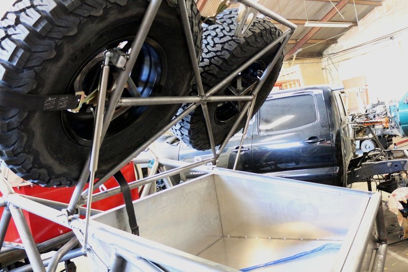

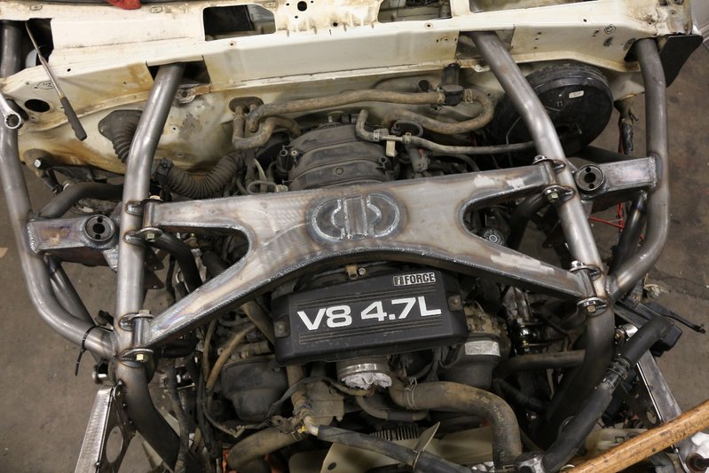

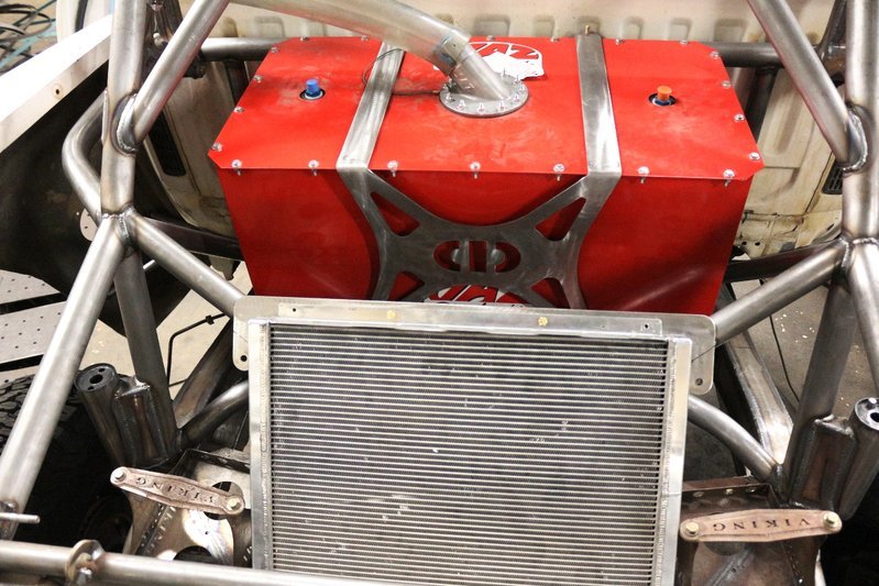

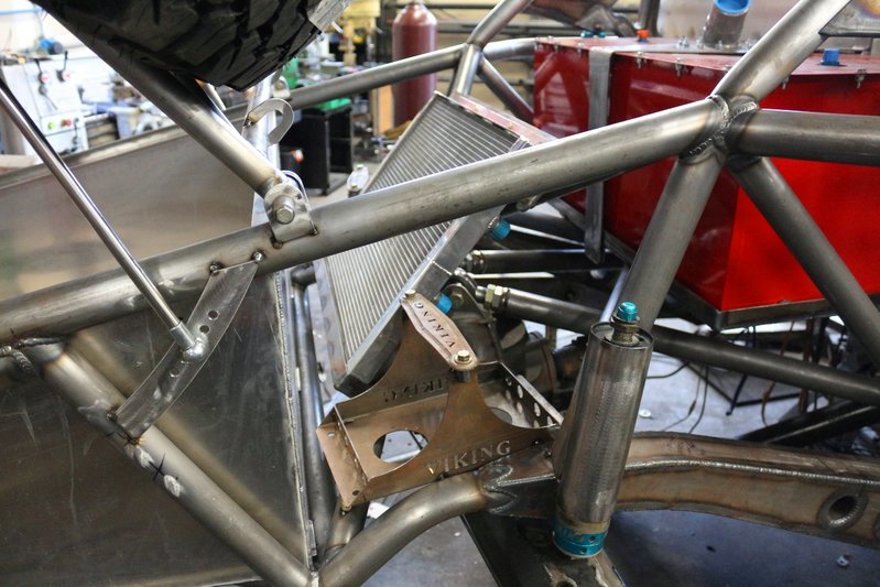

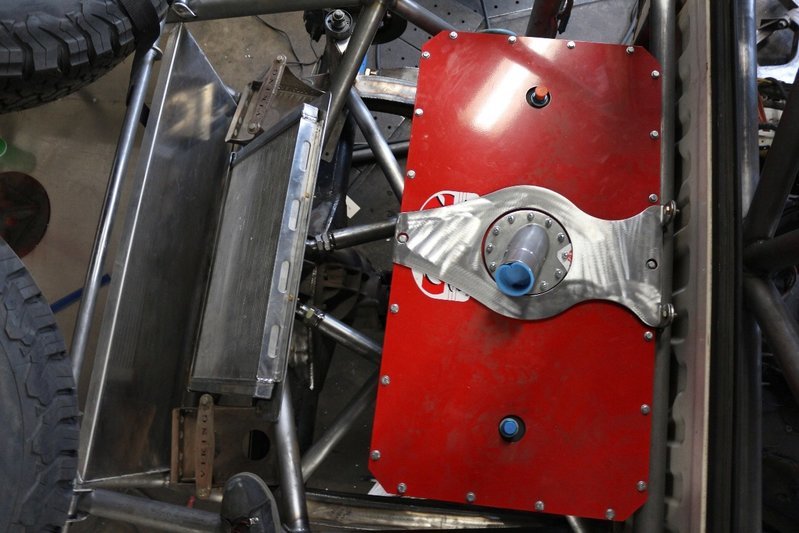

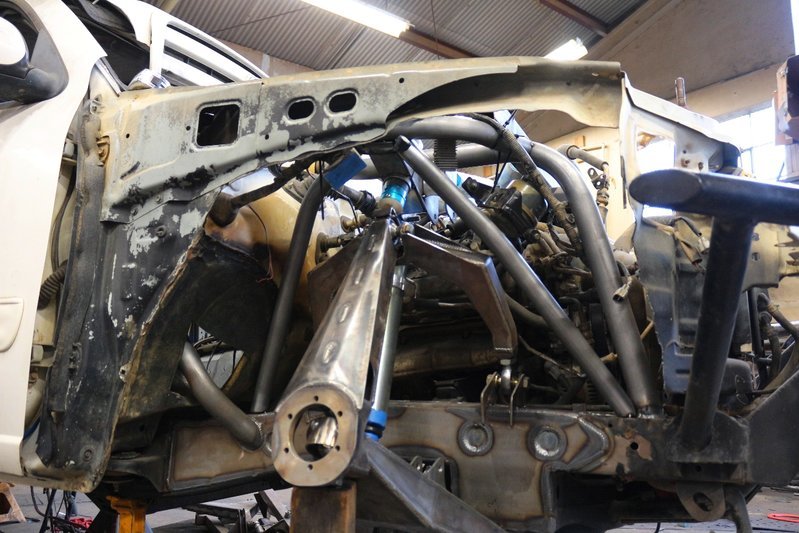

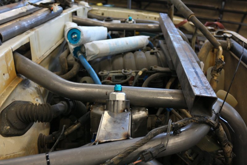

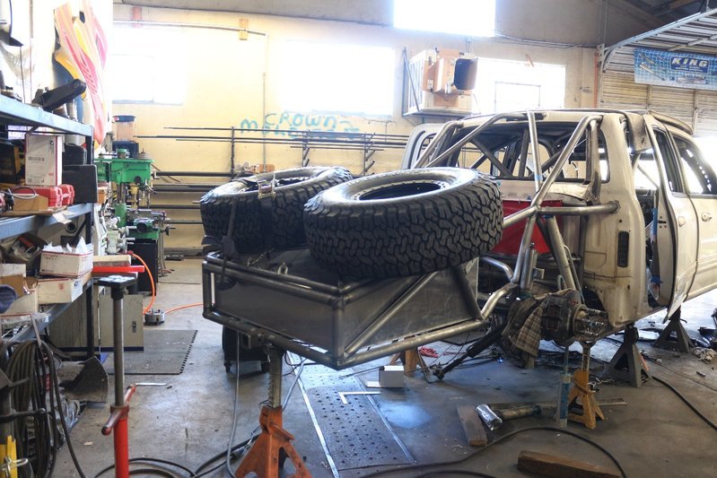

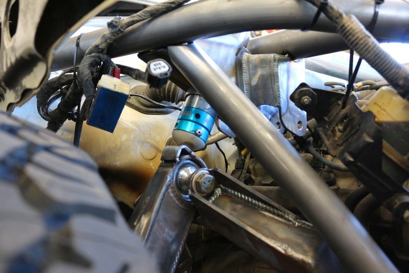

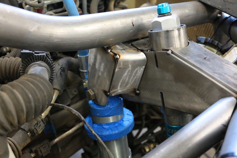

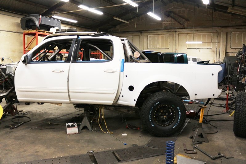

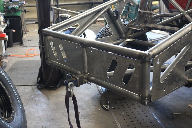

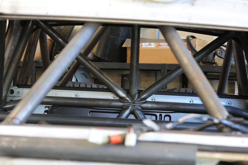

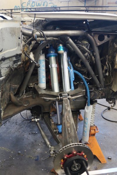

    I had Steve switch up the fuel cell mount strap. In the next update you will see the new strap. Front kit is cycled and I will have 19" of travel. The up travel on this front kit is insane. The rear will have 29.5" of travel with my current drive shaft. If I change my driveshaft and run Race Series Bypasses I can cain another 2" of travel in the rear. Engine cross over has been mocked up and welded. Spare tires are mounted and the shocks handle the weight with ease.IMG_9292.jpg IMG_9293.jpg IMG_9294.jpg IMG_9319.jpg IMG_9320.jpg IMG_9322.jpg IMG_9323.jpg IMG_9324.jpg IMG_9325.jpg IMG_9326.jpg IMG_9327.jpg IMG_9328.jpg FullSizeRender 3.jpg FullSizeRender 7.jpg IMG_9366.jpg IMG_9367.jpg FullSizeRender 4.jpg

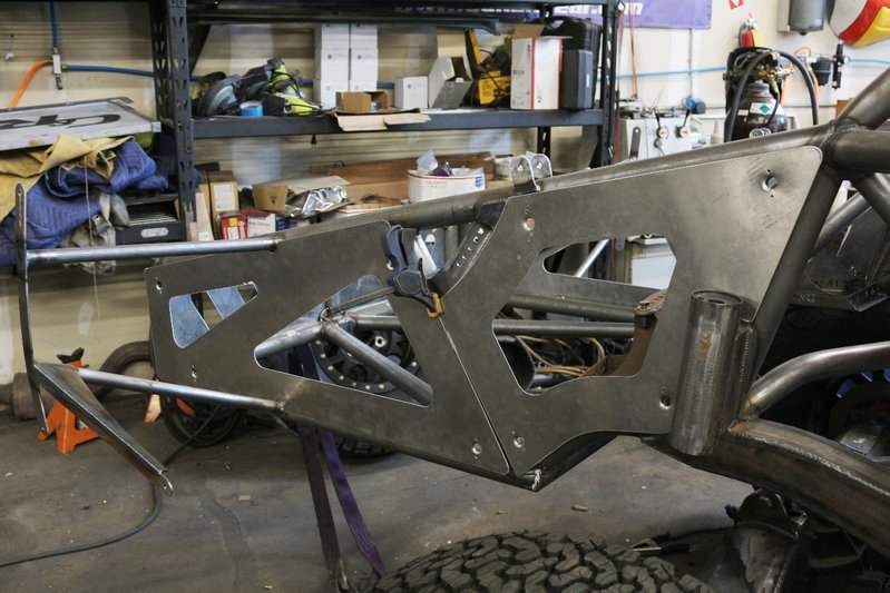

    Are you doing sliders? Or solid mounted? Thanks!

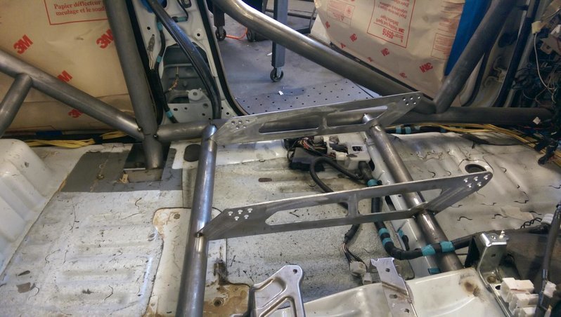

    Nice!! How do that seats mount to it? Just L brackets on all four?

    I actually do not know yet. On Monday or Tuesday I will be visiting the shop so I will ask.

    All suspension seats just have four small tabs for 3/8" bolt so the seat just bolts to those long tabs on those tubes/

    Bingo. That is correct. Just now remembered how the seats have tabs on them already.

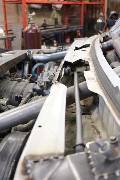

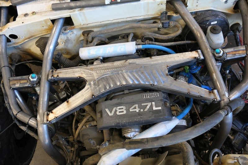

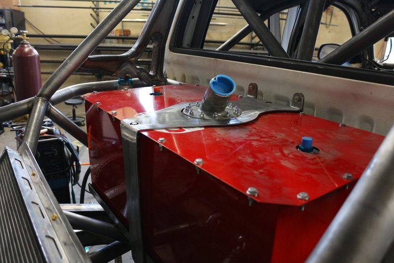

    Inner fender well had to be cut out. New fuel cell strap mounted, and the engine cross brace is done.

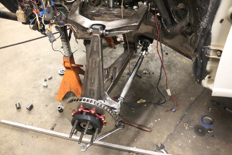

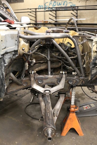

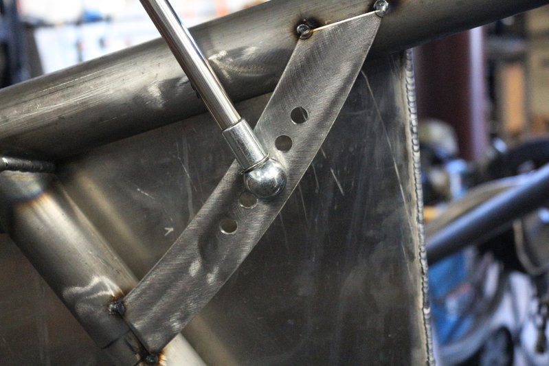

    Windshield Wipers are a go! Aluminum panels are pretty much done. Waiting on sway bar arms atm. Possible tear down next week and paint.
