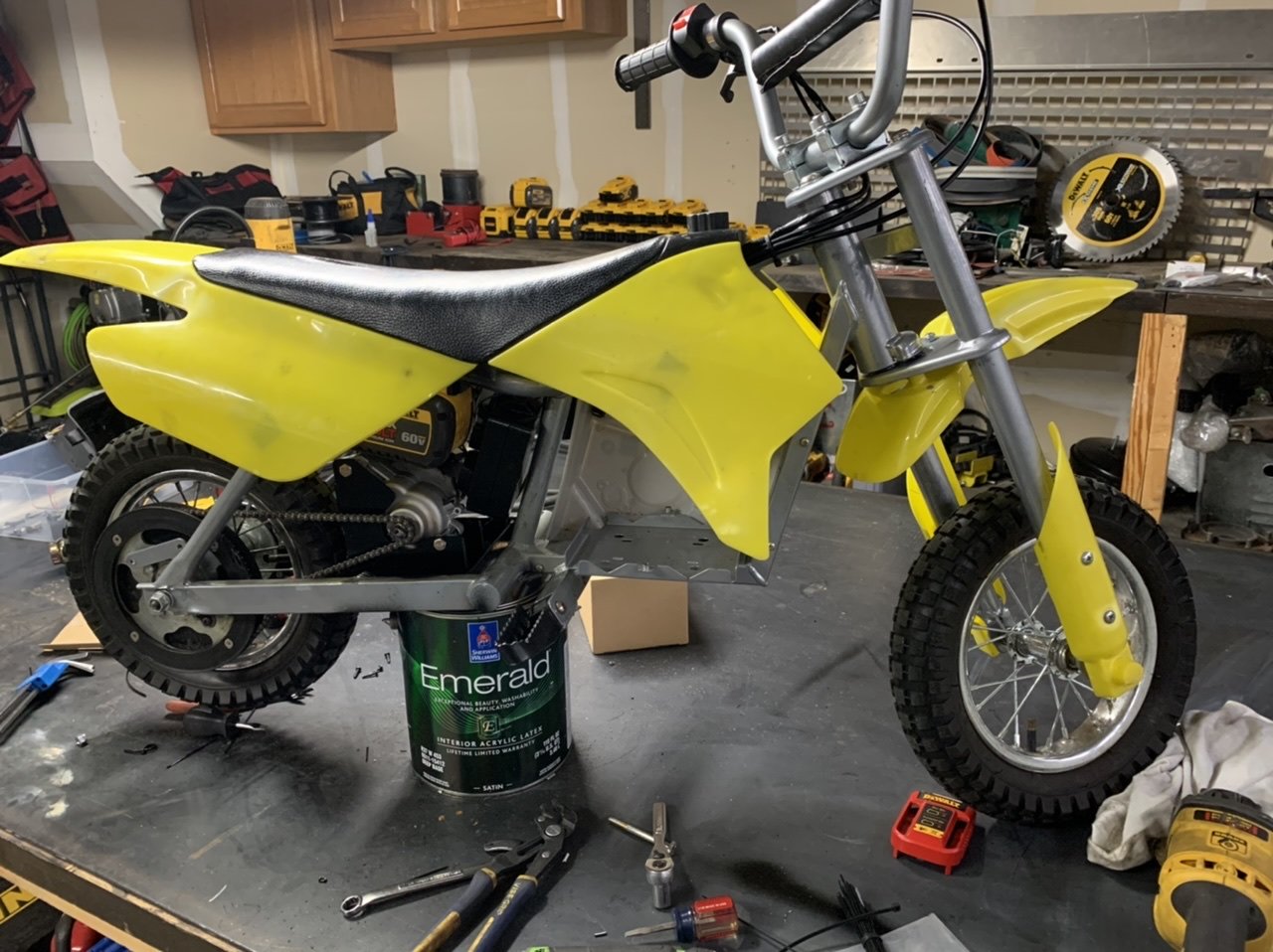

    But I made a Franken-bike. I present the Dewalt Cordless Dirt Bike.
    This a mashup of a MX350 Razor dirt bike and a 40v Dewalt Chainsaw. The motor and all electronics are out of the DW chainsaw.
    It does about 30mph with 175# on it.

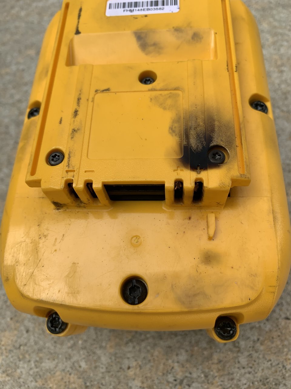

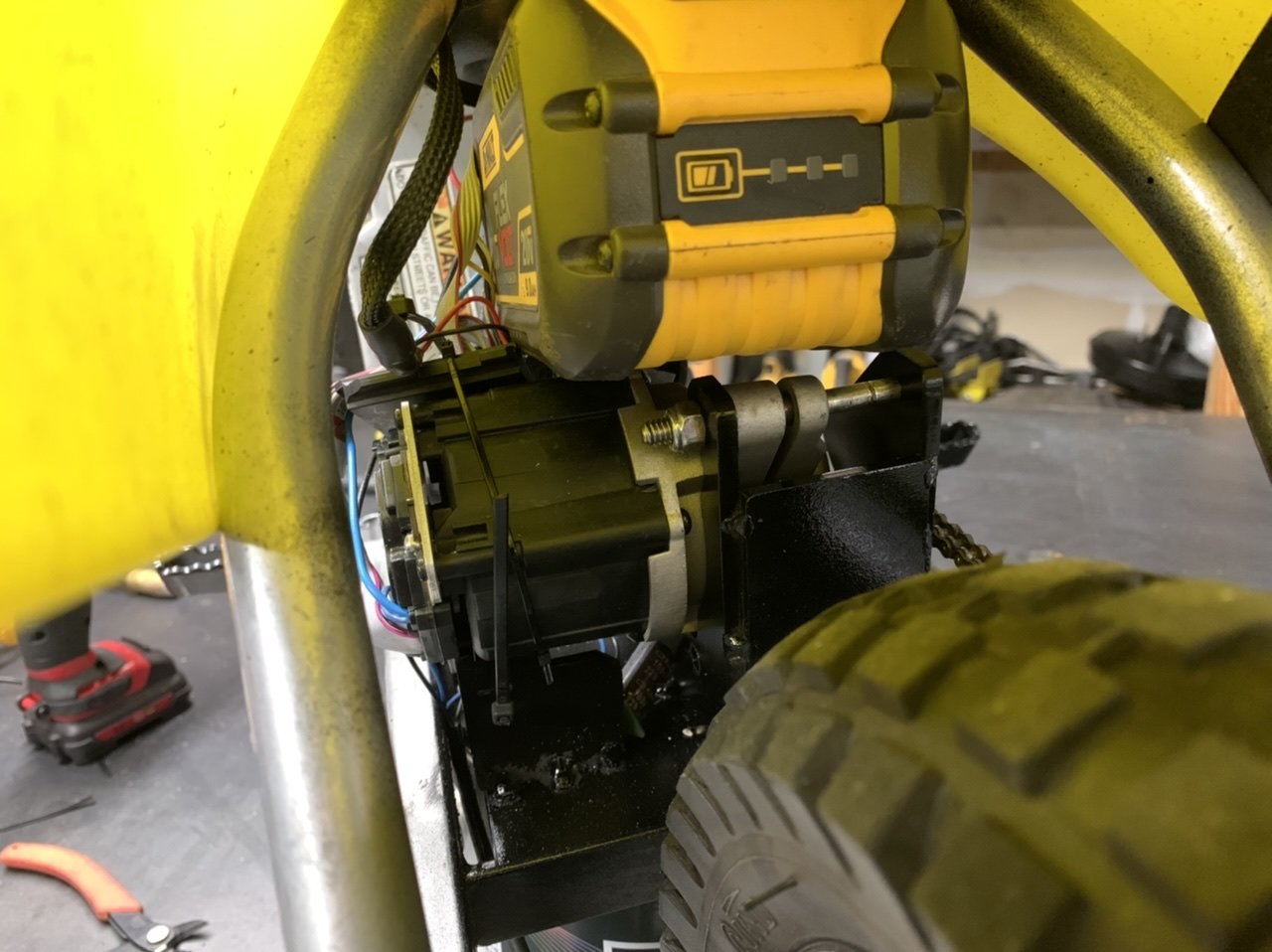

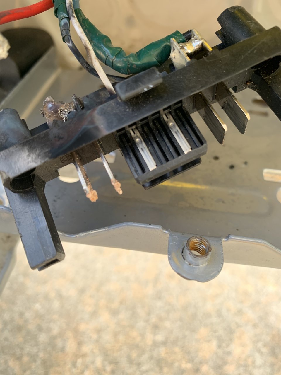

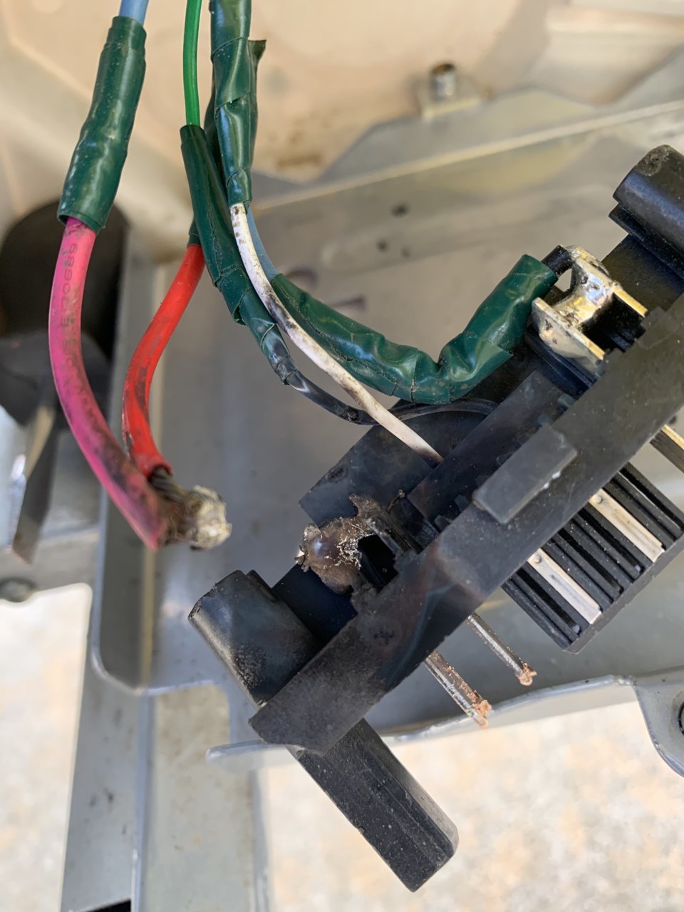

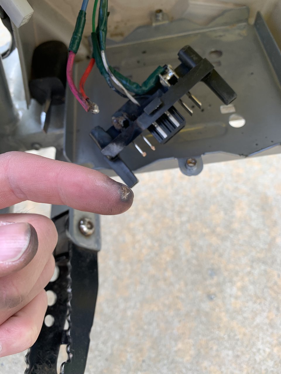

    Had a bit of an issue today.
    770F9094-44BE-4517-AAEF-6B42F4AE461E.jpg 9B108129-2F8D-4BAC-8899-5E556639B73A.jpg 17C2399F-602E-4B93-AA6B-3AC83495FA01.jpg 03FBB1D7-A61F-454F-9730-67A23D1D8B66.jpg
    Somehow the phases of the motor shorted together. When I connected the battery it basically turned it into a stick welder. Ruined the motor, module and two batteries. :(

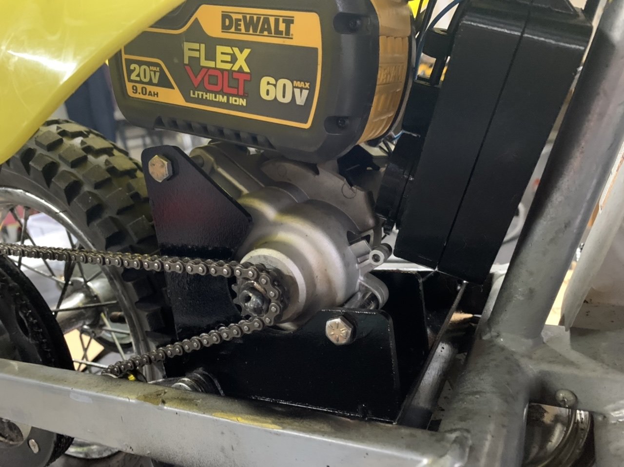

    Update: New and Improved (with some issues I’m still working out).
    The mini bike now runs on Dewalt 60V Flexvolt battery packs. More Powa. It’s got some issues I’m still trying to work though.
      • The start up isn’t quite as soft as the 40v. It wants to wheelie at take off (which is kinda cool, but read point #2).
      • There’s a current limit in the module that shuts it down when you try to accelerate, even if you try to do it gently.
      • Finally, theres an electrical braking that is an issue when you are trying to coast. As soon as you close the throttle, the electrical brake causes the chain to jump off the front sprocket. This alone wouldn’t be a huge issue, but combined with the current limit issue, the chain is constantly falling off.
    Eventually, I’ll get it sorted out so it runs a bit smoother but for now its working well enough.
