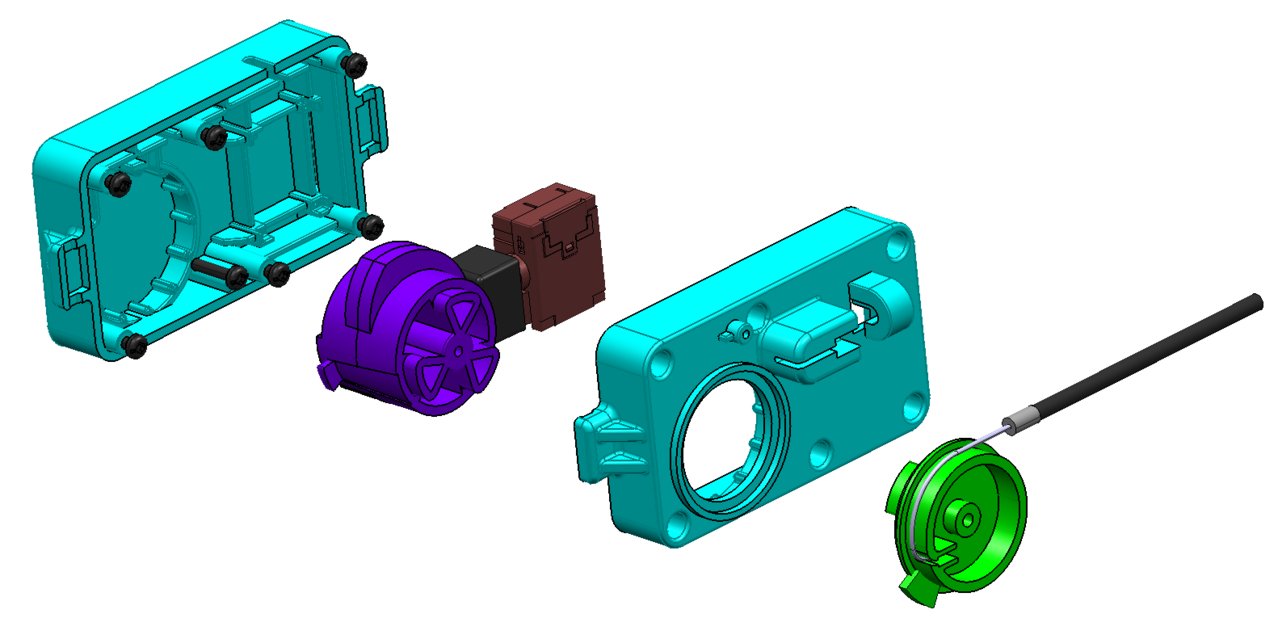

    Sweet build! I'll be curious to see what you do for the current and braking issue. I may bug you for those plans in the future. I've been wanting to build something for my oldest.

    I bought a cheap cable throttle off Amazon. Then I designed and 3D printed a “switch box” that holds the switch and a cam. The cam is rotated by the cable and actuates the switch. I’ll post pictures in a little bit.
