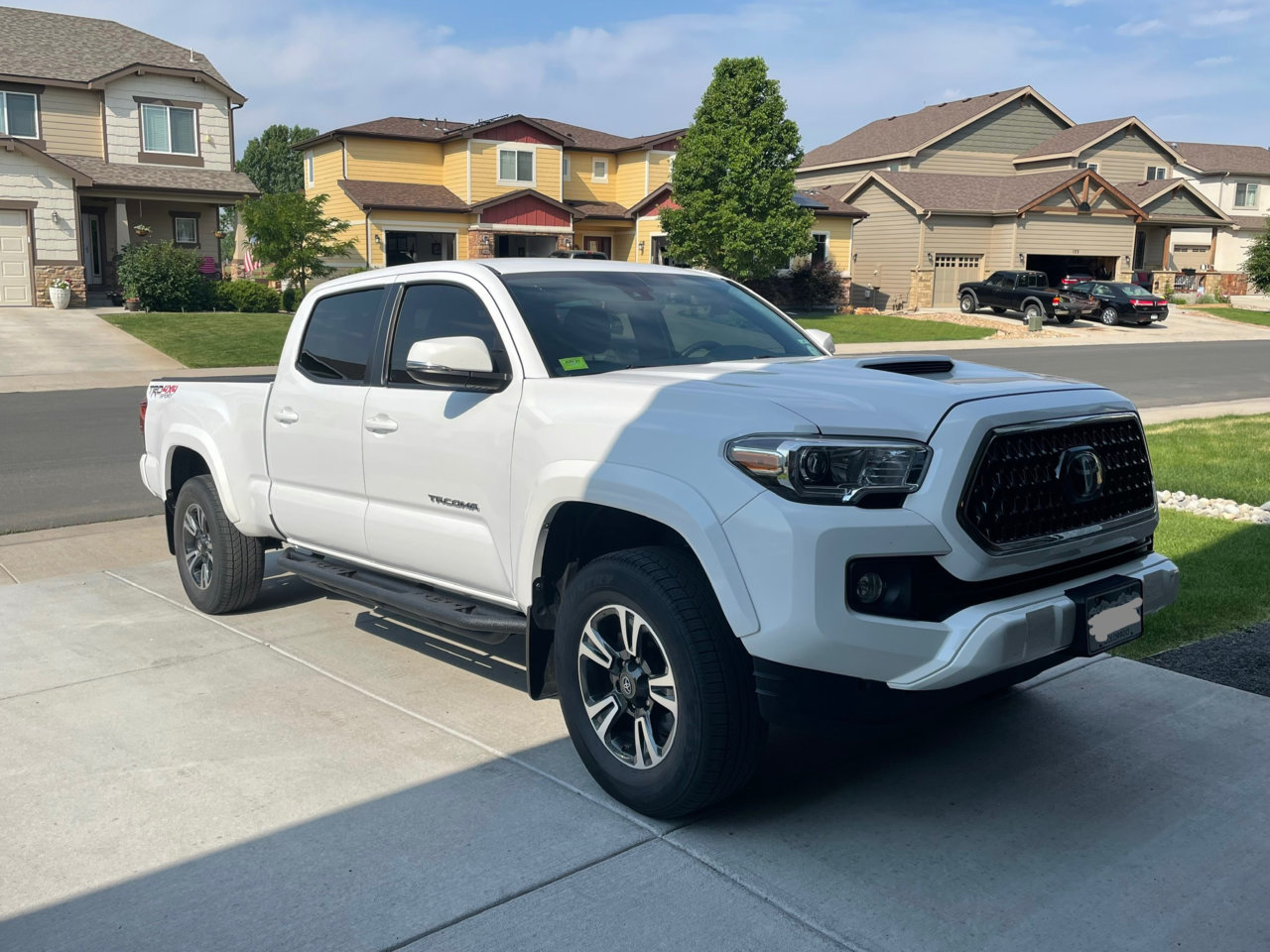

    Here's my rig as it currently sits:

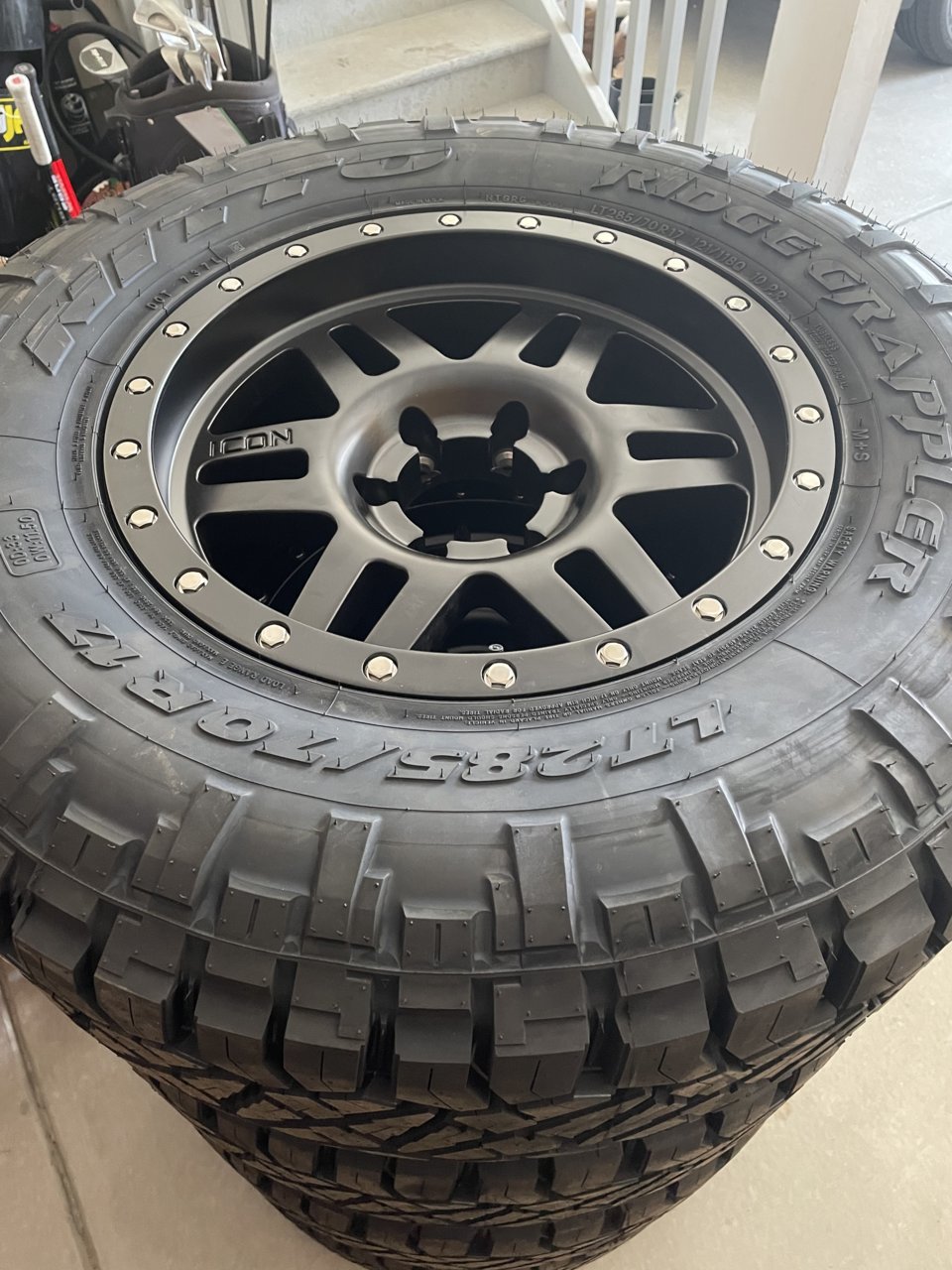

    :rolleyes::rolleyes::rolleyes:Got some goodies in the garage this week:
    0211BCC2-375A-4541-A93D-9616C3BB1EBD.jpg EA62191D-95FB-418E-9C62-FBC7BDB9A1E1.jpg
    I’ll be doing the CMC next week before installing the lift and wheels.
    I also bought a new grill, but feeling too lazy to take it out of the box and snap a picture :rolleyes:
    I live in Colorado so I got to pick up my stuff directly at Toytec and see their digs.. pretty cool operation down there in Denver.
    Anyway, I will update here once it’s all on. I’m looking ahead to how to build out the bed… might start with some bed reinforcement as a simple first step?

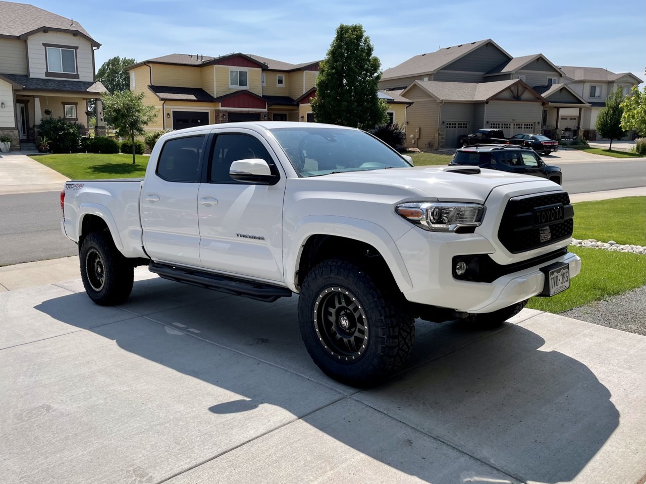

    Here’s the result of a Saturday in the garage:
    Lift details:
    Toytec Boss 2.0 Aluma series full lift
    TC UCA’s
    Deaver rear MD leaf packs
    Carrier bearing drop brackets
    Wheels/Tires:
    Icon Six Speed - Satin black
    Nitto Ridge Grappler - 285/70/17
    I did the CMC as well, but I think I still need to knock down the punch welds - I’m rubbing a bit on the cab side. I’ll wait until after my alignment early this week to start planning what cutting/shaping needs to happen.
    Also installed the TRD pro grill. I purchased amber LED inserts as well, but haven’t installed those yet.
    Next up is either going to be the needle bearing replacement (didn’t have the new bushing while doing this install), or I’ll leave that for the time being and start planning how we want to build the bed of the truck for weekend camping. Thinking extended height topper with a platform and cool drawer system. But maybe not since I still take the dirt bike up to the trails a few times a month. Still playing with ideas :)

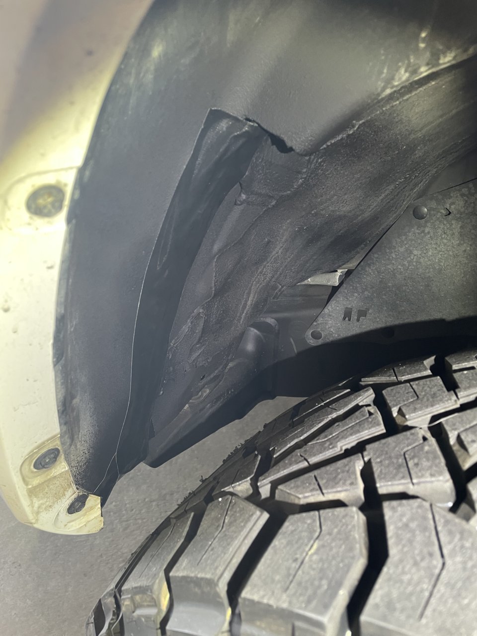

    Got the alignment done and then trimmed up the fender liner, knocked down the pinch weld, and sprayed with undercoating. I used gorilla tape to seal up the seam between the remaining liner and the flattened weld. Seems to have eliminated the rubbing altogether so far. C46AD009-C455-4D6E-8686-18AE0EED672E.jpg
