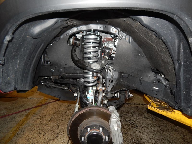

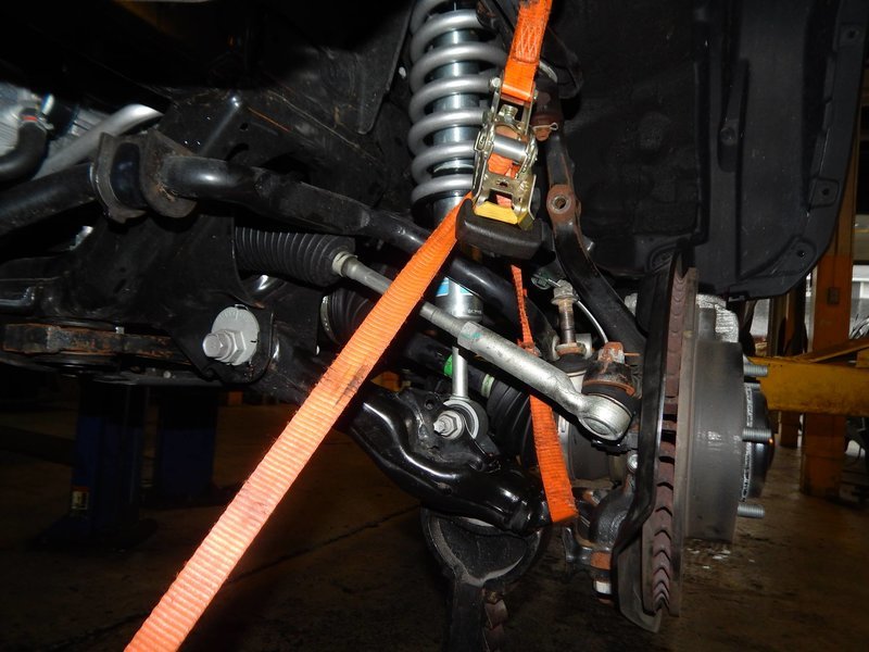

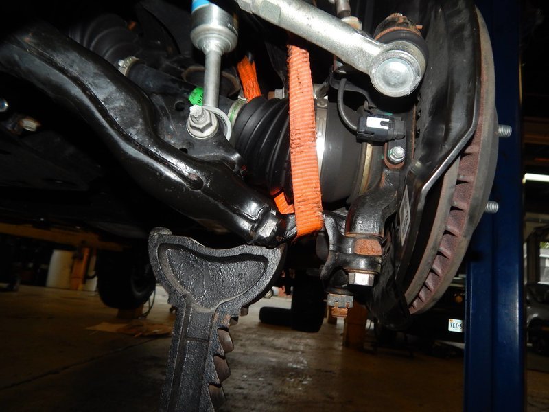

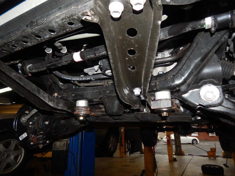

    now its time to connect the lower control arm and ball joints back to the spindle
    **(kinda pain in the butt, hardest part about this lift but its do able)***
    so i used the weight of the truck and and a jack stand to push the control arm up
    then a ratchet strap to pull the UCA and spindle down to bolt up the ball joint - 19mm
    ****now is a good time to tighten up the lower shock bolt with the weight of the truck on the new suspension*****

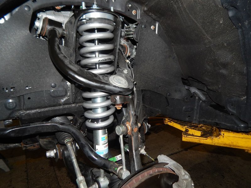

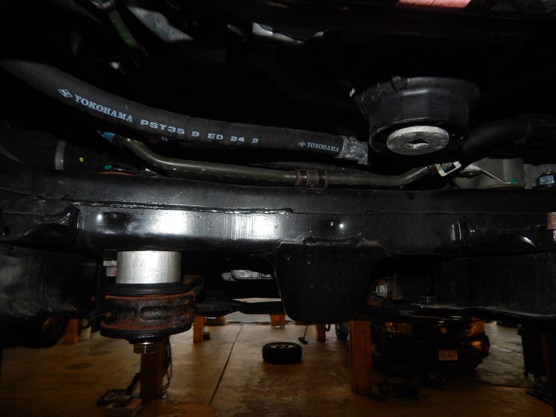

    then bolt up the swap bar back in place,

    now with the suspension all finished and tightened up
    ***dont forget to tighten and torque down everything***
    Lower control arms, ball joints, upper & lower shocks, and swap bar

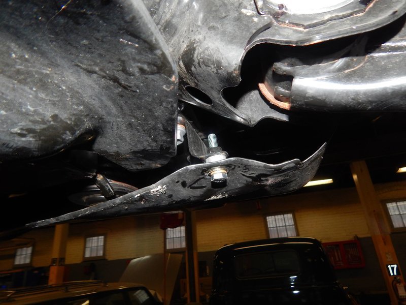

    now for the Diff drop, its pretty straight forward, unbolt the 2 big bolts, pull the diff down a litte
    slid in them big aluminum spacers and bolted them down. easy peasy

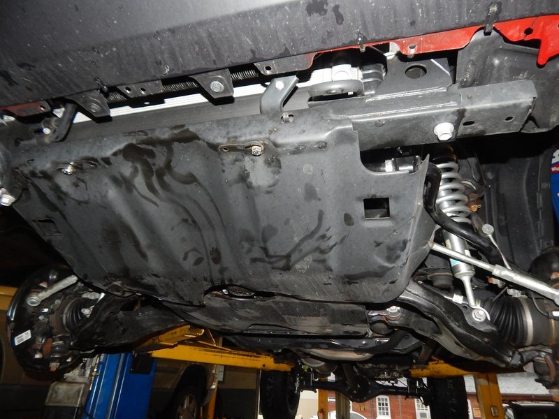

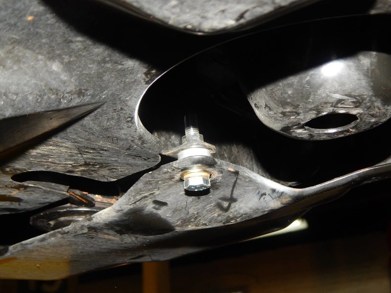

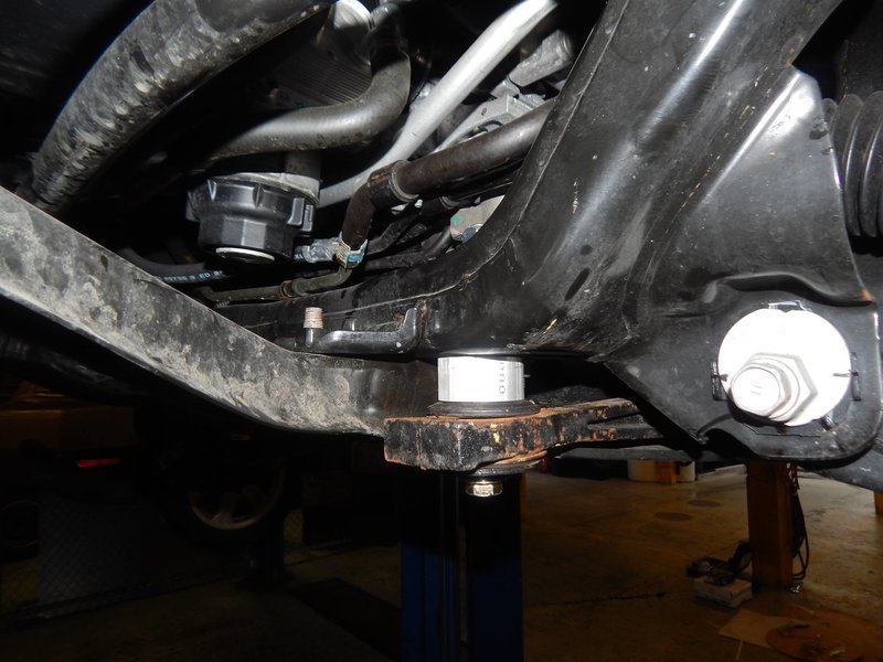

    then i bolted up the skid plate using the new hardware and the spacers so that the skid plate would clear the diff drop - 12mm

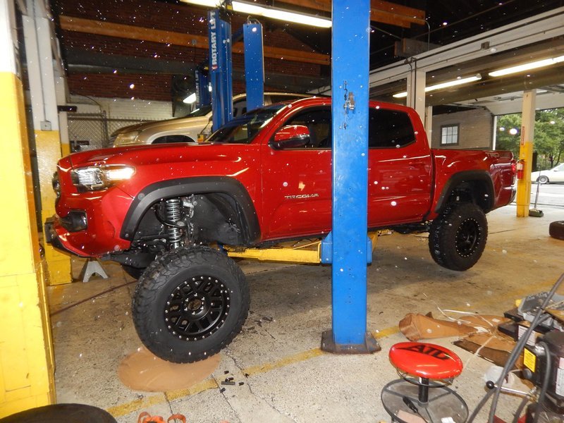

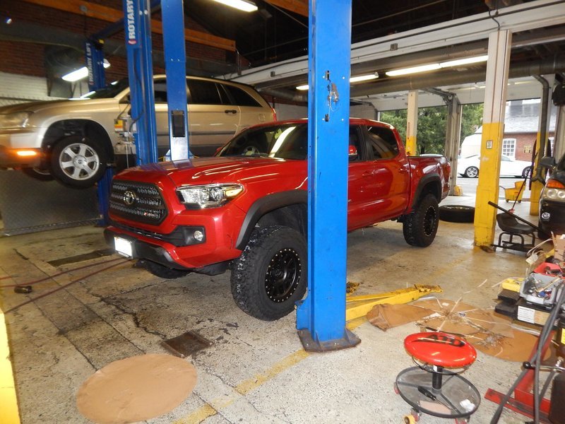

    and she's all about done!!! just need to mount up the new wheels and she's ready to roll
    that down travel is crazy!!!!!!
    ****kidding the tire isnt mounted yet**

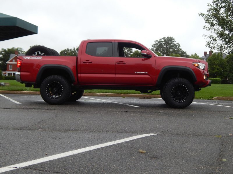

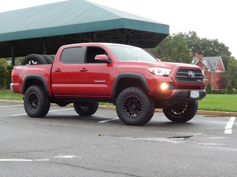

    and now i got the poser shots!!! and the lift is finished
    wasnt too hard at all, i'd say i spent about 4 hours on the lift
