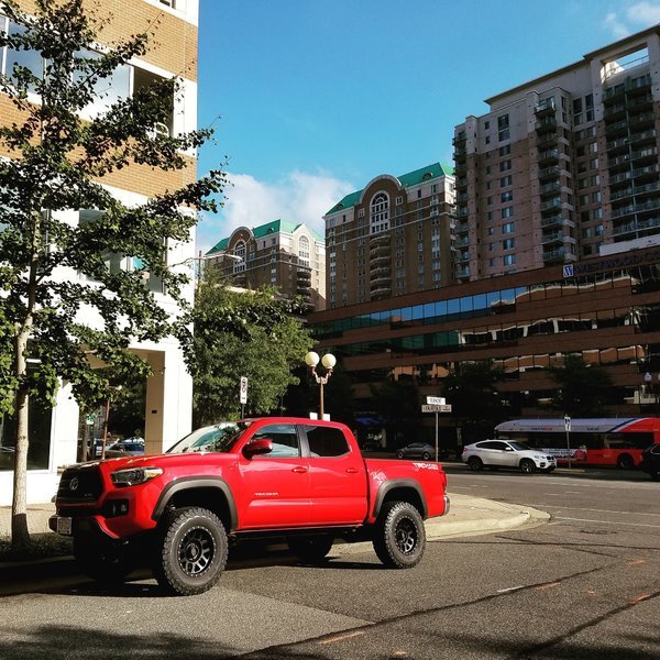

    I was stationed at the pentagon as well with office at Myer. I just recognized the auto shop & parade field.

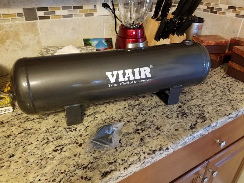

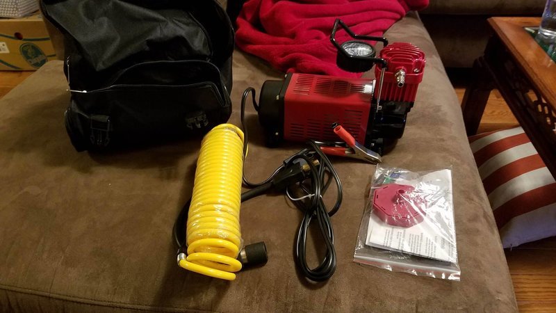

    so i plan to run an On Board Air system with a 2.5 gallon tank, the Compressor came in the other day and the tank should be in today and then ill see how i want to route everything
    but i bought this Master Flow Tsunami Air Compressor (The famous china made MV-50).
    i went with this compressor because they're dirt cheap and really great. i've been running my other one in my F250 for over 3 years now and wont die, it's been outside, no air filter, no maintenance and it keeps pumping air up to 120psi no problem, so i'm more then sold on them, no reason to buy an expensive ARB or Viair when this $45 one can out do them
    but i do plan to do a couple mods to the compressor to improve its reliability and air flow
    i bought a 2.5 Gallon Viair Tank that i plan to mount above the rear axle between the frame rails
    once i get the compressor and tank mounted that's when i will figure out where i want to run my wires and air lines, but i want air lines running to front and rear of the truck for sure

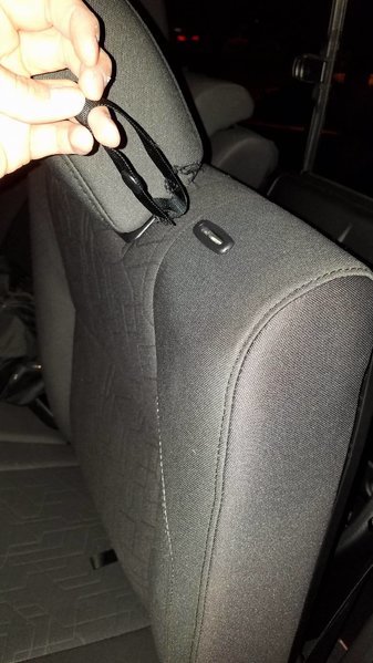

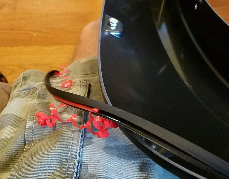

    this morning i went to put my new compressor behind the back seat and pulled on the strap for the seat and this happened..............
    i've only pulled on the strap a couple times to bet behind the seat sense i bought it
    does anyone know if this is covered by warranty?

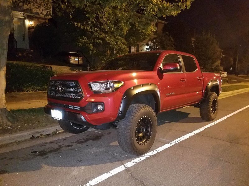

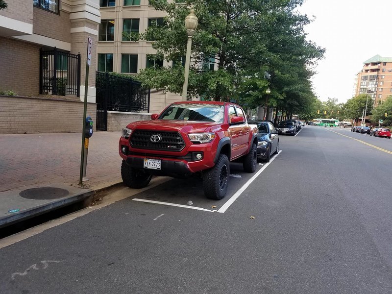

    and just cause.
    i was out driving around the city yesterday and she looked too good not to take some pictures

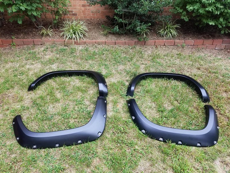

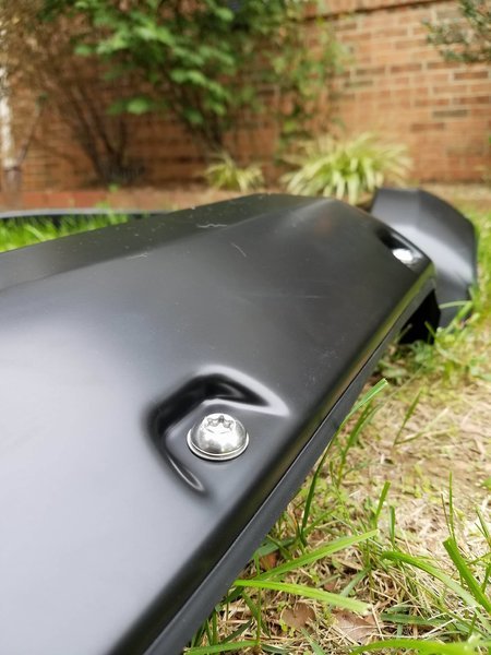

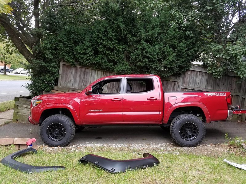

    so check out what showed up this weekend

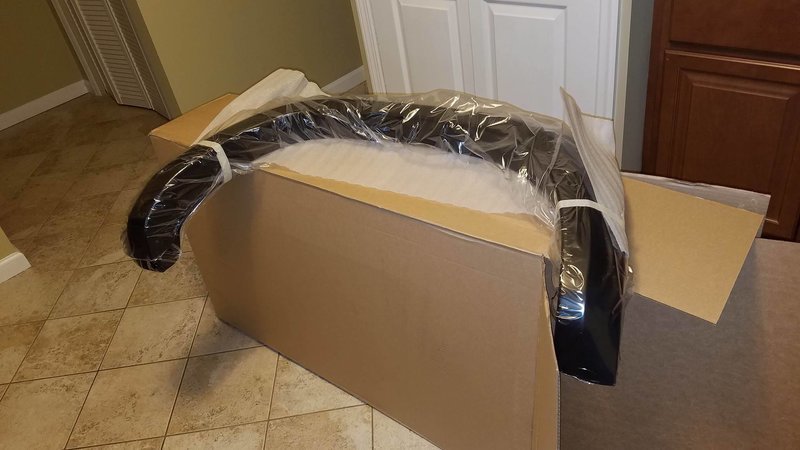

    Bushwacker fender flares
    i started by putting on the little nuts and bolts on the new fenders and the rubber stripping around them, thats what took the longest, prepping the new ones to go on
    Paul123 likes this.

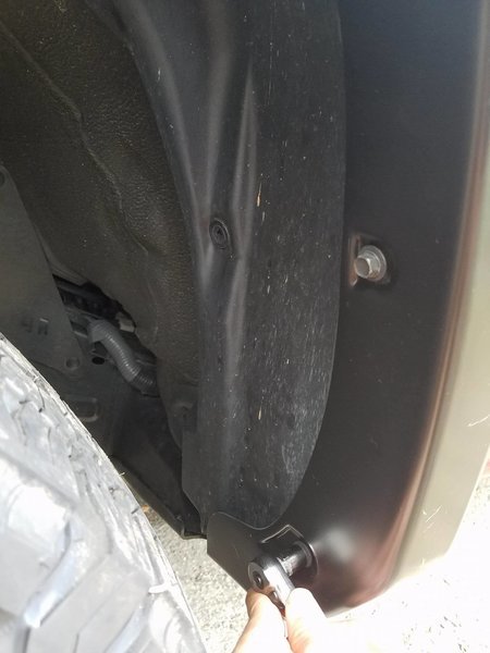

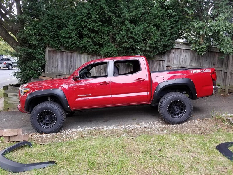

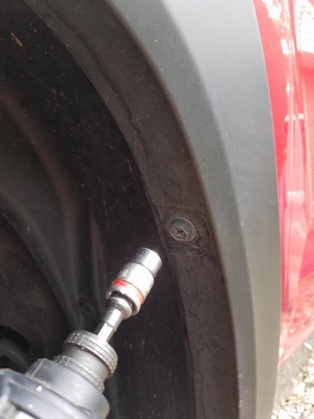

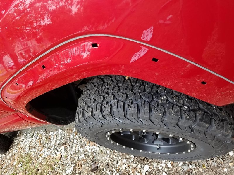

    once i got the new fenders ready to be installed, it was time to remove the factory ones
    i started by unbolting all the screws on the bottom of them with a 10mm
    then pulled them off from one corner of the fender working my way up and around to the other side of the fender
    **the front fenders do have a couple clips that clip into the front bumper so just watch so those**
    other then that theyll pop off pretty easy

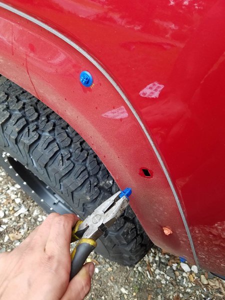

    then Remove the little Blue and orange clips
    **the blues come out very easy, but the orange ones are a pain in the asss***
    the factory fenders are held on with double sided sticky tape too, i didnt even bother pulling it off the truck sense you wont see it
  11. Oct 11, 2016 at 6:21 AM
    #51
    zackmicf
    zackmicf [OP] Well-Known Member
    Sep 22, 2016
    #197954
    86
    Zachary
    2016 Tacoma TRD Off Raod
    3" Toytec lift on BFG KO2 285s w/ 17" Method Mesh Wheels

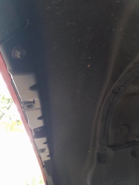

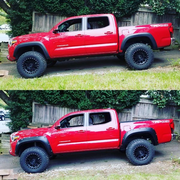

    now for the New Fenders
    using the new hardware, install the new bracket on the front
    then all you do is pretty much bolt the new fenders in place
    no drilling or cutting is required,
    the bolts on the fenders are just for looks,
    its held in place but the factory mounting holes
    these Fenders stick out 1.5" out farther then the factory ones,
    so my wheels look a little sucked in now that the fenders hang out farther then them
    but thats why i bought 1.25" spacers so the tires would line up with the new fenders
  12. Oct 11, 2016 at 6:23 AM

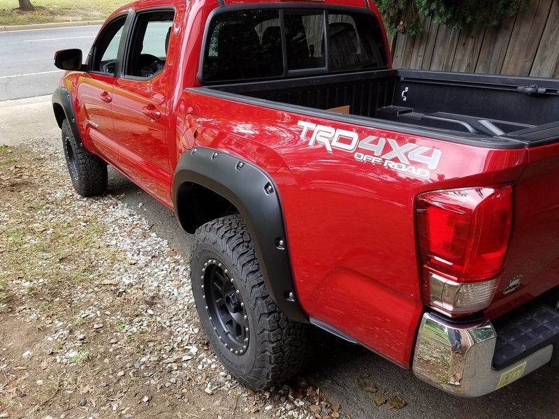

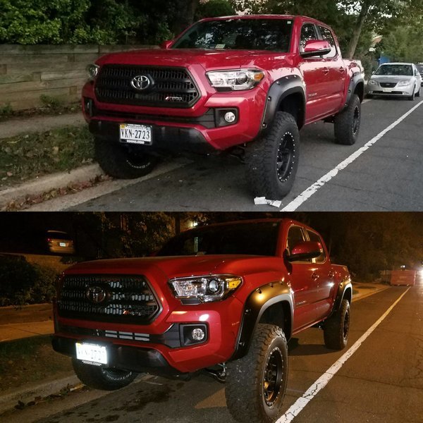

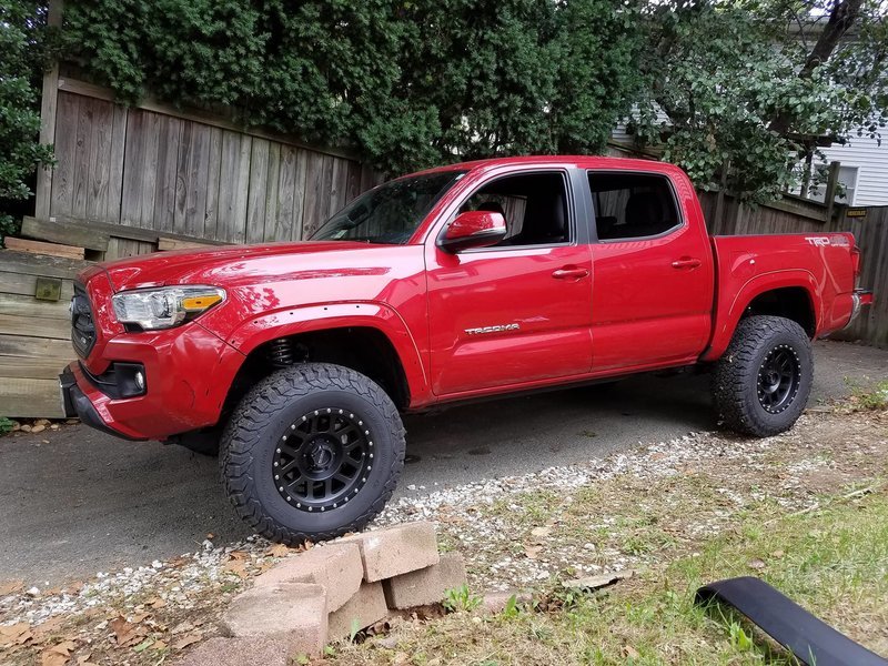

    heres a good before and after pic
    i ended up selling my factory fenders to a local guy for $200 too!

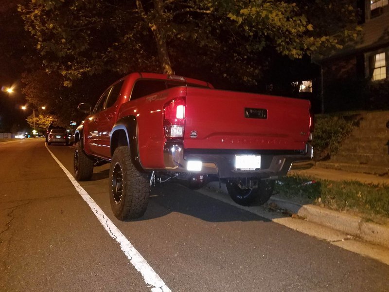

    you can even see that booty in the mirrors

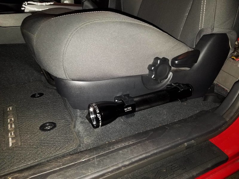

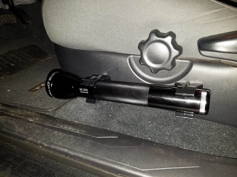

    i did the Maglite "Mod" too!! its actually pretty handy! ive already used it a couple times this weekend,
    this is the first Maglite ive owned and i love it
    i got the ML300L 3 D batteries

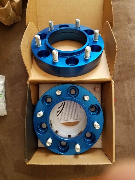

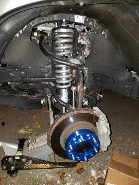

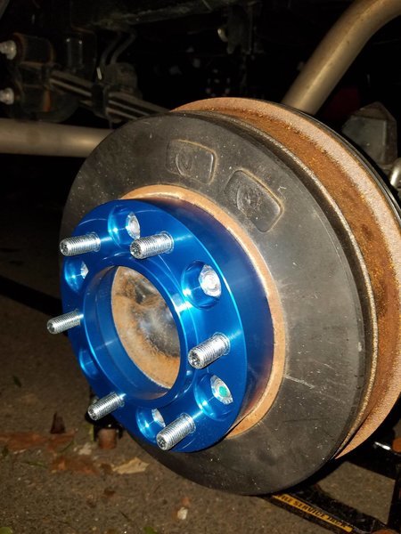

    my Spacer came in yesterday too!!!!
    i went with the Spidertrax 1.25" spacers and i love the blue
    i got them off Amazon for $200 Shipped
    they defiantly make the truck look great with the fenders
    just make sure you locktight the heck out them
    theres a before and after pic in there too, ill try to get some pics today
