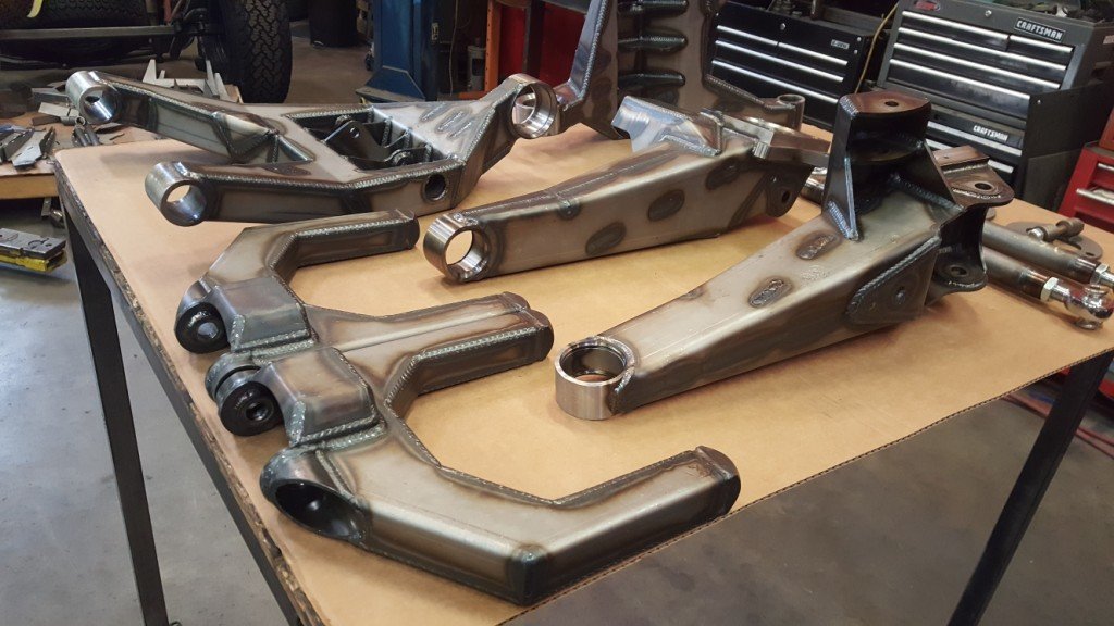

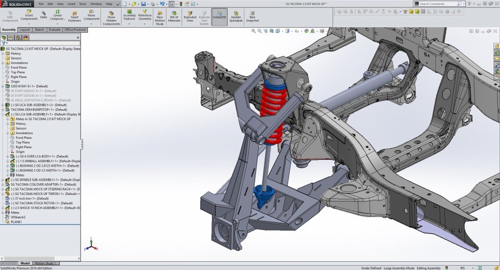

    Can someone explain to me the upper control arms. Have not seen this type before
  5. Nov 9, 2017 at 4:32 PM
    #185
    MrCrowntown
    MrCrowntown Well-Known Member
    Aug 7, 2016
    #193980
    2,350
    Alyn
    Ky
    06 Extended cab Prerunner 2.7
    Dirt King Mid travel with King 2.5 coilovers, Baja Kits chase SUA with 14in fox smoothies under custom hangars.
    Double sheer for strength, and the uniball is mounted horizontal to allow for completely free motion. No restrictions in range that come with ball joints and vertically nounted uniballs.
    It's level 9000 basically

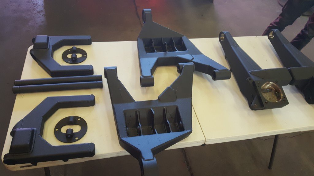

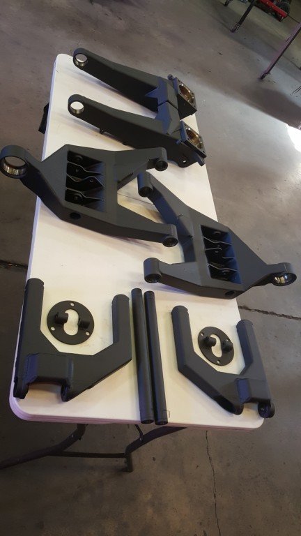

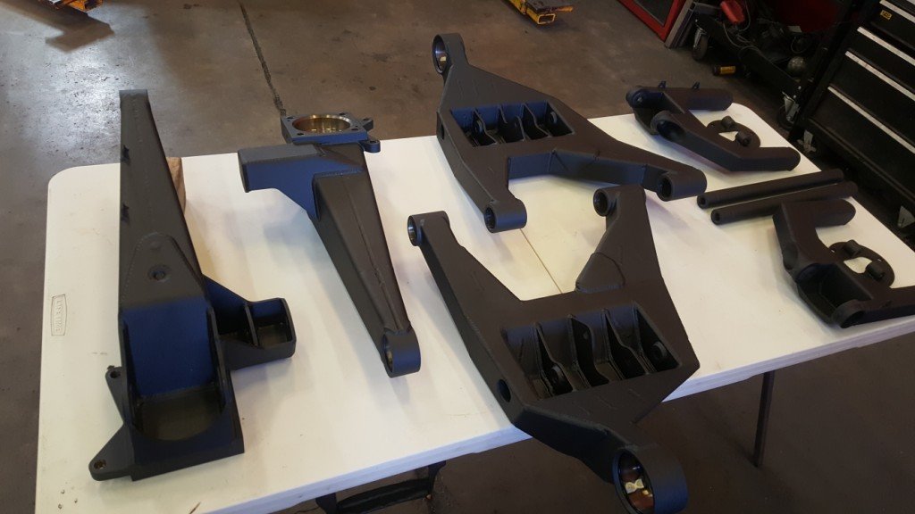

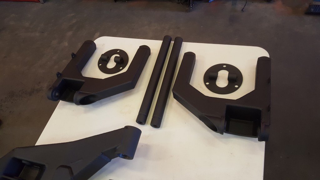

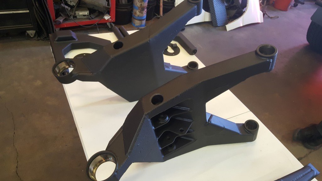

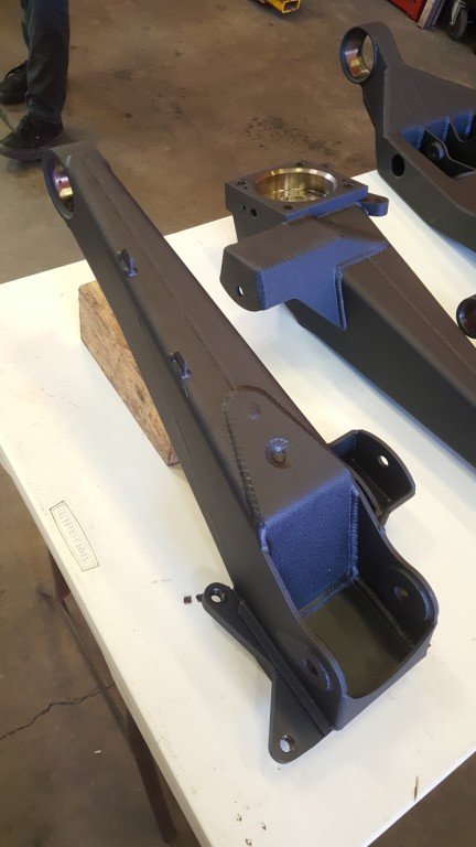

    Back from powder coat.

    GOALS! ​
