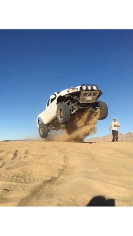

    DTFtacoma
    DTFtacoma [OP] Dezert Toy Fabrication Vendor
    Mar 5, 2009
    #14364
    6,953
    Anthony
    Santa Maria, CA
    06 PreRunner D-cab
    DTF LT front & rear
    ocherp, Martyinco, ChadsPride and 2 others like this.
