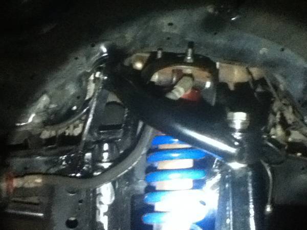

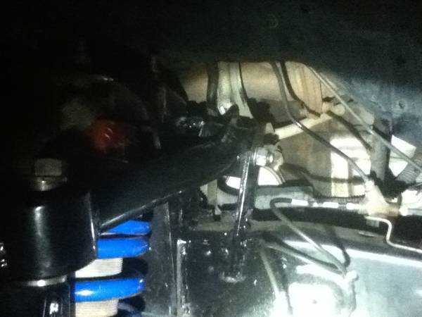

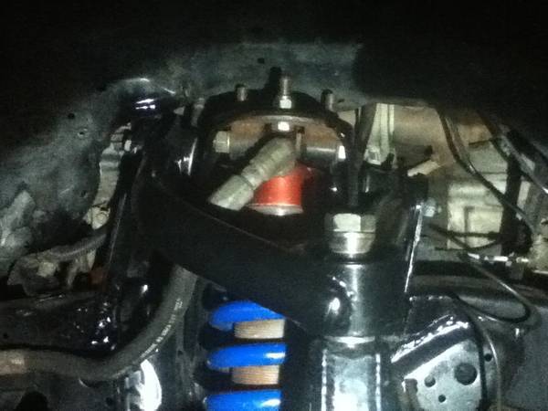

    Already on it;) Had yesterday off and got the motivation to finally do the coil-bucket gussets/double sheer uca's. sorry bout the shitty pics.
    Left to do:
    -stronger bed supports
    -weld/plate my cracked core support
  2. Aug 3, 2013 at 12:23 PM
    #582
    tacokid09
    tacokid09 it's about the off-road miles
    Mar 5, 2011
    #52405
    7,067
    Brian
    San Luis Obispo, CA
    2010 Tundra
    get on it :p
    hahaha just kiidding. little more piece of mind with those on huh?

    ya definitely makes me feel a little more confident in my truck after every gusset i've added

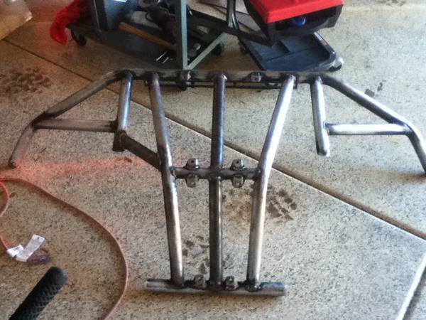

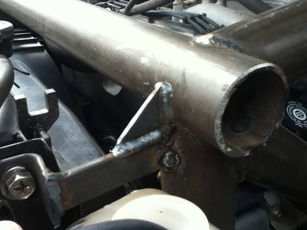

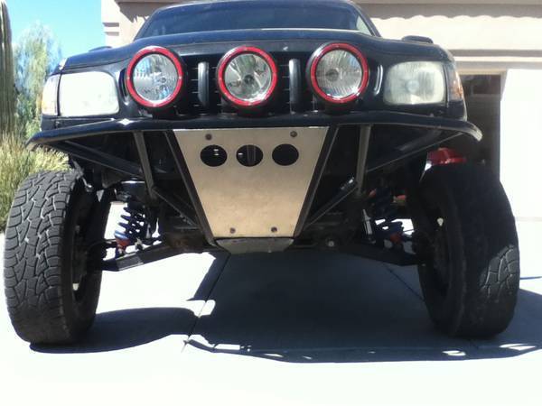

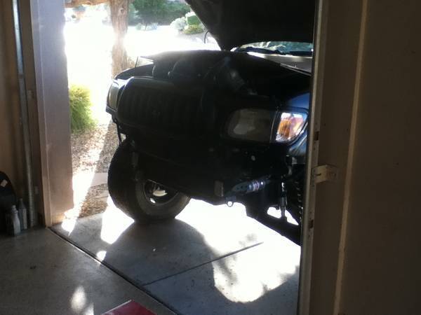

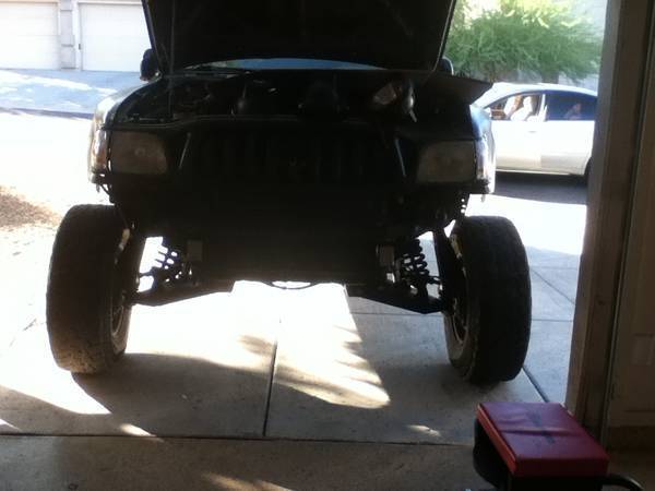

    so i solved the cracked core support issue, wanted to make sure it didnt happen again so went a little over kill... engine cage
    Cage has tabs to hold up the radiator to relieve the weight on the front core support. Also goes down and supports the coil bucket. Tubes run up near the cab so they are ready to add onto the cab cage when i get the money. Very happy with how it came out. front end should be much more solid now. Credit goes to Sean over at AZdirtworks. Does great work for a great price! and quick!

    Nice. Since you have fully fabbed spindles. You can probably bump off the upper spindle bolt. Connect some tubes to the engine cage get a 2" Bump.

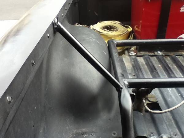

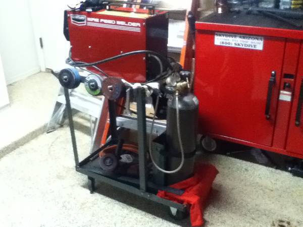

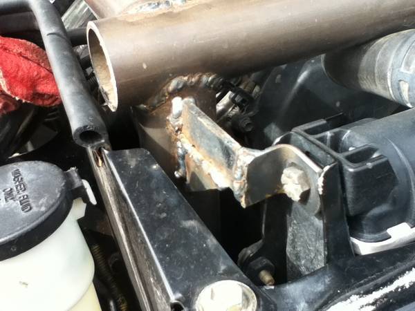

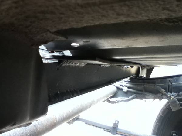

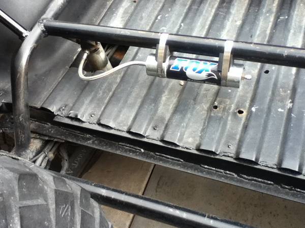

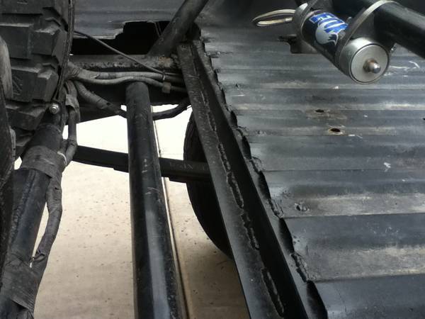

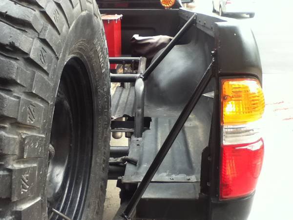

    Some minor updates:
    -Got a mig gas welder
    -gusseted radiator tabs
    -made a cross brace to keep my bed from bending in the middle
    -Added more bedside supports
    Welding cart set-up.

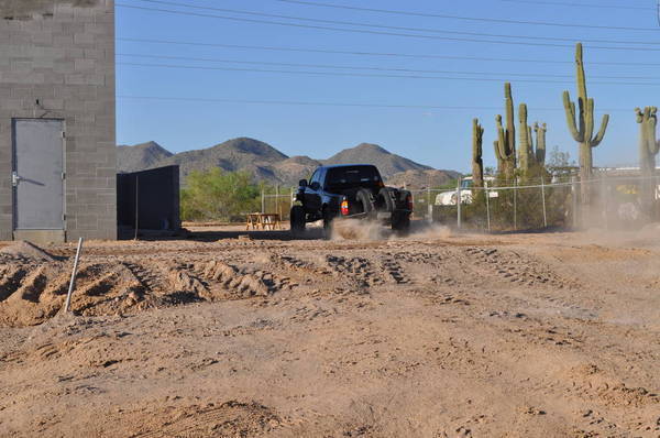

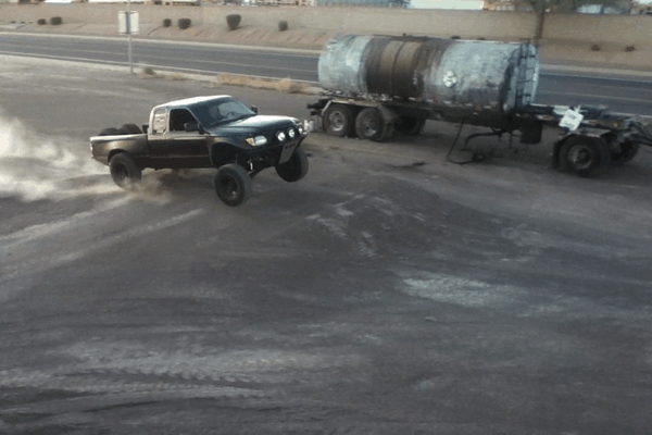

    Had a little night run at sycamore last night. Little jump we took some vid/pics of.

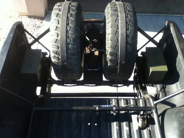

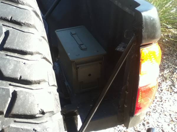

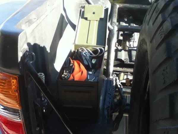

    Got some ammo cans dirt cheap and mounted them up in the bed.

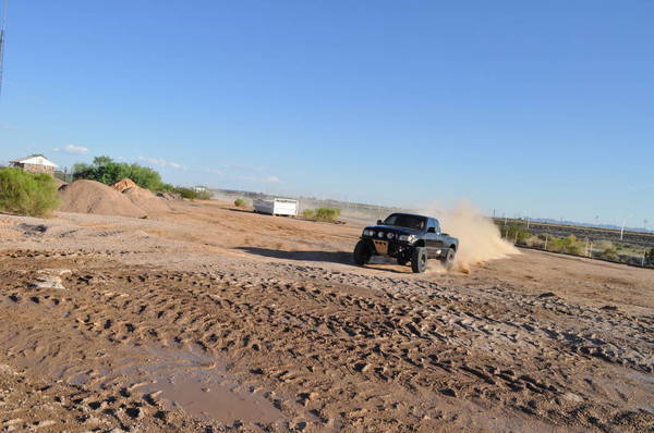

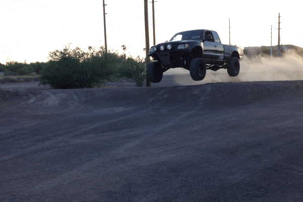

    Some Jump shots:

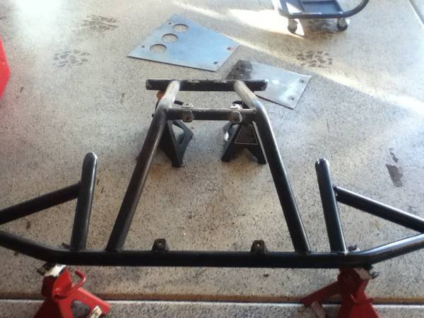

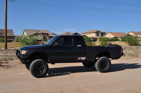

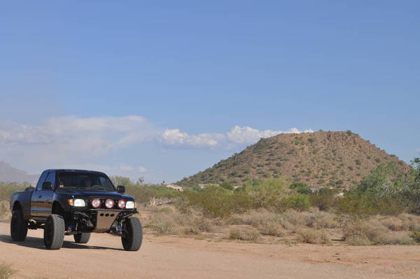

    I have noticed for quite some time that my bumper has slowly been creeping closer and closer to the bottom of my radiator. After smashing my front end a few more times, it was soo close (about 1cm) that i decided to cut it off and beef it up so it doesnt budge anymore
    Before:
    Almost finished:
    Finished:
