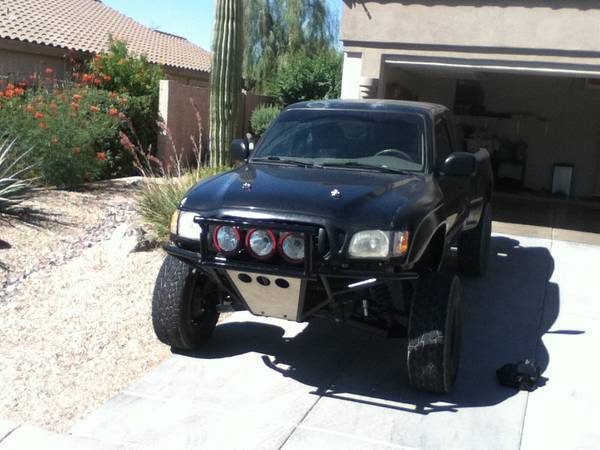

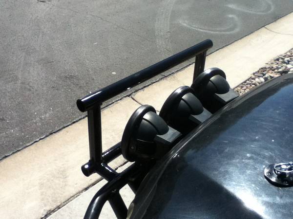

    Installed hood pins (daystar poly rubber ones) to eliminate all the movement my hood had before.
    Also got tired of my lights getting jammed back into my grill everytime i tapped anything with my front bumper. The bumper is tucked to close to the grill so the lights sit about 3/4" infront of the main tube. Solved that problem and i can finally play Trophy Truck now:D
    It looks ok imo but it serves more of a function than looks.
    Might add a tube on each side from the top tube down to the main tube for extra support, and back through the grill into my engine cage, but i need to relocate my radiator somewhere first.
