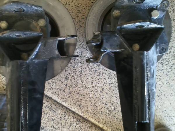

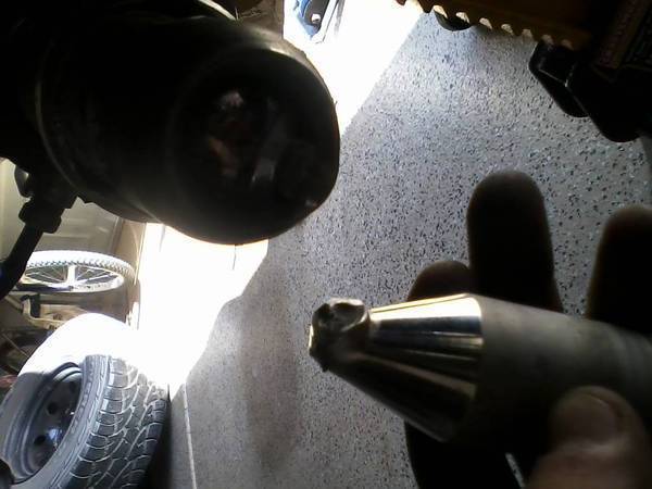

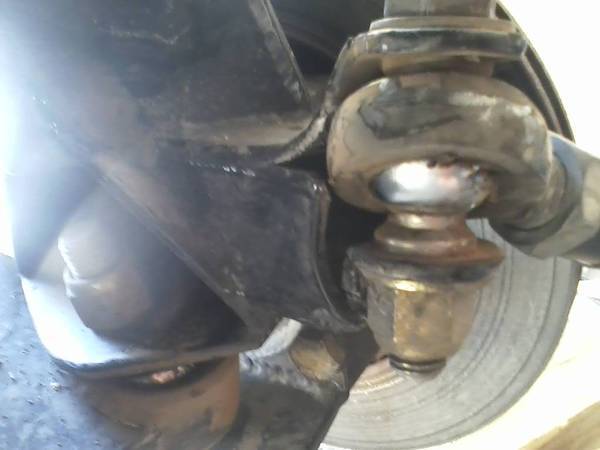

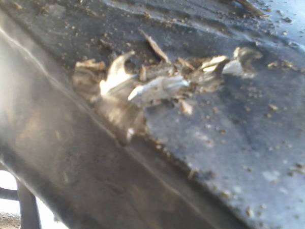

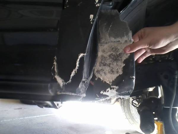

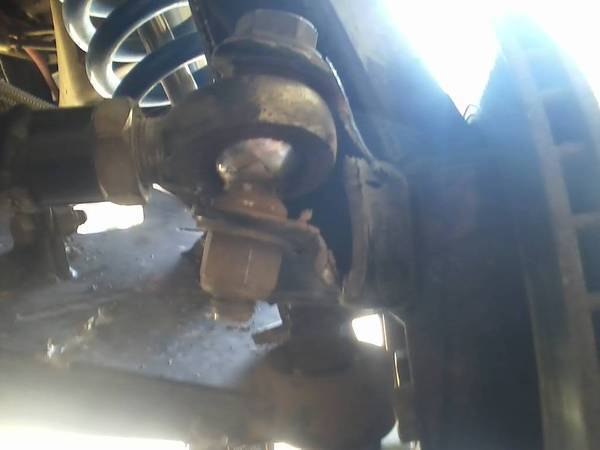

    So heres the carnage (sorry, crappy phone pics)
    Fiberglass:
    Tie rod on the spindle:
    A-arm
    Inner tie rod:
    Good spindle tie rod mount vs bad
    And got it torn apart after school, and now i gotta go to work, but noticed the passenger side mount for the steering rack is bent to shit as well:mad:
