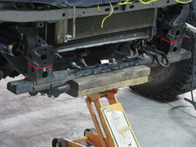

    I'm interested in the type b but I'm a little nervous about cutting the crossmember lol i cant find anything on it except that it will cause to much torque on the frame letting it twist and move.
    Anyone have a good write up on it or anything? I hate that damn thing though and don't want to keep it anyway but not sure

    Tried to find a good pic but I guess I didn't take one. But I chopped mine to the height I wanted when I did my front bumper and skids and then welded some 2" square tubing back in to be the new cross member. Cut mine right at the bottom of the front bumper mount so I gained a good amount of approach angle

    What he said ^^^^
    :sawzall::sawzall::sawzall:
    I used to weld one in on my bumper installs back in the day when I built them on the trucks. I honestly think its bit of overkill considering the bumper itself acts as a cross-member when bolted down properly.

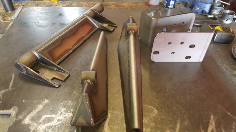

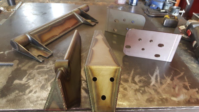

    NEW FRAME HORN DESIGN!!!
    D-rings mounts are now standard
