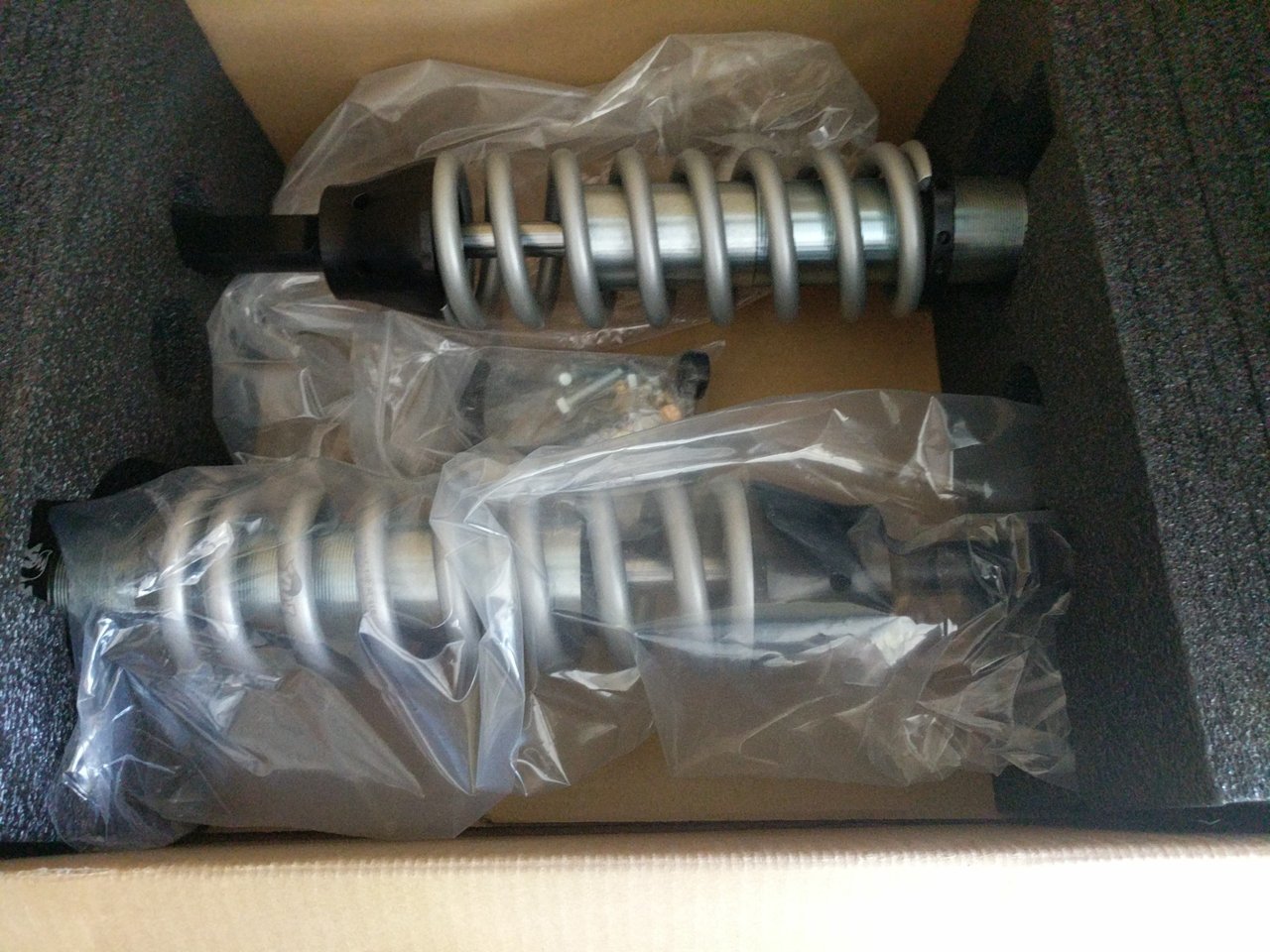

    Big day today... Anybody want to come turn a wrench with me? Ice cold beer on tap thanks to superwife's excellent birthday gift...

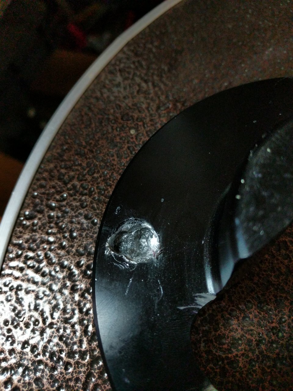

    Welp, it was going great until a bolt snapped off in the top of a coilover. After about 3 hours trying to get it out, I'm looking for a machine shop that open on weekends... Anybody know of any?
    ...Or where i could find a new top hat for a fox coilover

    Is it not a stud that can be pressed out and a new one pulled through?

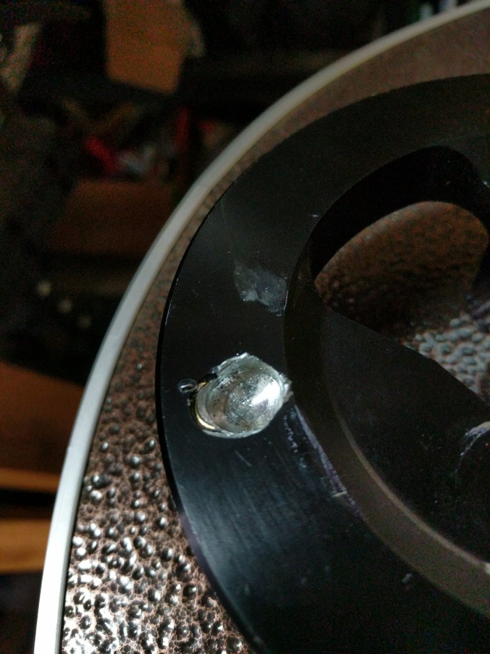

    Maybe it could have been...this is where I am now

    Ouch, good luck. If you are trying to drill through make sure and drop some oil to lubricate and leave time for things to cool down

    Well, you fucked that up good! Initially, did you cross thread it or over torque it?

    No, I had to put it together with just 2 bolts for now. I'll fix it and knock out the needle bearing, drive shaft drop, and brake lines once I get a new fox top hat.
    Yeah I sure did. Over torqued because I used the Toyota number (49) instead if the fox number (24). Then I was able to get a hold drilled all the way through the broken off bolt, but then I broke off an extractor in that hole, which none of my drill bits can handle, not even the colbalt.
