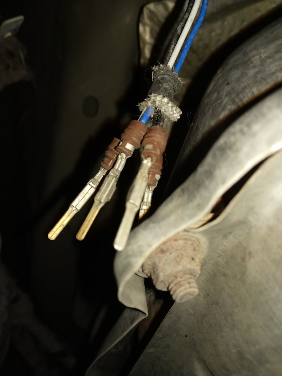

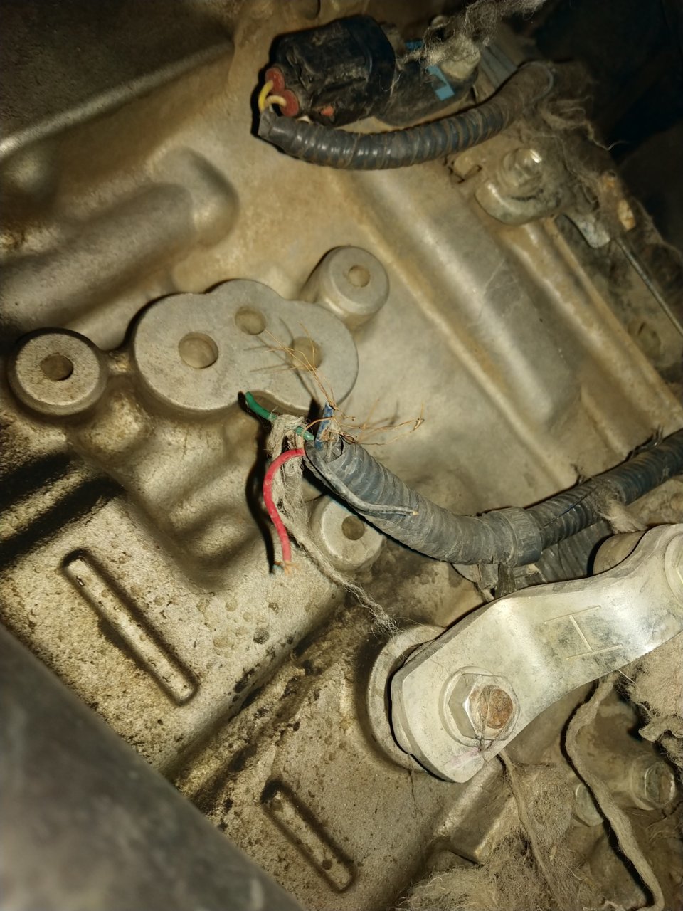

    Here are some pics.

    Missing a little info/pics here, but the exposed pins look like they could be inserted into a new plastic housing male connector if you could find the number. Are those exposed pins on the O2 sensor side and the ripped wires are on the truck harness? You should be able to find the harness side female connector from Toyota. The sensor side may be available from Toyota, but could also only come with a new sensor. Here's a link to the Toyota Wiring Harness Repair Manual (https://www.toyota-tech.eu/wire_harness_rm/RM06H0E.pdf ). There's most of the connector part numbers listed in there. You might have to look at another 3rd gen to figure out which connector you need to get since yours is missing.

    Yeah TOYOTA can fix you up. The first 5 digits of the plastic connector housing will be 90980. The wires with pins if needed are 82998. A good parts guy can look these up for you. Toyota has listings on all replacement connectors for this very issue.

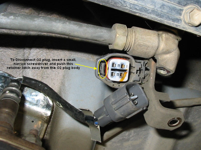

    I googled Tacoma O2 sensor plug and found the following photo, but not sure if it's what yours was.

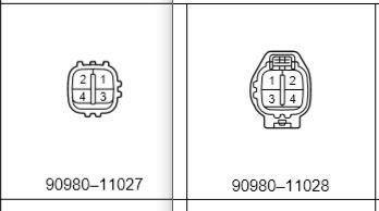

    If that is accurate, the male side would be Part Number 90980-11027. You'd just buy the plastic connector and reinsert the male pins on the O2 Sensor into the new plug. The female side, you'd need Part Number 90980-11028. This would also be an empty connector, so you need to order 4 of the female pins. 82998-12440 for pin with 160mm wire or 82998-12590 for 500mm of wire.
    Even if these weren't the same connectors from the factory, you could use these parts to fix it. But, you might run into an issue down the road if you go to replace the O2 sensor and the plug is different.
