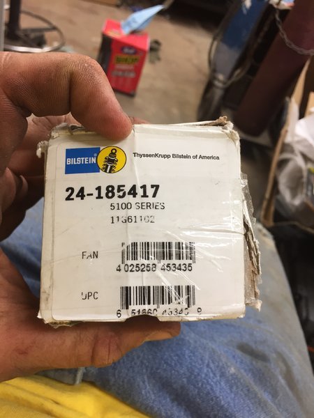

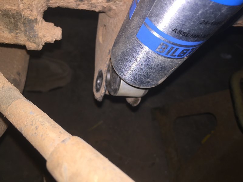

    I need help with my install of rear shock absorbers not fitting image.jpg they say on the install instruction for a Ford f159 2wd rear but I don't know f that supposed to do that. Has anyone else encountered this issue. Also if I can't get this to work can I go with out shock absorbers till I can get the right ones

    I ve seen this before.. i saw some other guys just smash out the mount to widen it.. wouldnt be my method but thats what they did.
    Are they 5160s or 5100s
    SuperBad likes this.

    I had to beat the shit out of mine to widen them up to get the lower shock mount to go in.

    Lip
    what does this refer to? I looked at the serial number on the shocks and it doesn't match the number I have on my invoice or the website? I got them sort of in there and set it down and the frame mount is riding on the shock body they are too long. Like there is no play in the shock

    The model, are they bilstein 5100 shocks or 5160 with the reservoirs?
    I have 5100s and i dont recall the shock body touch anywhere. Hmm

    I guess it's hard to explain how they are in there. The shocks are fully compressed when lower down on full weight. Maybe this are not the right ones

    It appears those are the wrong shocks. Bilstein catalog (http://www.bilsteinus.com/uploads/tx_templavoila/Bil_OffRd_Cat2011_25.pdf) shows that part number fits a 97-03 F150 with 4-5" of lift.
