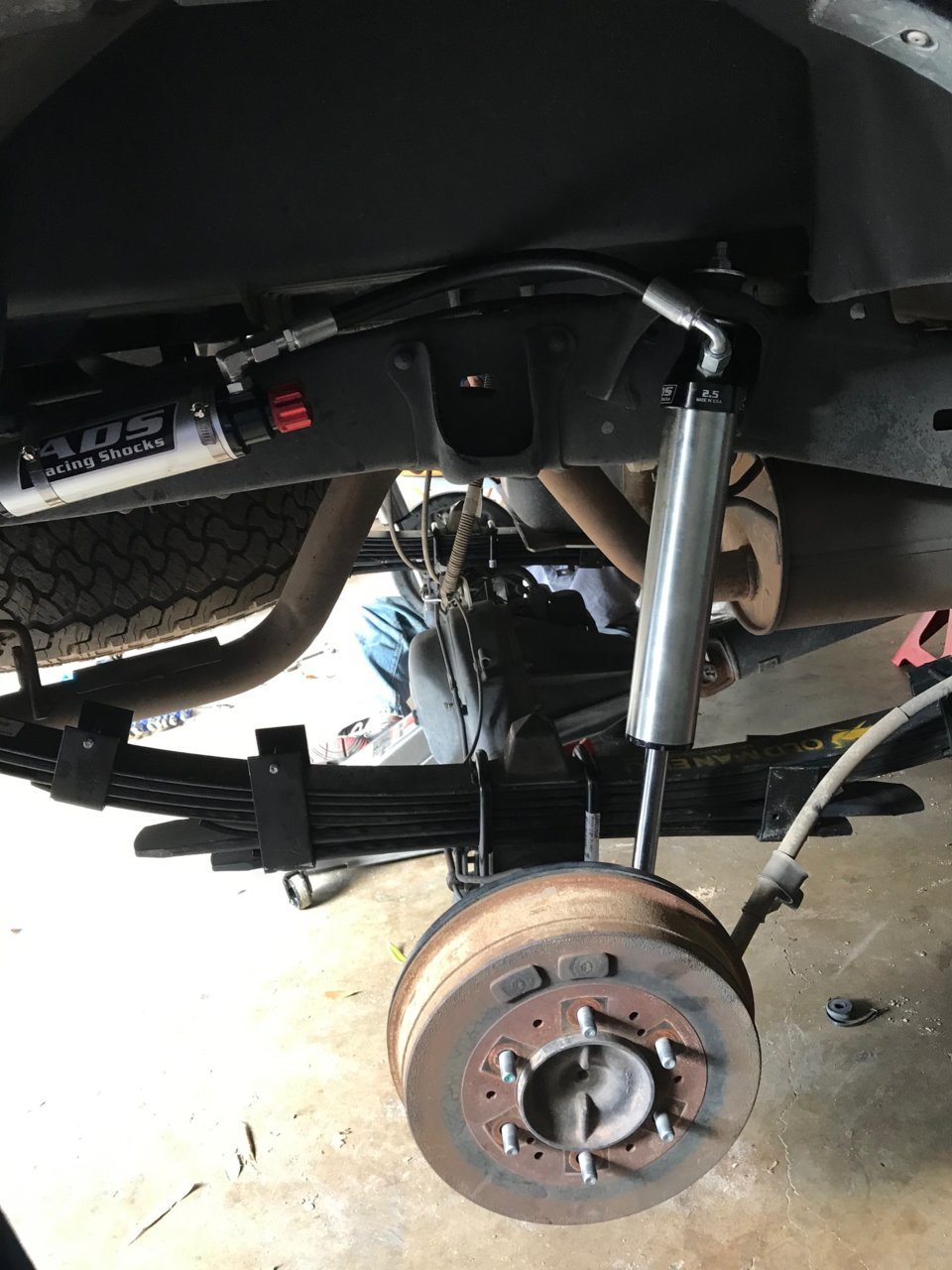

    thanks I got it. Had to beat it to hell. I can’t get the rear shock on. How do I compress it? The oem shock compressed easily. I have ADS 2.5. Any tips?
  4. Nov 23, 2019 at 7:49 PM
    Silverspool
    Silverspool [OP] Come at me Bro!
    Jul 6, 2016
    #191387
    8,271
    Frank
    DFW
    18T4RORP 17GT350
    Anyone seen my wallet?
    Rears? On a truck? Shouldnt need to compress it just lower the axle enough. Assuming u have jack stands on the frame and a jack under the axle?

    I have jack stands on the frame and nothing on the axle. It's an extended travel shock, does that matter?

    Or maybe i'm just a moron. There are 2 rubber bushings that came with the shock. I'm supposed to have one on top and one on bottom right? I had both on bottom.

    The latter? Both on bottom? Here is how I think it should go from top down.
    Nut
    Metal washer
    Rubber washer
    Shock mount
    Rubber washer
    Metal washer
    Shock

    That makes sense to me, mirroring the order.

    sorry meant former one top one bottom

    That sounds right. Rubber washer on each side of the shock mount.

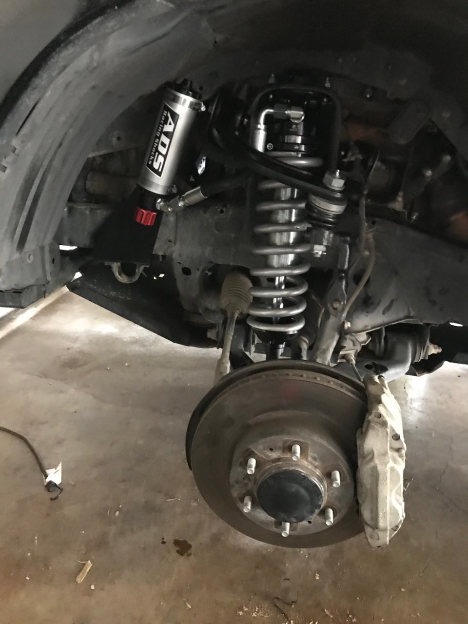

    I got my lift installed. It took literally all weekend and a save from a buddy but it's on the truck.

    Prepare to be underwhelmed! I only netted an inch in the front. Gonna have to crank those coilovers.
