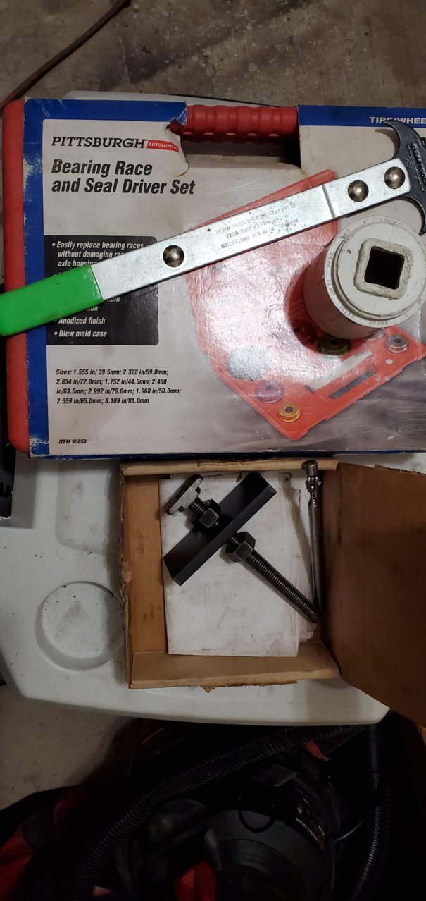

    I've got a whole kit with a magnetic tool to help line up the tool in the diff, seal puller, bushing driver kit and perfect size pvc cap to drive the new seal in without damaging the lip on it.

    That would be awesome if I could borrow it! I can pay you to use it. I won’t be able to do it until winter break so sometime in December.

    No payment required as long as I get it all back. Just let me know when you want to meet up for it.
