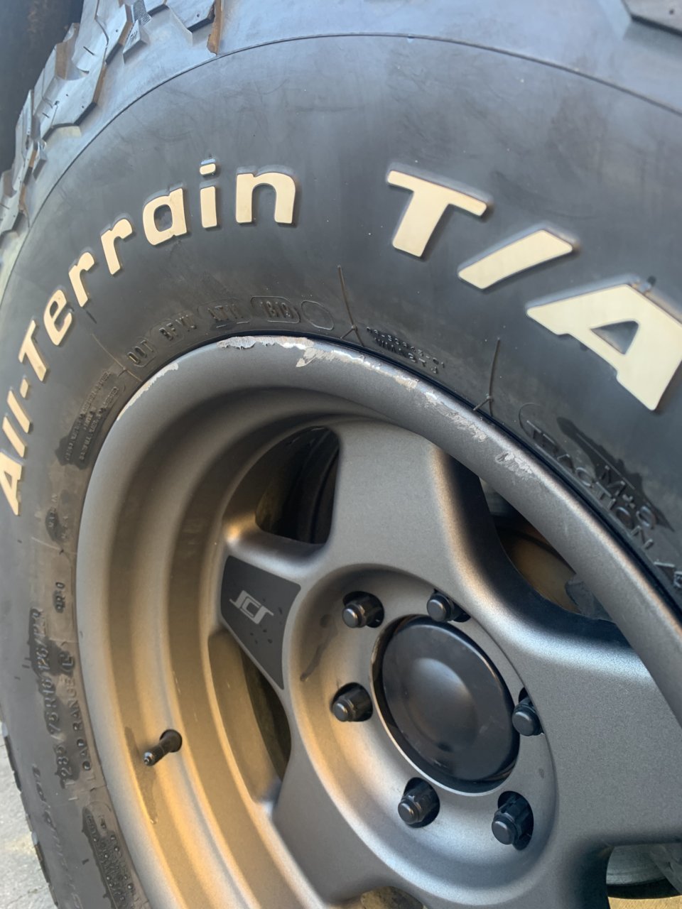

    Well here’s the damage from yesterday, I actually got rash on two wheels but this was the worst. Officially no longer a mall crawler lol. I have a bottle of spray paint I think that will match pretty close.
