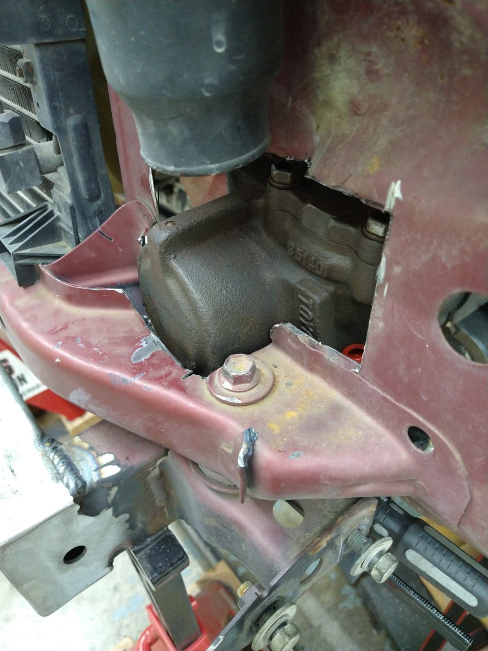

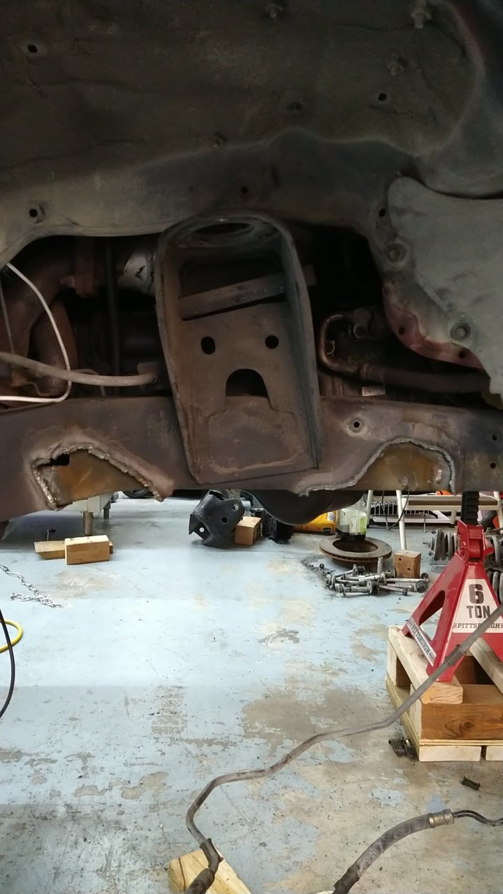

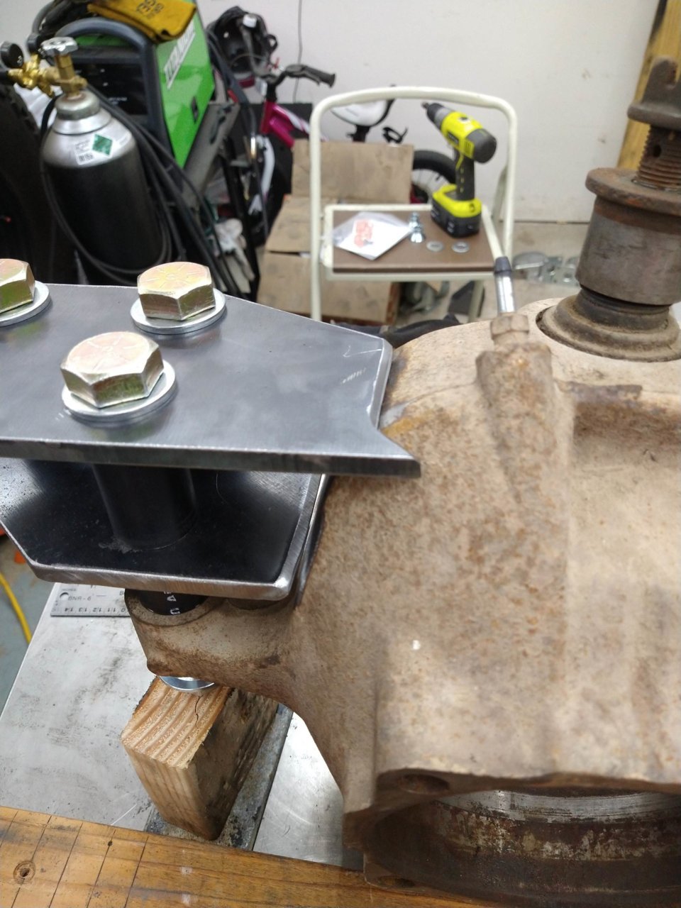

    Awesome, I'll have to start putting things on the calendar when I can. I haven't taken a ton of pictures of the sas, but here's a few of the process.

    Looks good! I dig that bed bob too.

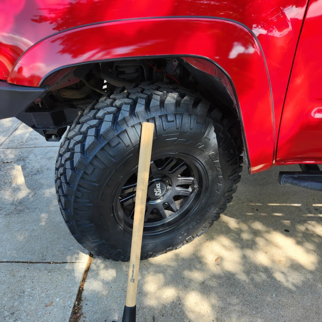

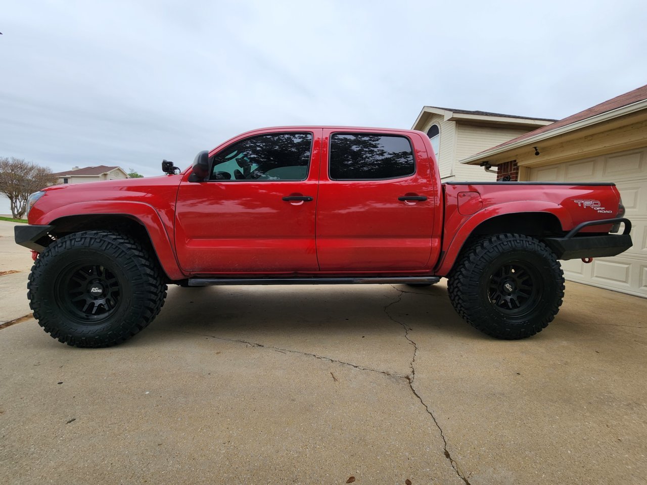

    Officially part of the 35s club!!! :headbang: no rubbing daily driving but definitely going to need a hammer to clear for suspension travel

    No joke for the pinch weld remove the wheel and use a 10 pound sledge, much easier. The cab mount people over think too much, I cut mine and never capped it off. That mount is so stout without it and its easier to clean debris out of

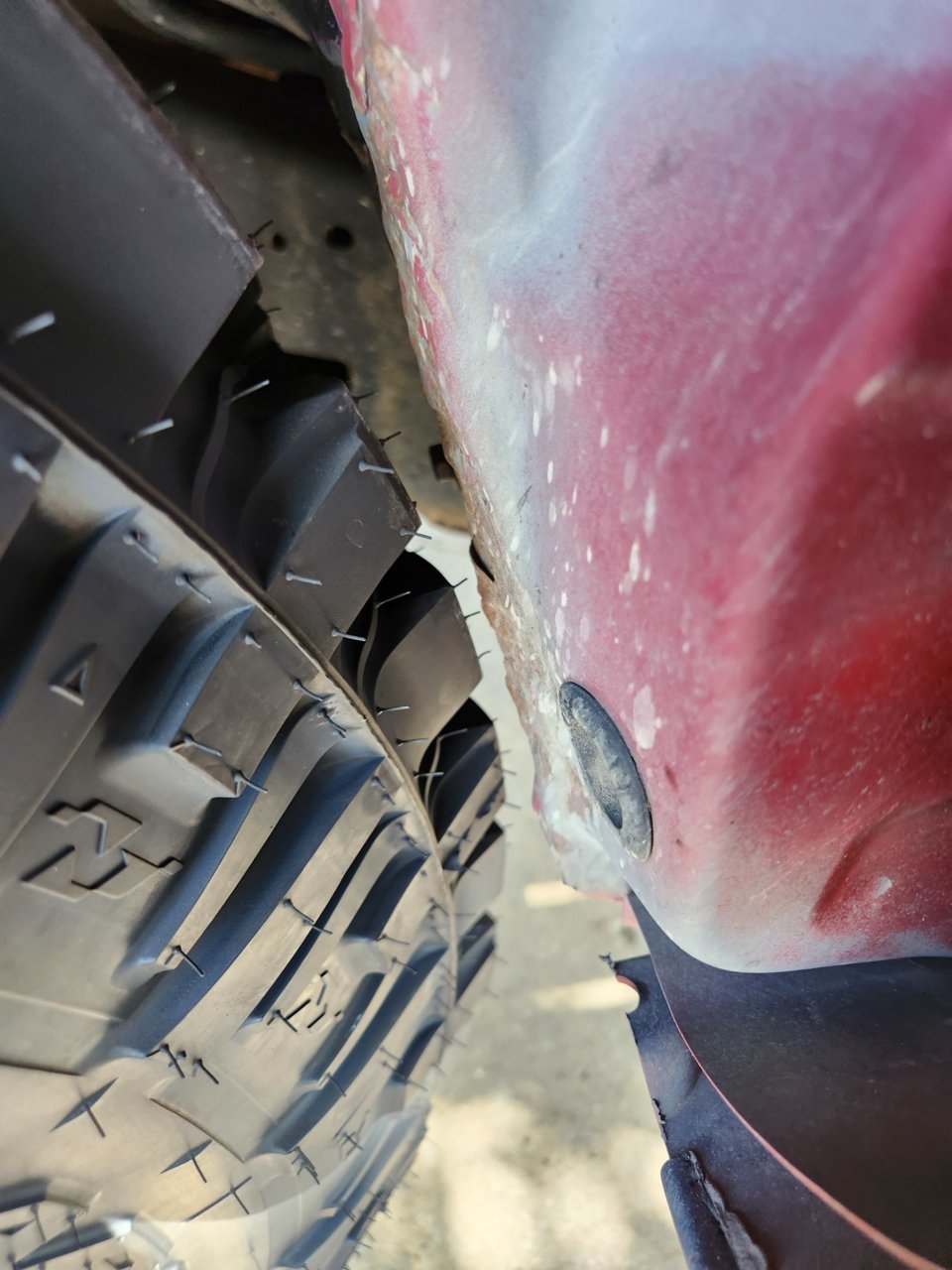

    This is how that fit after I cleared for 295. So no rubbing daily driving so far but definitely need to make room for suspension travel
