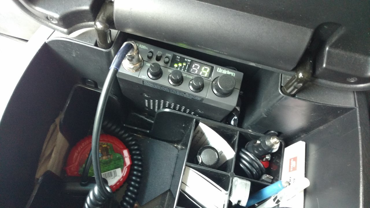

    Do you have to leave the center console open to operate?

    No, I did eventually add a 90 degree adapter because after a year of opening and closing the console lid, the mic cable started shorting out (it would get bent when the lid was closed). I also have an external speaker, because it was hard to hear with the lid closed. No complaints/issues after those two improvements.

    How are you routing the cable out of the console and where did you put your speaker? I wonder if you could run the audio through the stereo?

    I just shut the console with the coiled part of the mic cable hanging out under the lid. It doesn't really pinch it or anything. For the radio wiring, I drilled a hole and cut part of the carpet liner out of the bottom of the console to run the power, antenna cable and wiring for the external speaker under the seat and the PA speaker under the hood. Antenna cable goes under the carpet and through a grommet under the driver seat.
    Edit: I think you could connect the external speaker output to the Aux input of the factory HU and have it play over the truck speakers, but then you couldnt listen to any music when using it.

    Yeah I didn't think about not being able to use them simultaneously, and I could see how that would get annoying quick. But other than that I am going to copy this setup. I hope to get several thing marked off the list before Jambo.

    Not sure it would work, but maybe you could run a splitter and hook up your phone to the second port. Then, the HU is being fed both signals.

    My CB is also in the console. I cut a hole on the front of the center console and put a mic plug-in there. External speaker hangs out in the front cubby.

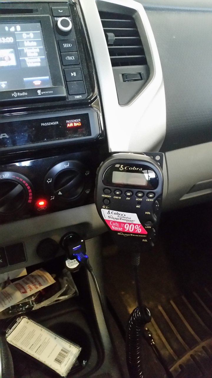

    went with a Cobra 75wsxt, everything is in the hand unit. Panavise mount
