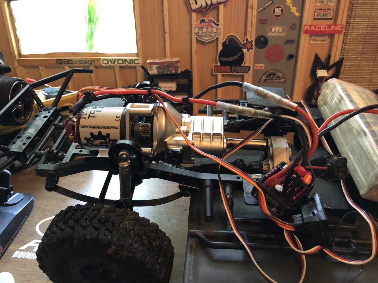

    Ok, new weird thing on the Bomber.... My servo will peter out after a moment of use. It’s a Savox SB2290 that’s pretty much new. I have a Spektrum Rx/tx and the Hobbywing XR10 “Justock” brushless esc/motor combo. If I cycle the servo left and right a few times, it then gets glitchy or just stops working. I switched it over to my crawler, and it works perfectly. I put the crawler Rx on the bomber and the issue persists. The only thing I can think is the esc is acting up. Anybody have a similar experience?

  16. Jun 18, 2020 at 3:44 PM
    #3516
    Silverspool
    Silverspool [OP] Come at me Bro!
    Jul 6, 2016
    #191387
    8,271
    Frank
    DFW
    18T4RORP 17GT350
    Anyone seen my wallet?
    check the BEC settings on the ESC, or see what the voltage output is

    It’s 6v output, non adjustable.

    that servo is pretty serious it may be pulling too many amps, looks like its 6.0 and 7.4 rated but it sounds like youre experiencing brownouts.

    That makes sense why it worked fine on the 1080...
