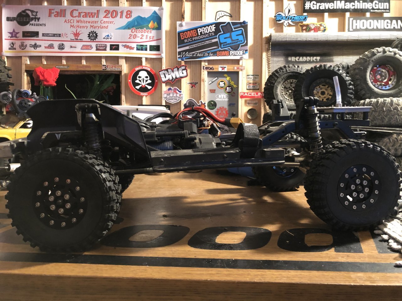

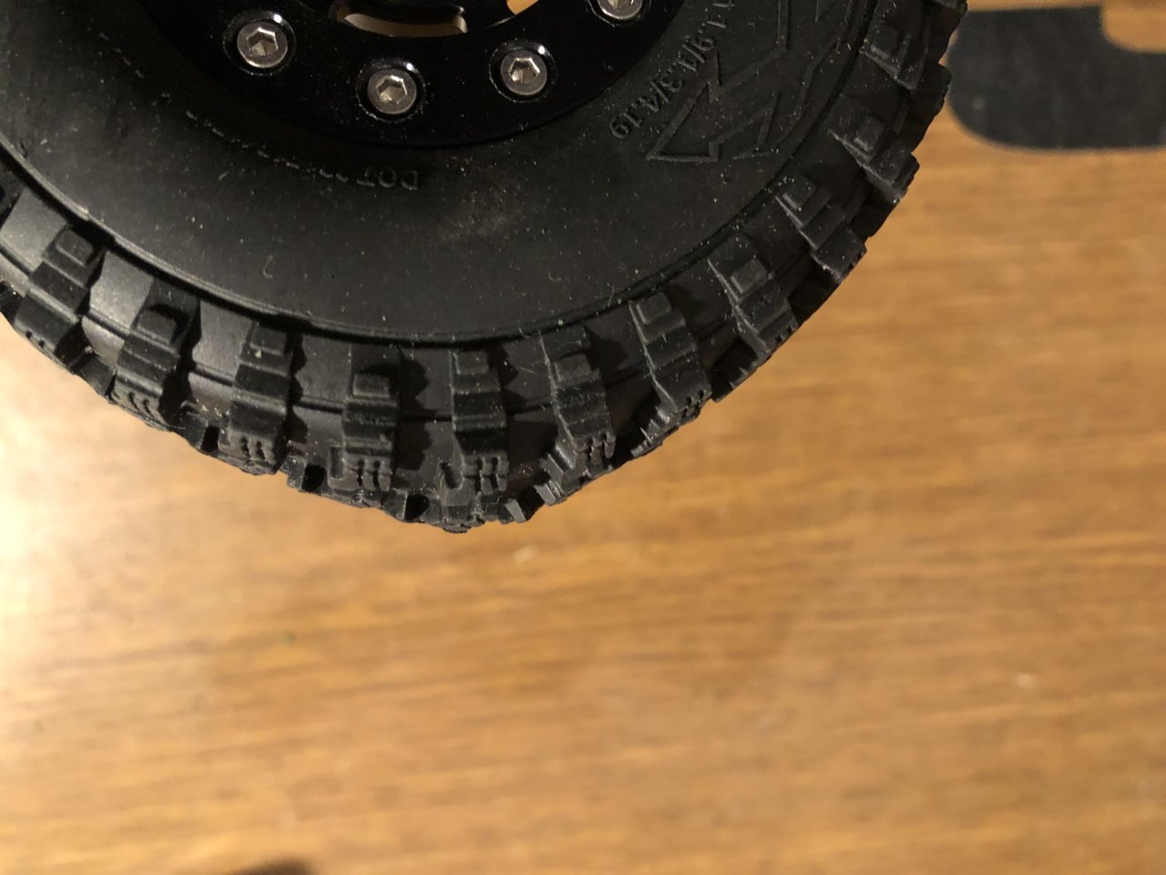

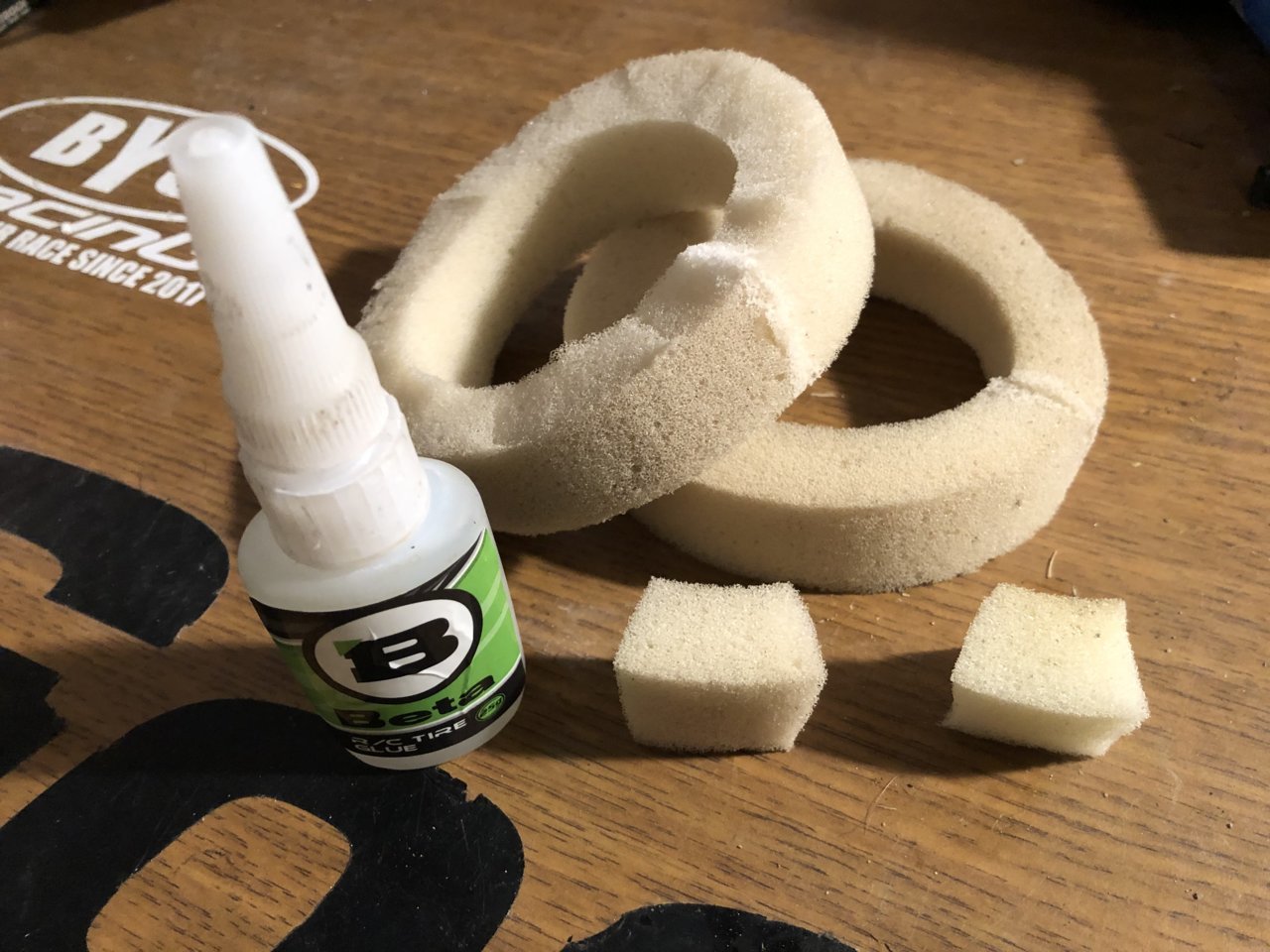

    C1 wheels arrived yesterday, so went ahead and threw the choodoo’s on. Tried a couple diff foam options, first being to trim some open cell foams. Cut them in half width wise, then removed about an inch to decrease OD. Failed due to glue hardening and creating a hard spot and pushing out on the tire. Can’t really tell from pics, but no bueno! Next option, cut some CI closed cell foams. Much better results. Looks to be right at 7.5” track width from center to center of tire, which is right about where the fender width is, so will close on not needing fender flares. Now she’s just waiting on the body to be vandalized and shipped back. Fun rig for sure!

    I wonder how shoe goo or e6000 would work for reconnecting the ends of the foam...

    Not sure. I didn’t have any, or it would have been my first choice. Also could be that I glued the whole surface area, and put a bead of glue down all the seams, when I prob could have gotten away with much less lol

    Word. Probably a dab on each corner of the inner diameter and a light line to lock on the outer diameter. That way it holds, but is still flexible.

    Yeah, it had zero flex lol.

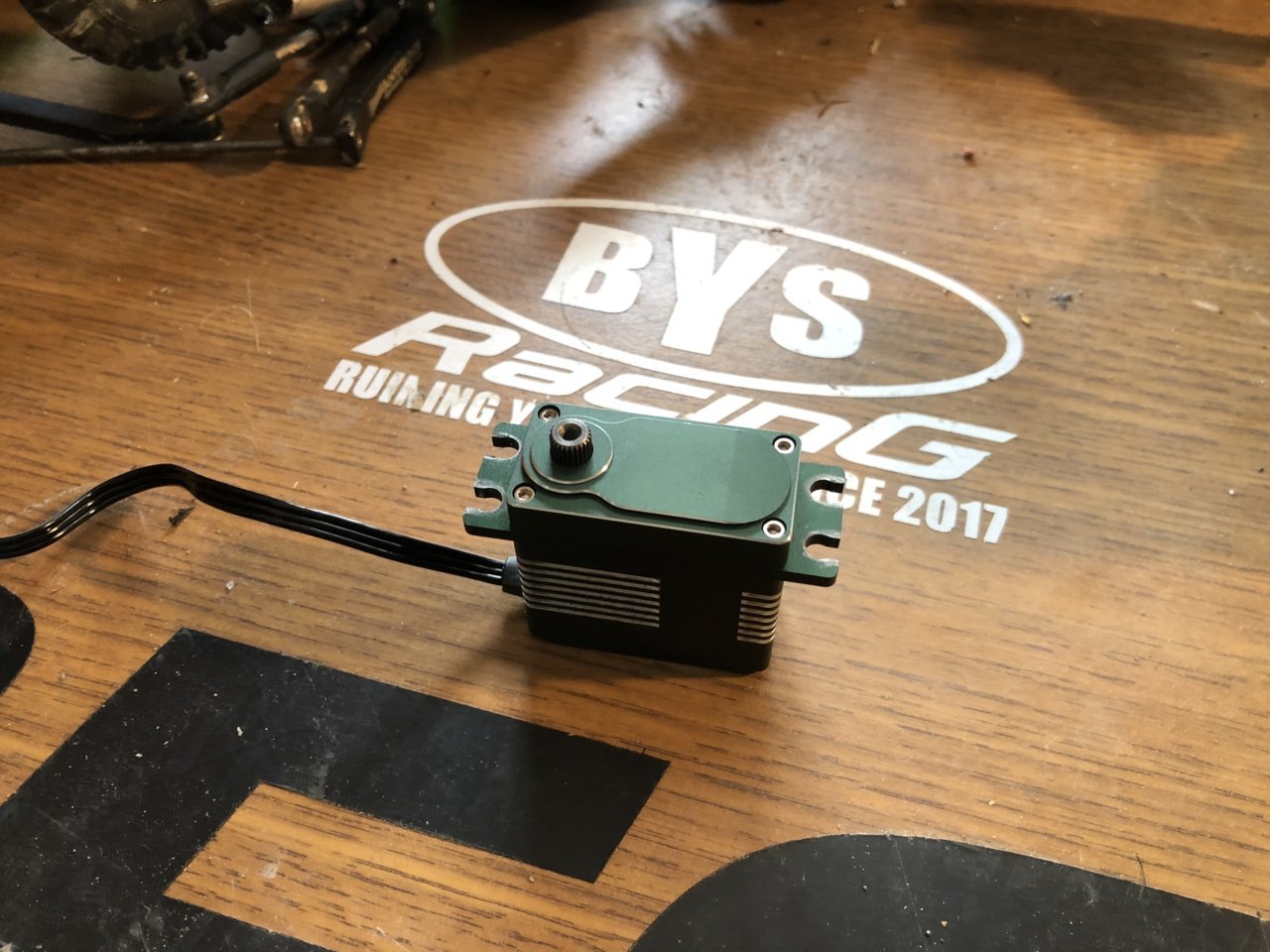

    Sooo, last week I was approached by a company to test a new prototype servo they’re working on. The numbers are comparable to that of a Futaba A700, but but slightly stronger, faster, and around $150 :eek: They’re working on 2 diff models, one powered via rx, the other direct power 4S capable. I got the one powered via rx, and it’s output numbers are superrrr high lol. Supposed to output 5v - 700+, 6v - 900+, 7.4v 1100 +, and 8.4v - 1200+!! I do have a YouTube link showing testing, but it’s a private link. o_O Cost me nothing and I get to beat on it and give my opinion, and when will get a final version when they release, so it seems like a win win! :thumbsup::thumbsup:
