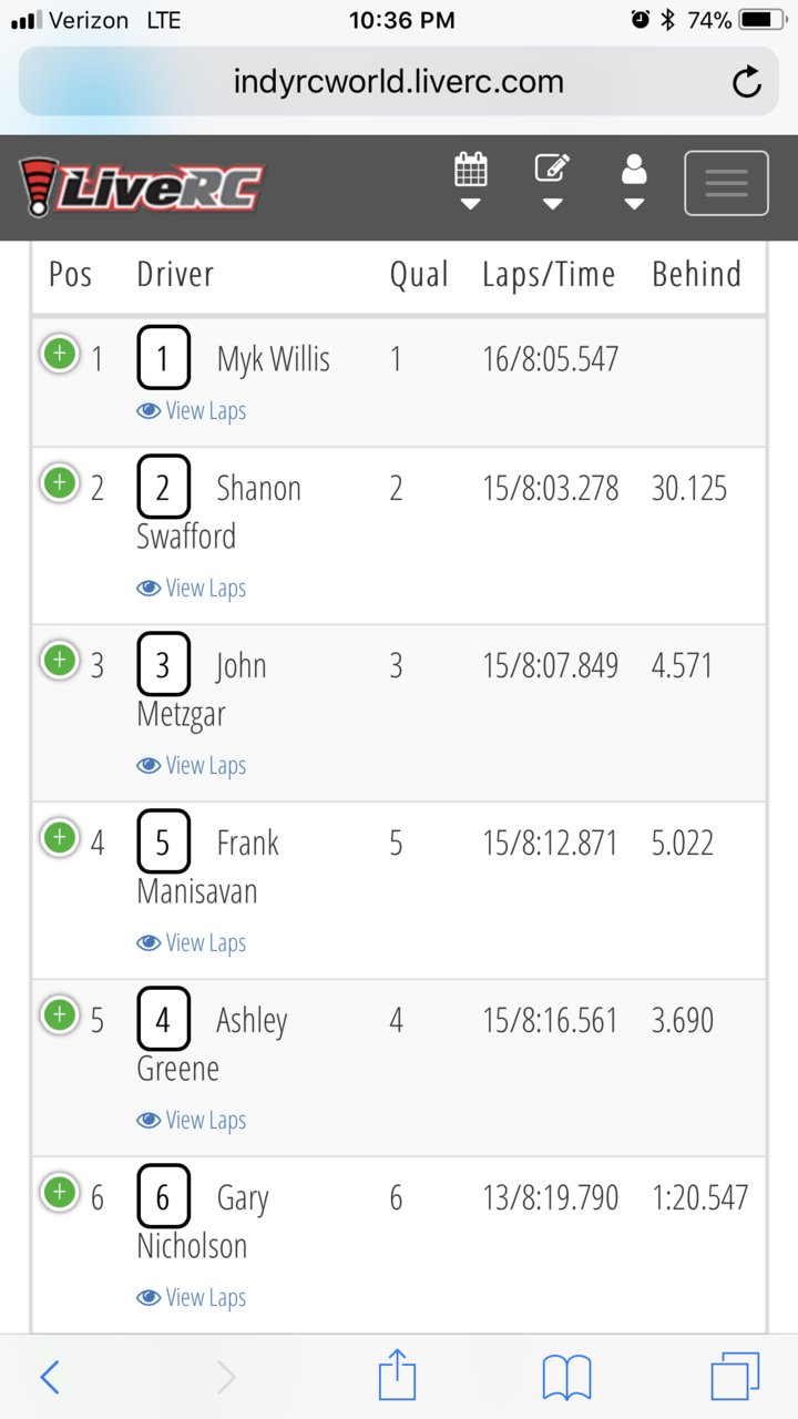

    How did everyone do on race night?

    Myk is killing it. None our wheels fell off during the races that mattered, my new to me truck did well

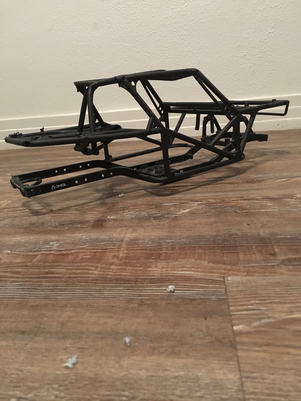

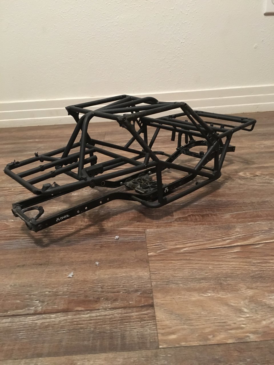

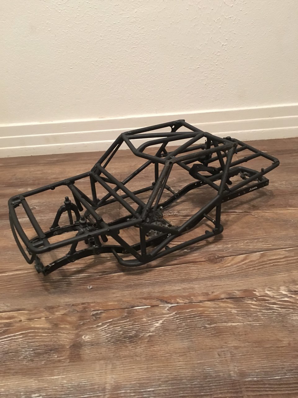

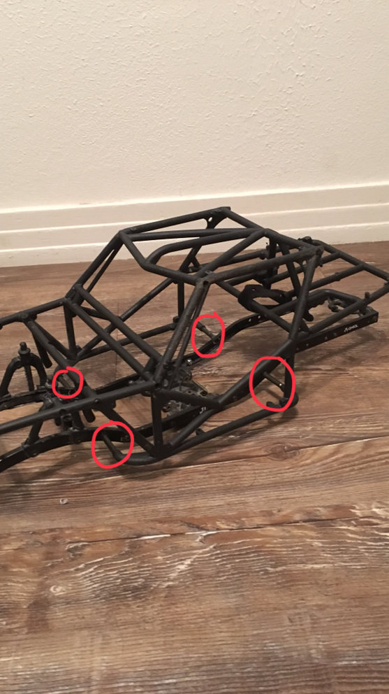

    Well, started on the next step on the crawler. Got a box of leftover random parts from a guy and it included a disassembled wraith chassis, missing a few parts, so instead of spending money on the parts and trying to sell it, decided to start chopping it up and figure out how to get it attached to the scx frame. Ended up drilling new holes in the frame, cutting some brake line to use as a spacer between wraith chassis and scx frame and screwed into some lower chassis rails on the wraith chassis. Prob add a couple more attachment points on the front and rear to make it more rigid, all around. Really like where this is going. Goal is to end up with a trail honcho cab, with full tube cage. At this point, I’m undecided if I want to go bedsides, honcho flat bed, make my own flat bed, or just run the tube rear with frame rails.... There’s still some tube work in the rear I’m not sure if I want to try and utilize or chop them off. Time will tell. (Couple before/after)
