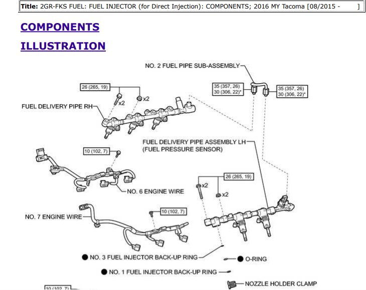

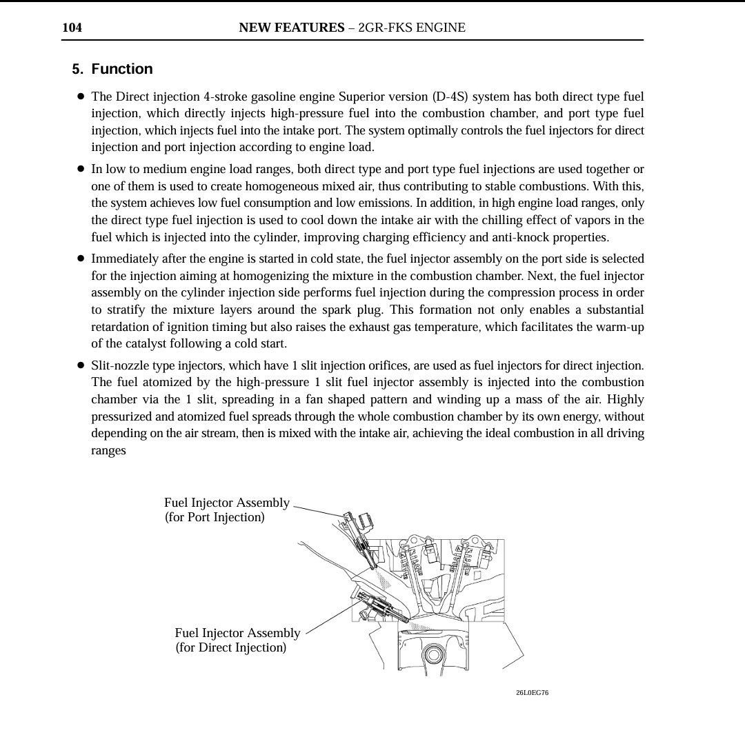

    Here's a page/picture of where the DI lives in relation to Port. Source file attached as well.
    Injectors take a special tool or at least something to get the seal position correct. I have never done these and they look like a pita to do diy in your garage. Make sure you blead down high pressure fuel rail before disassembly. Fuel at 1k+ psi is no bueno.

    If you decide to replace DI injector, you need to take fuel delivery pipe

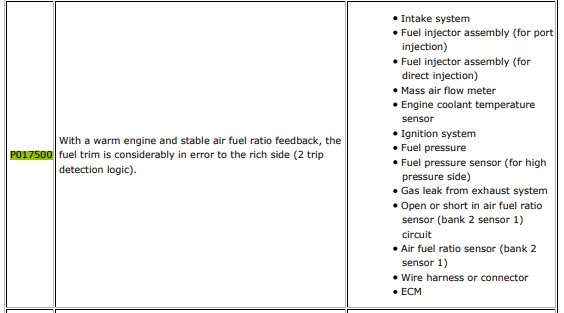

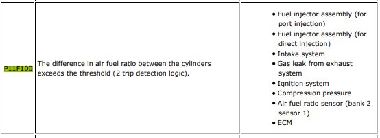

    OP, code P11F1 = Toyota's code P11F100 and referring to Port side
    P017500 Code
    Please note. you have to troubleshoot other codes before P017500.
    So do a proper leakdown test to rule out the burnt valve. What are compression #s from the test you had?
