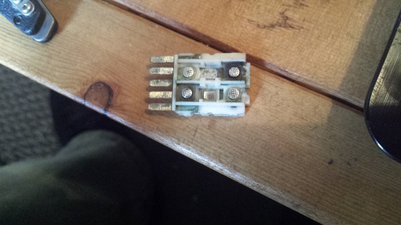

    All windows except rear passenger window worked correctly. Took the panel off and PO had unplugged the switch. Plugged in the switch and still nothing. Took the switch out, took it apart, cleaned the contacts, and reassembled everything (I went ahead and cleaned off the straight plugs as well as the 4 round ones - see picture). Put switch back into the door, plugged it in, and everything is working great now. Definitely worth the 5 mins of time to save me $60.
    98tacoma27 likes this.
