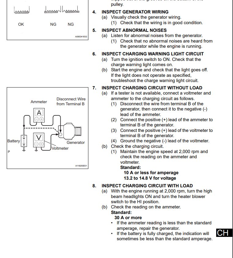

    If going by the book, make sure your ammeter is good for at least 30A. Cheap DMMs are definitely not up to that task. Or use a clamp on, but not everyone has one of those

    Ok, I’m with you fellas.
    Lol, my vote is don’t. As taught to me by a tech with 40 years more experience than I got.
    I think if you got an older vehicle, say with points in the distributor, ok yes. In something more modern, there’s too much that COULD go wrong.
    Seeing how op is asking how, I’m assuming he doesn’t own a multi meter or amp clamp. High beams puts on a good load but, I have a load tester I’ll pull out occasionally.
    Battery testers I don’t really trust. If I use my load tester as a battery tester, it fails everything, new batteries included sometimes.
    I’ve seen many no start, or no crank, or intermittent both which turned out to only need battery terminals and posts brushed clean.
    Lot of the techs I work with will just stick in a new battery. I prefer to be honest, test, clean, retest, then let them decide after giving my opinion. It’s 4 years 6 months old, testing passed but I think it should still be replaced because it’s old. It’s 2 years old, only needed cleaning, testing good, doesn’t need replacing.
