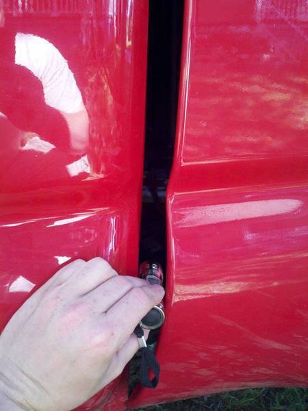

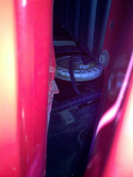

    I got some more gas in my gas jug and brought it home, to see where this fuel was leaking when the gas tank was full. I was previously just looking at the top of the tank from above the tire, up under the rear fender well. After filling the tank completely full, I could see gas puddling towards the front of the fuel pump lid, but the back area was dry. I of course checked the hoses and inlets first, and I can see all 3 of these, the main inlet, the canister inlet and return line on the left side close to the frame rail. They all have red cap pieces the hoses attach to. None of them were leaking, but there was a lot of fuel in the front of the fuel pump cap, lid thing...the big white gear looking thing in the close up pic.
    I wanted a better look, and as i was crawling under the truck more toward the front, I noticed that I could actually see the top of the tank pretty good from between the cab and bed. I'm probably just slow and/or forgetful, but its a good vantage point, so I thought I'd share it and my findings today.
    Also, I was thinking of the vacuum lines only because mine popped the P0441 Check Engine Light Code, but from what I've read elsewhere, it should be physically impossible for the vacuum lines to carry this much solid fuel.
    Thus as the Great Detective Holmes stated, when you have alleviated all the probable causes, whatever is left, however improbable, must be the truth: Vis a Vis: There must be a problem with the tank or main fuel hoses themselves, causing the EVAP system to lose pressure and not complete the vacuum seal.
    Thanks to JonW for mentioning the fuel pump gasket in the first place, looks like that's the culprit.

    Not yet. Gonna wait till I'm at my Uncle's garage, prob some time around the 4th, with multiple vehicles in case something needs to be went and bought, lol.
    But it's definitely the fuel pump retainer ring, from the proper angle I can see where it is actually cracked and separating in the front area!

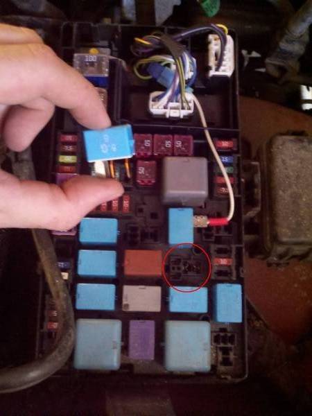

    (1) First remove the Gas Cap.
    (2) Then disconnect the Fuel Pump Relay inside the Fuse/Relay box Under the Hood.
    (3) Next Start your Engine and let it run until it dies. It may not start at all, but mine did crank up and run for just a few seconds then died just like the manual said.

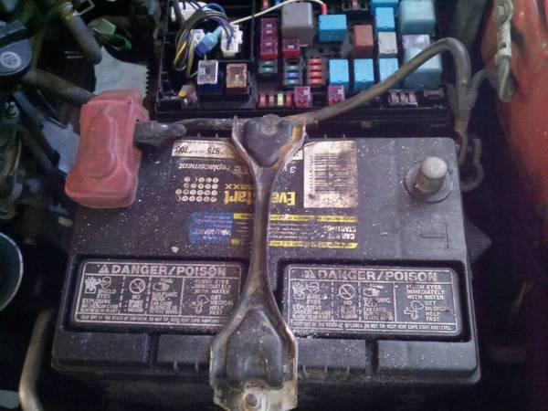

    Disconnect the Negative Terminal of your Battery
    Now that the Fuel System is Purged and the Electrical System disconnected we can start removing the fuel tank.

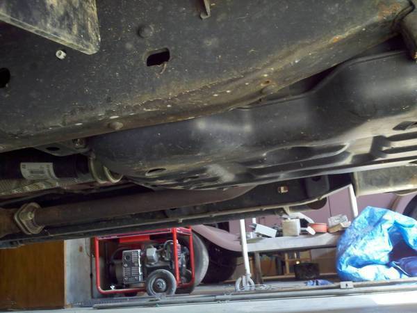

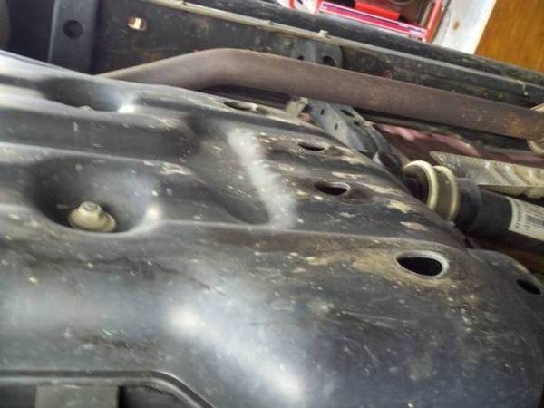

    Here is your gas tank rock guard cover. Behind it lies the gas tank...
    It is held in place by only 4 nuts and is easily removed since it is lightweight but endurable plastic.

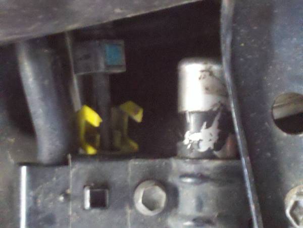

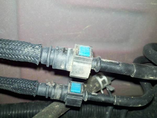

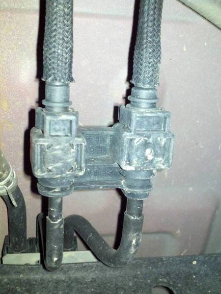

    This is your Fuel Lines Quick Disconnects Cover Plate
    Located just above and in front of your fuel tank.
    Snap this off so you can get to the quick disconnect tabs.

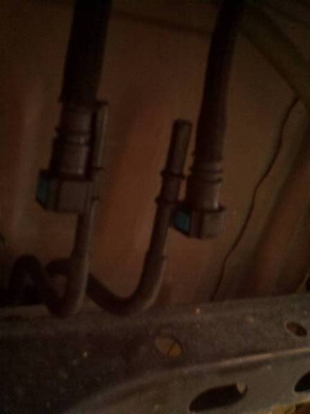

    Depress the Blue Tabs on each side of the lines and PULL
    Leaving you with fuel lines like this. This is where I leaked good amount of Fuel. Have a bucket or suitable container ready to catch any fuel that runs out of the fuel lines. This seems to be the fuel that was trapped in the line forward of your tank, between the tank and the engine.

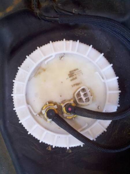

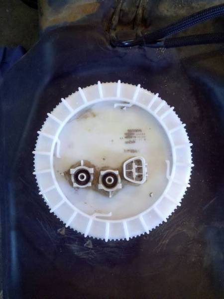

    Slide the tank out from underneath the truck and begin removing the fuel pump retainer ring by disconnecting the fuel lines like so:
    Remove these fuel lines by sliding/un-snapping the yellow holding clamps then pull up on the fuel lines to disconnect.
    The blank hole is where the Electrical Connector that hangs on the frame of the truck was Disconnected.

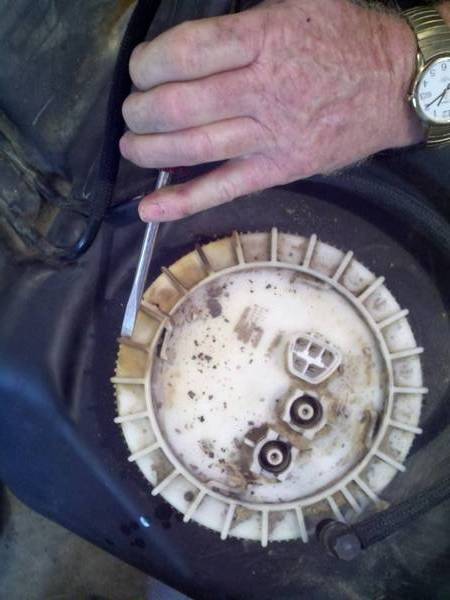

    My Retainer Ring was already cracked so we used a hammer and screwdriver to start to unloosen the ring. The little curly brackets are what keeps it from loosening and make it hard to take off. Just press in on the each curly tab as it approaches a stop and keep going around the ring and pressing in each tab in succession as you loosen the ring and eventually while one person presses down on the spring loaded pump the ring will unscrew the rest of the way off. (No Special Tool Required)
    My Uncle held the pump down and in place once the Ring was off so that I could clean off all the dirt and debris from the top of the fuel pump, so no dirt or dust would fall into the tank once the pump was allowed to spring up.
    Once it was relatively clean, we eased it up and replaced the fuel pump gasket while we were into it.
    Then I replaced the Fuel Pump Retainer Ring with the New one.
