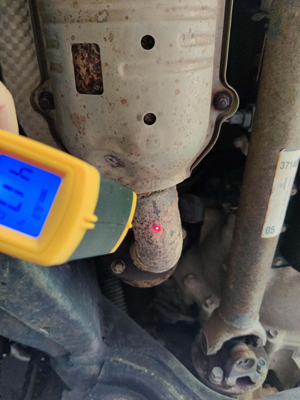

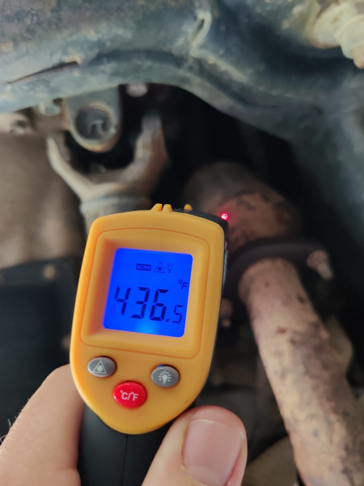

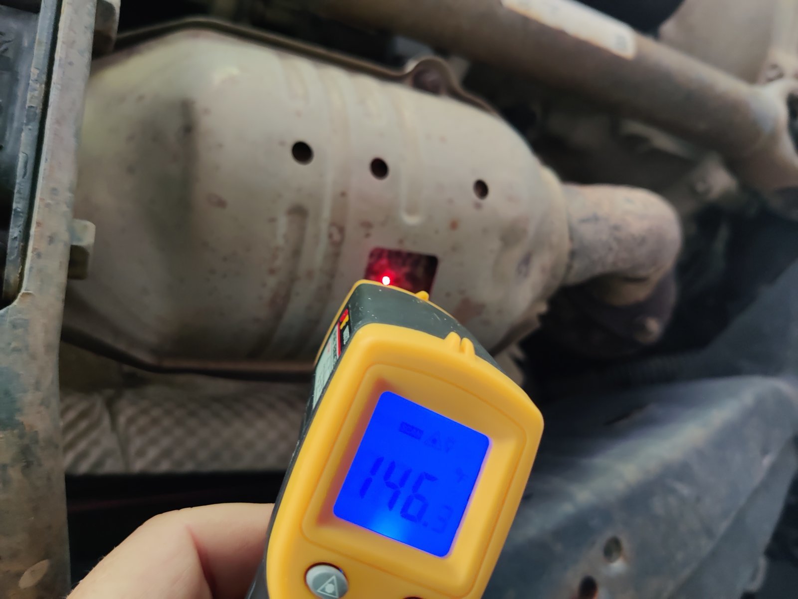

    I checked the temp of the cats with my laser front cats are 400ish° tube between cats 260\243 2nd cats\resonators 390 Driver & 270 Pass. Exhaust pipe to tail is about 176 after a 30 min drive.
    Both dealers tell me the cats would definitely throw a code so all is fine. One said the cats are good because they should get to 1700°. They were unable to tell me how long it would take for them to get to this temperature. So in my opinion that has verified nothing. However in total I made an hour-long drive at 55 mph this morning without any rain, and was able to get the floors noticeably wet and hot.

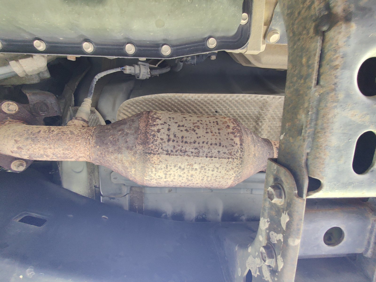

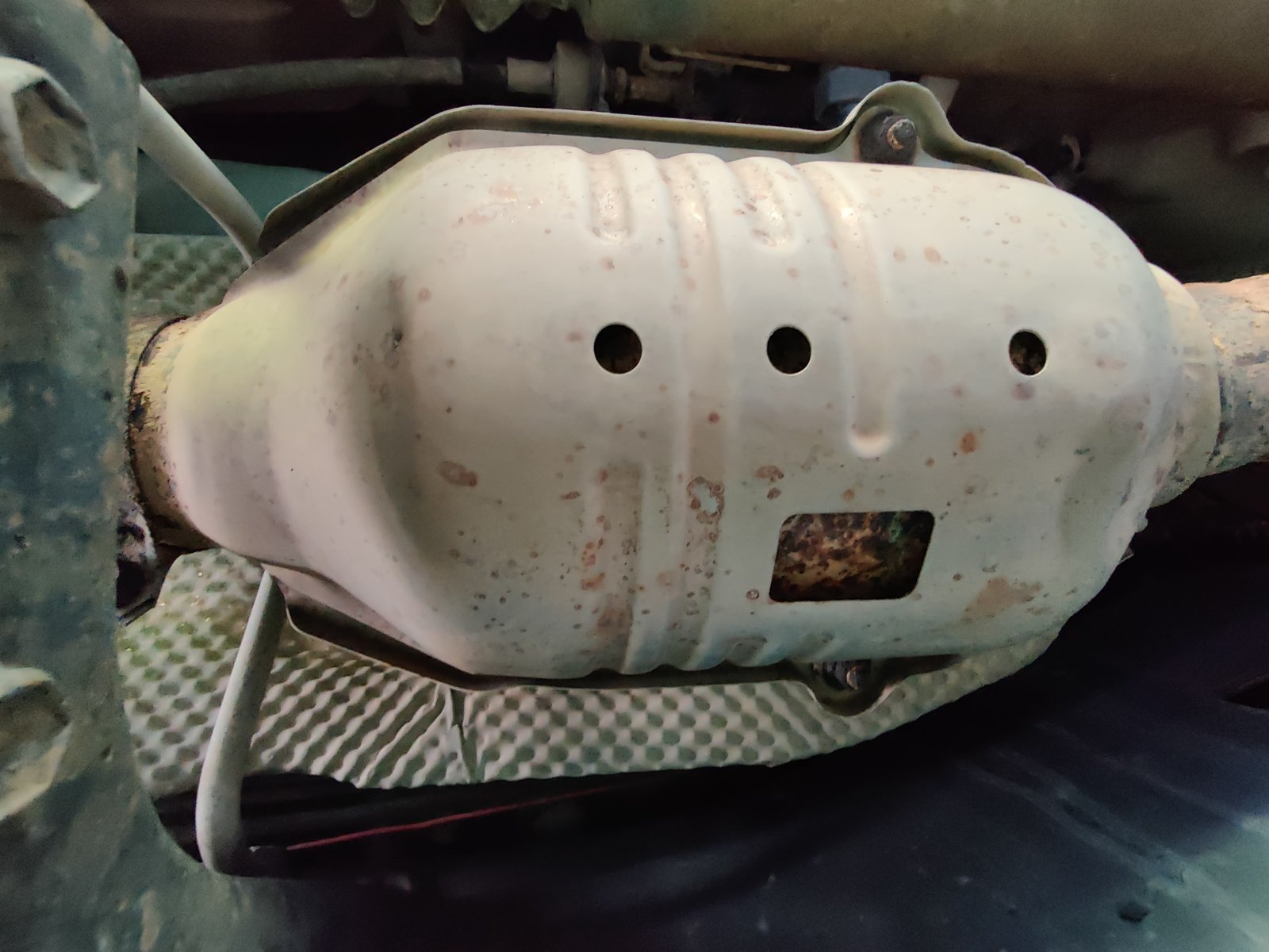

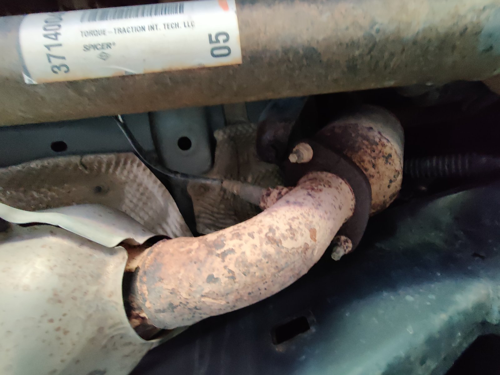

    Some random pictures of the underside of the truck to show that it's in pretty good condition. Also the wetness and heat are on both sides it is not on just one side of the truck. This is just the front two seats. The rear floorboard and carpet is completely dry and cool to the touch.

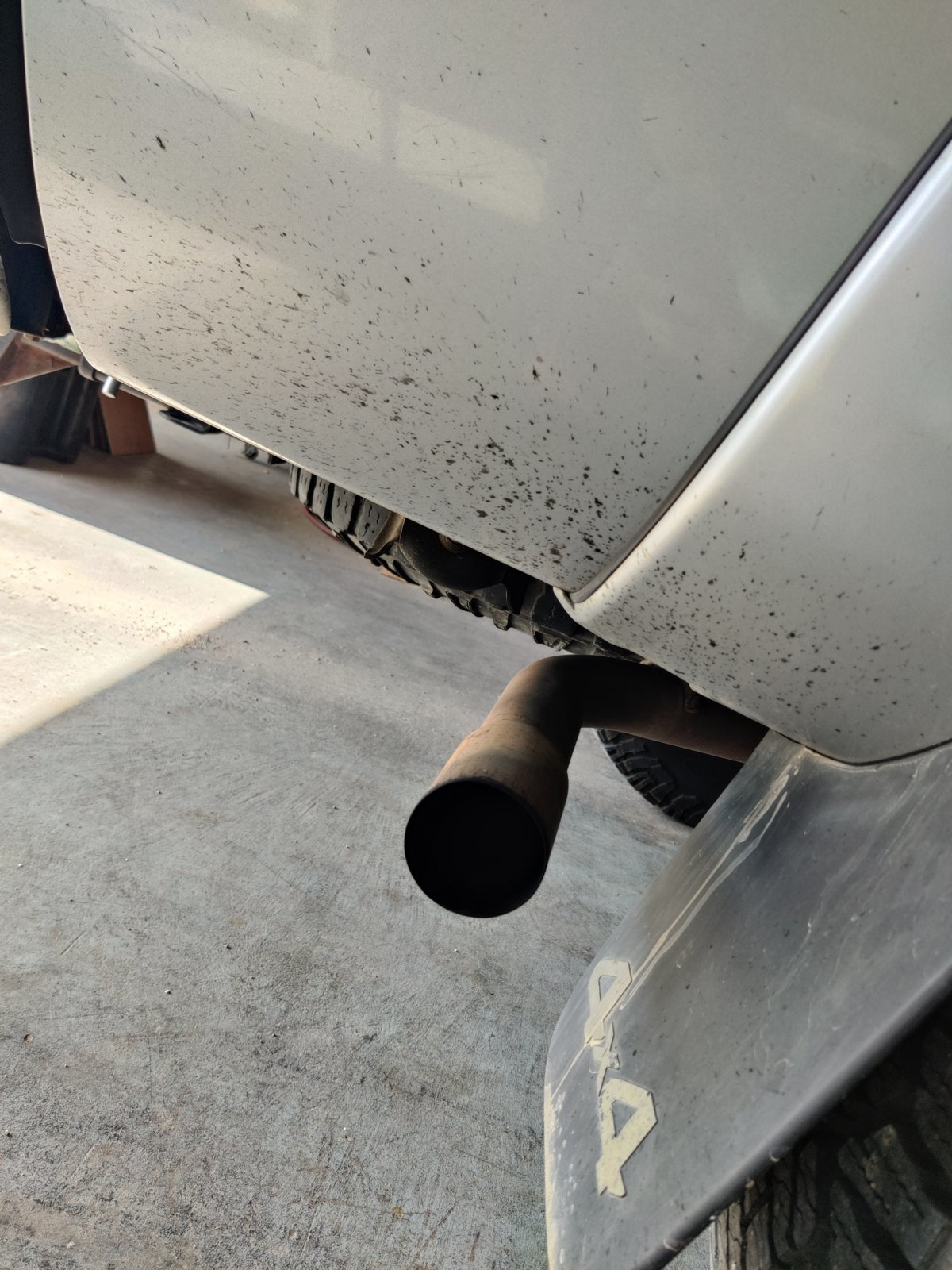

    If you're getting soot on your rear quarter, you're definitely running INCREDIBLY rich and that's why the cats are screaming hot

    The soot.

    Somehow a ton of extra/unburnt fuel and air is getting sent through the exhaust, and trying to your cat into a rocket engine. That's why it's spewing soot
    That issue in conjunction with lots of moisture leads me to brainstorm maybe a leak caused some wiring or ECU to get wet and start acting crazy without throwing codes?

    1st cat
    Between cats
    Secondary cat

    In my experience (along with what I've read across many forum posts) the taco cats are very robust, far more efficient and effective than decades past. It takes a lot to run dirty enough to notice to spit soot out the tailpipe. like it should be throwing 10 different codes.
    Looking at your temp gun readings though...they don't seem crazy to me? I could be wrong on that.

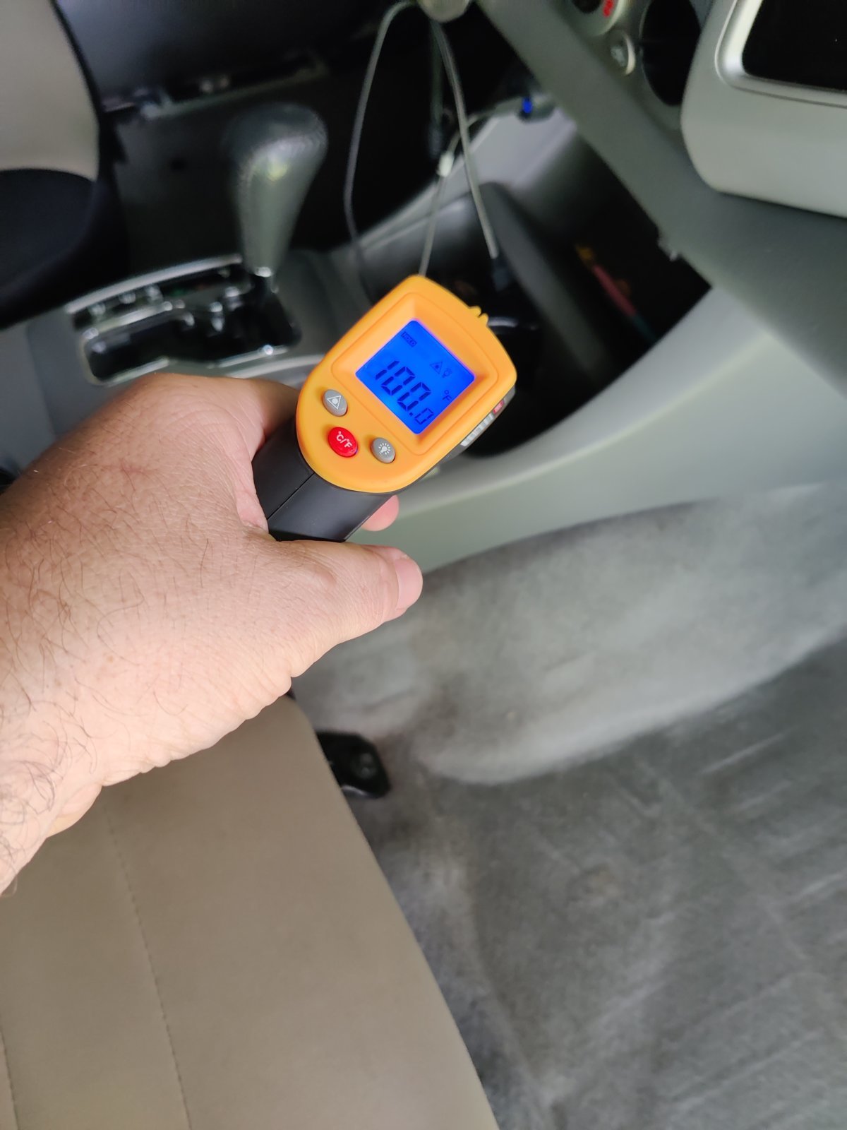

    I'm actually starting to think that I'm too close to the problem. My scan gauge does not have a transmission temperature reading so other than a physical laser I don't have a way to read it. I agree with you though those temperature numbers don't look crazy high to me. But I'm also not very familiar with this. Even the soot at the back of the truck doesn't really concern me that much because my truck does stay parked for about 2 weeks while I'm at work, that little bit that is shown in the picture it's probably months worth of build up. I'm just not sold on any of my speculation.
    I also just checked and my radiator is full.
    The truck doesn't feel like it runs horrible I just don't understand what else could be generating that kind of heat through my floor. Literally if I put any drinks in the cup holders they will become like hot chocolate. The cup holders are 106° as are the floors.

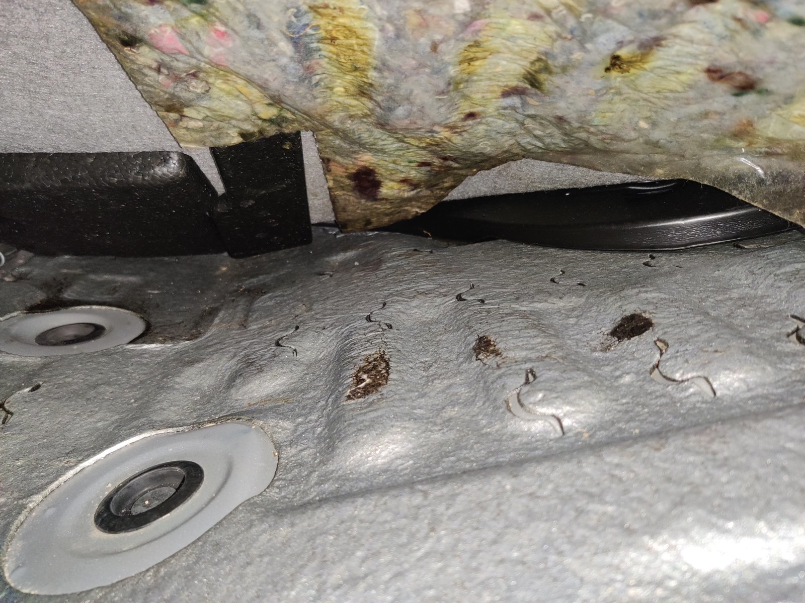

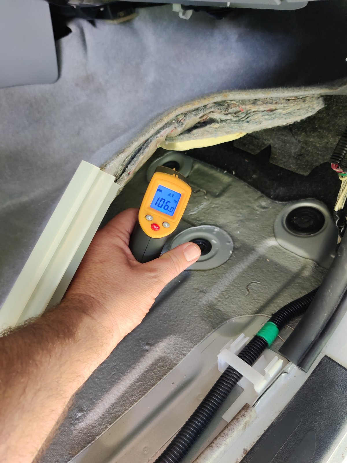

    This was taken after the truck was idling maybe 15 minutes in my carport.
    Now how hot is your floor normally I really don't know but I can tell you my back floor is only 92°. But I expect that to be cooler because they're less things acting upon it. I think I'm just driving myself crazy.

    Well if it's just idling there, theres no airflow running over the underside taking that heat away. And even in motion there really isn't much for thermal insulation, so seeing a 100+ degree sheet metal floor pan that's inches away from giant heat producers isn't really that bonkers.
    Not to mention, these trucks have no valve on the heater core, so it's always got full-temp coolant running through it radiating more heat especially between the center console and trans tunnel. I've actually thought about insulating/designing a peltier cooler for the cupholders lol
    Starting to think you may just have a leakage issue somewhere and got pulled down a rabbit hole with the warm floors lol.
    seeing your temp readings and lack of emissions codes, I'd assume they're unrelated and chase down the source of the moisture first and go from there. Cause like I said, the water is coming from somewhere, since warm floors would only deter condensation/wet carpets. Give it a sniff test, does it smell like coolant?
    If the windscreen has ever been replaced, that's a likely culprit too. Huge possibility of a bad seal.
