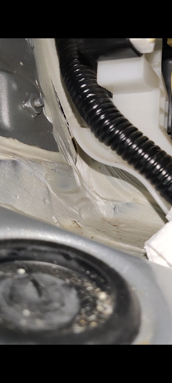

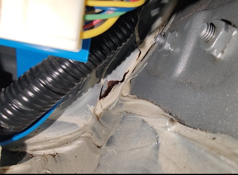

    Driver's side, this one goes pretty high up and was a bitch.
    Passenger side, that's the entirety of the crack. Easy enough.
    After sealing both of these I ran 8 oz on each side of the cowl then an additional gallon per side to verify it worked.
    I'd still like to mold something that eliminated water from draining freely inside that fender. I don't see why the dealership doesn't do that and run the hose directly to the bottom just like they do with the AC drain. That would alleviate all of these issues.
