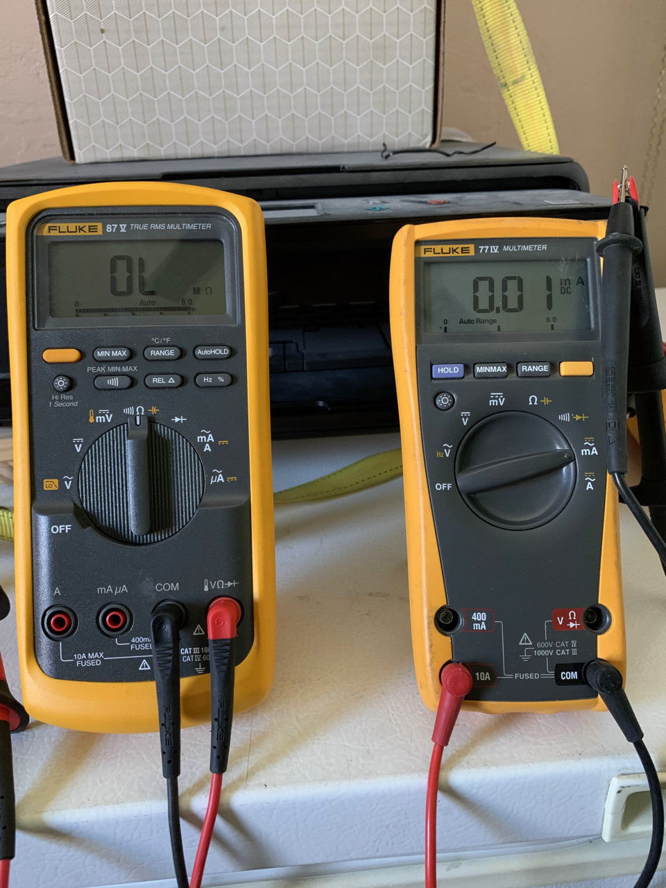

    I tried back at just getting a current reading with a different new Fluke 87 and 77. I am still not getting any current reading. Can you tell me if these are the right settings? This is through the positive - it is the same with the negative side.

    So your red lead looks wrong. You've got them in the 10A hole, needs to be one to the right to get mA

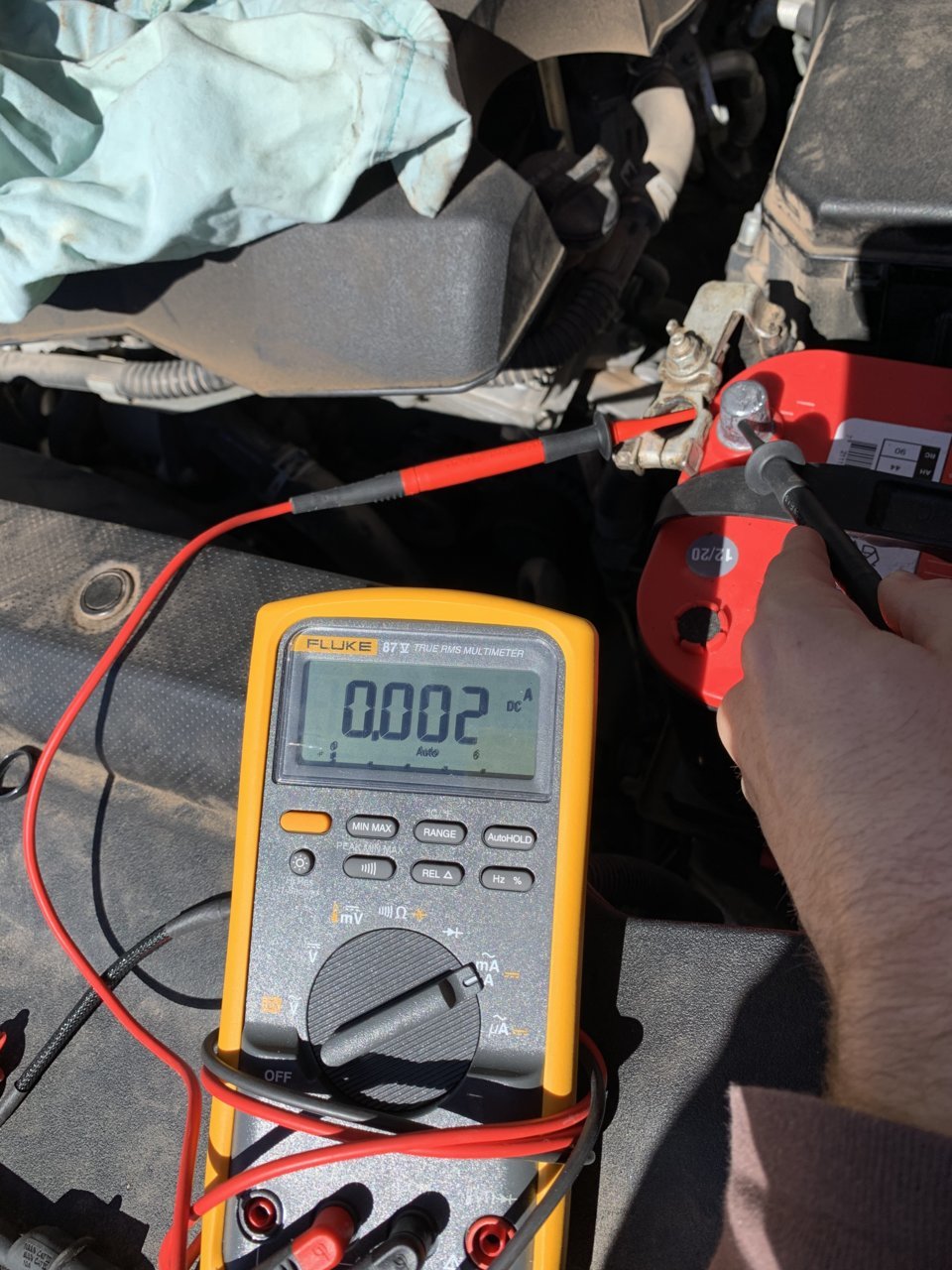

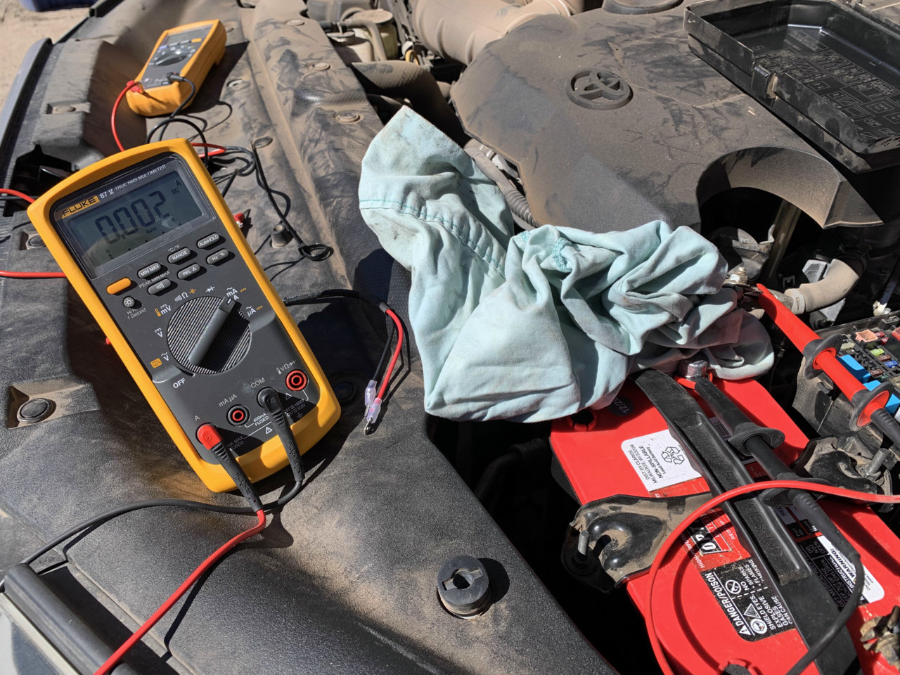

    Here is what I get. The same as just reading the air around me
  5. Feb 7, 2021 at 11:45 AM
    #45
    0xDEADBEEF
    Mar 2, 2019
    #285037
    19,658
    2000 reg cab 4x4 flatbed MT
    Are the connections to those terminals nice and clean?

    I'd say so. I can maybe clean the cable a little more. The strange thing is when I clamp the alligator clamps between the battery and the cable, that connection works (allows me to lock and unlock the car). So should be clean enough for the DMMs

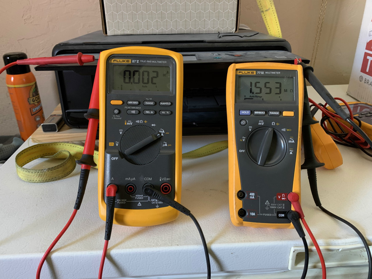

    So since you have a bunch of meters, here's what I would do.
    1) Set one of them to read Resistance (ohms)
    2) Set the one you want to read your current with to DC mA
    3) Connect their leads together.
    You should see something low on the Resistance meter - 3 ohms or so, which is generally teh contact resistance of the probes. On the meter set to read current, you should see a little tiny bit of activity - less than 1 mA.
    If thats true, then your current meter is good and its time to call an exorcist.

    I agree, that's why I am so confused
    like this?

    Looks like your 10A fuse is blown on the left meter.
    Move the red lead on the left meter to the mA/uA plug and see what that one says about the 400mA fuse.

    Same thing - just with the decimal moved over one spot. I guess it's blown too? I'm going to try the 77 see if that one is working

    Yep, the big M next to the Omega (aka horseshoe), means Mega, which is 1,000,000 ohms. So you've got 1,553,000ish ohms of resistance, aka an open circuit.
