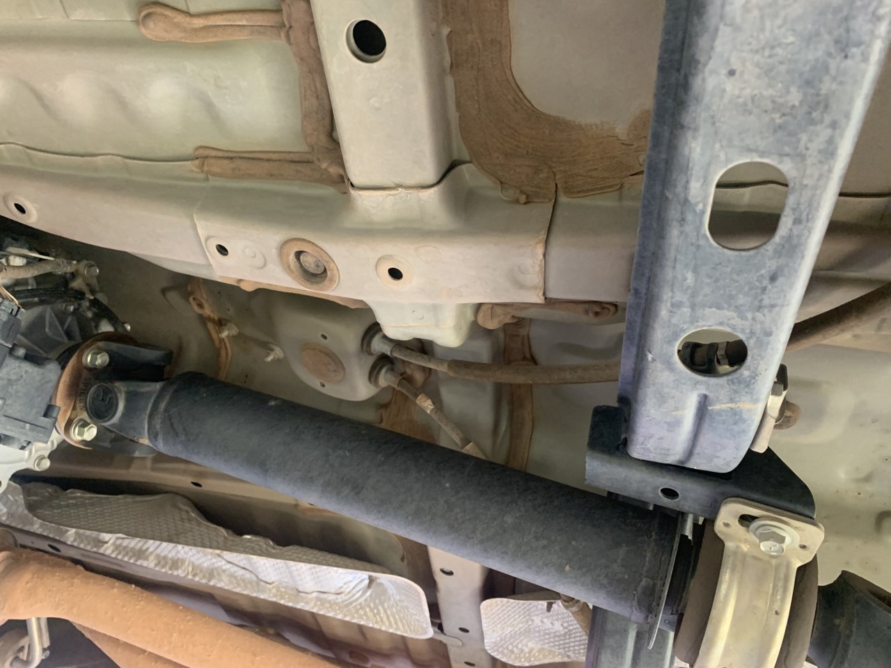

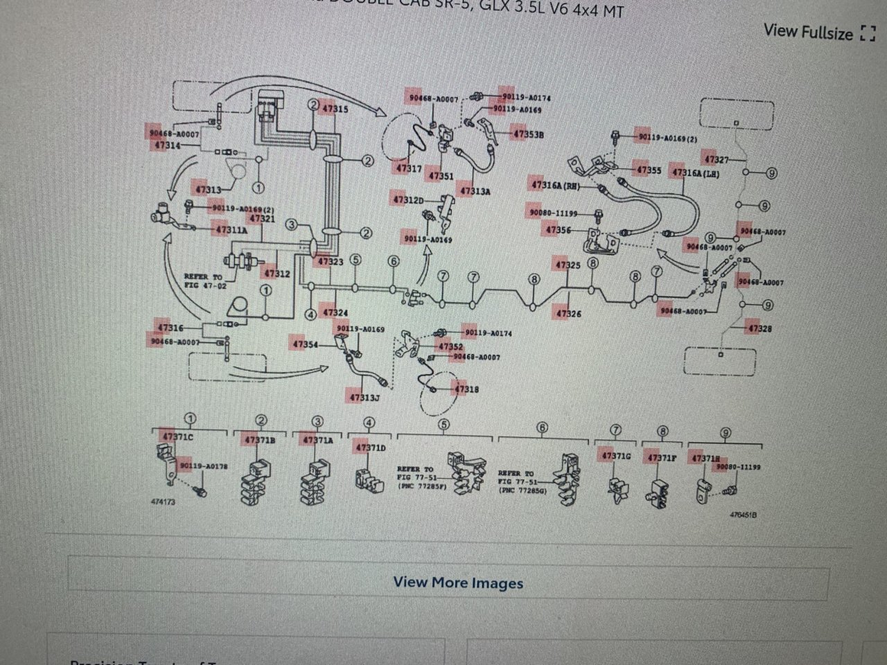

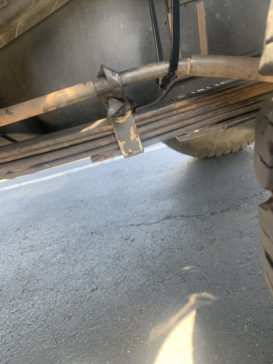

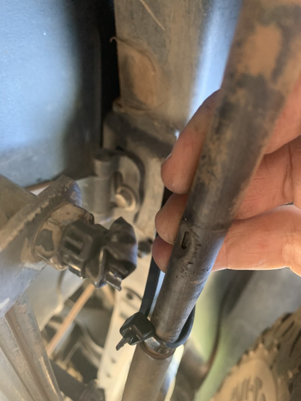

    Hey Guys, looks like I’m a dumbass and when the rear leafs went on the bolt went in on the opposite side which I didn’t notice was an issue till the threads started to eat into the hose next to it. Lifted it with a tie and wrapped it for the moment to avoid more damage but won’t be driving it until I get the part. Been looking to fix it today but can’t find the correct part to order on any of the diagrams. Any help is much appreciated as I can’t figure out my ass from my head on this dam thing.

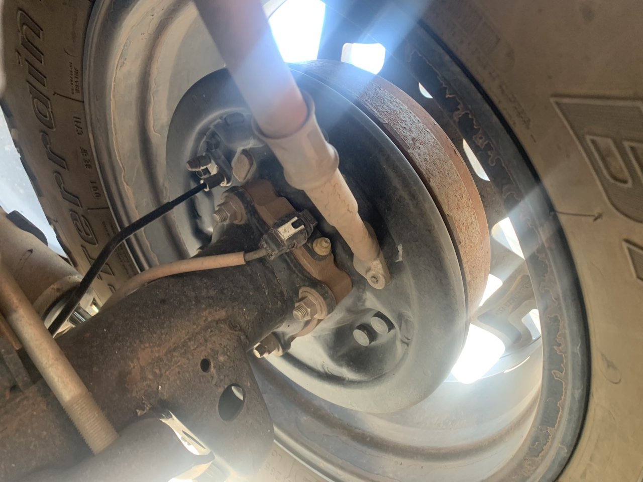

    Is the one zipped up in the first pic the bottom one in the 2nd pic? Is that the conduit for the ABS sensor?
    What about the black line in pic 2? Looks like the brake fluid hard line and in the pic looks like it's rubbing the bottom of the shock body?

    I think I’m looking at the wrong diagram. It’s the hose hanging with the tie on the first car picture And the furthest right on the car 2nd picture. It’s the parking brake right? Orange would by electronics, black is braking fluid.

    *I* wouldn't bother replacing that. I'd clean it, put a dab of silicone to make it weathertight, then wrap for mechanical protection.
    You could use a piece of hose, spilt and zip tied on. You could also cut up an aluminum soda can (regular scissors will work) and attach it the same way.

    You need to be looking in the parking brake diagram I think. The diagram you have in the first post is the brake line diagram

    that's the emergency brake cable
